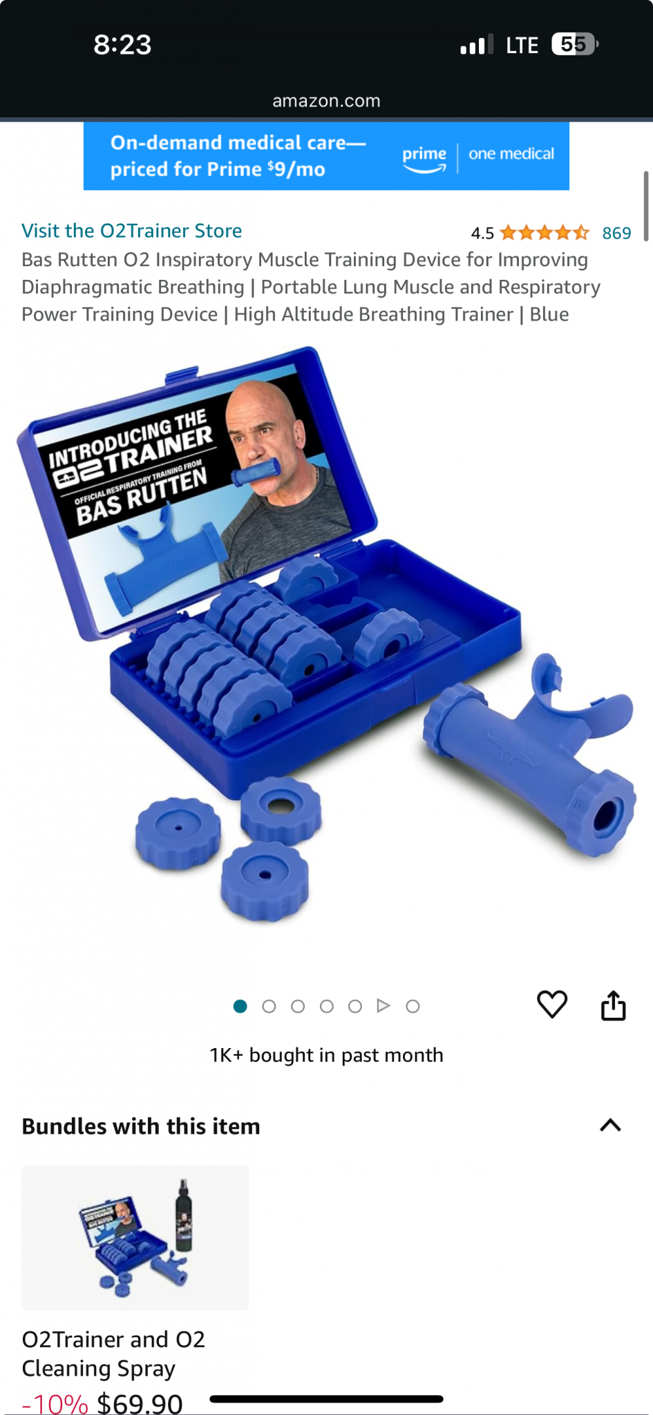

    ^^^. This is how I typically think as well. If you live at sea level and are hunting in the Rockies any cardio prep you can do is going to be crucial. Air is pretty f-ing thin at 10,000 feet!
    Sorry for the derail.
    If you want to feel like you’re gonna die like you do in the mountains at home this WILL do it.
    A couple miles of hills with a 45lb pack at 900’ ASL and this torture device leaves my ass kicked.
