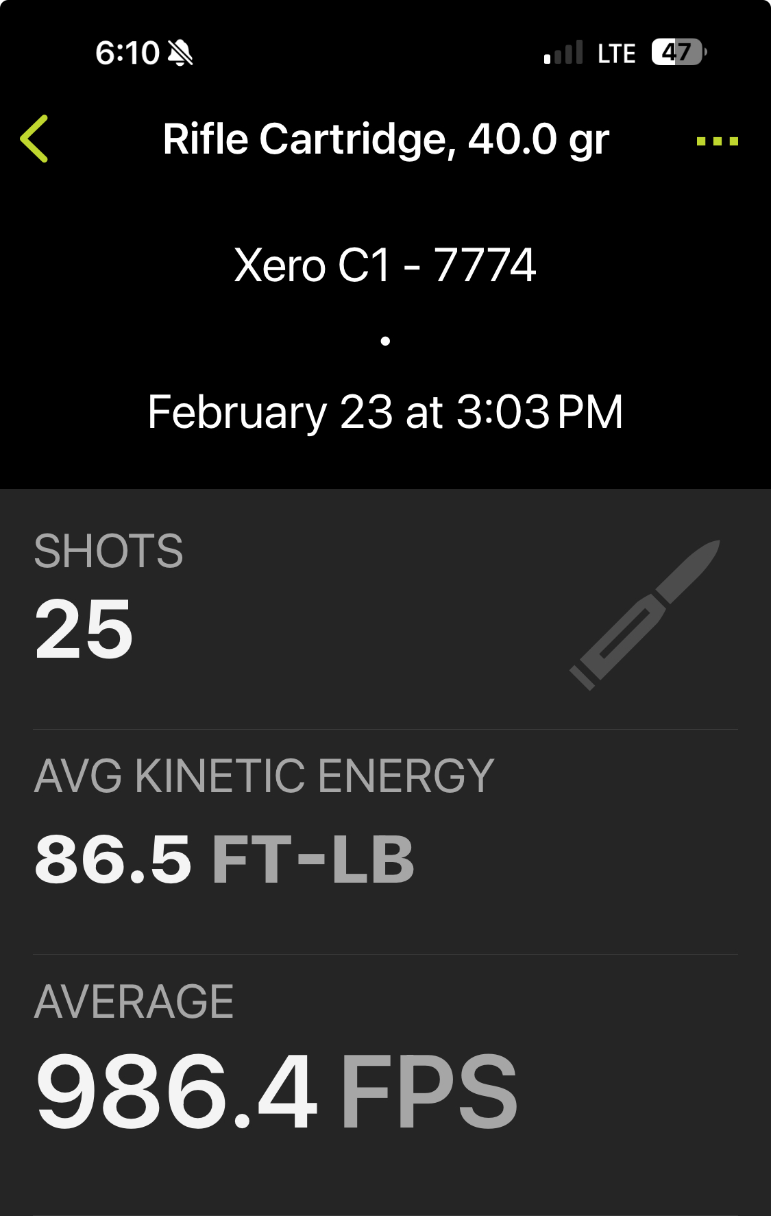

Note: CZ 455 .22, SK Match, 986fps

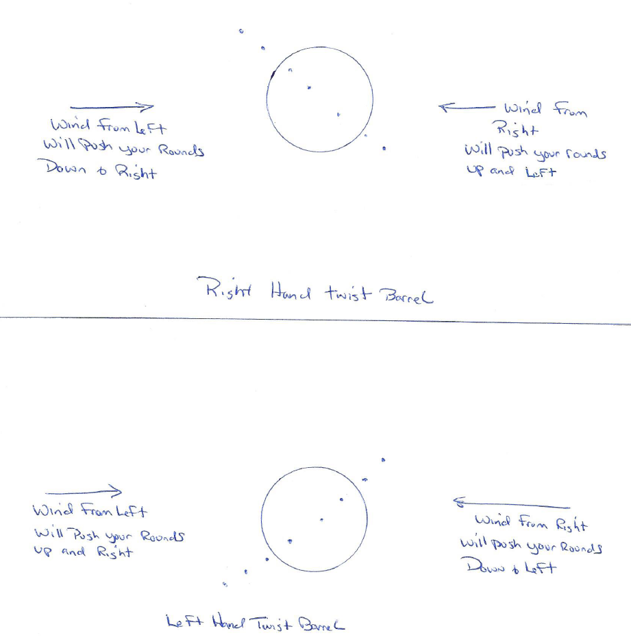

A 12t & 13t will produce more RIGHT spin drift from 150y to 350y than a 16t does. You add the slightest 2-3 mph L-R wind and it grows double +. You add the same 2-3 mph wind R-L and the hold is essentially straight up.

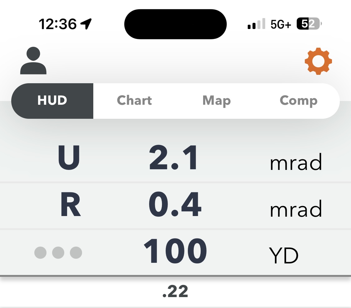

Ballistic calculator should account for spin drift. I'm not familiar with Geo ballistics but I'd bet it's in there.
Look through the settings.
The little gear icon at the top right on the Chart tab has the setting. It is usually on by default.
If you put 0 MPH wind should see a wind correction of L 0.3 at 300 yards with a 1:12 right twist
