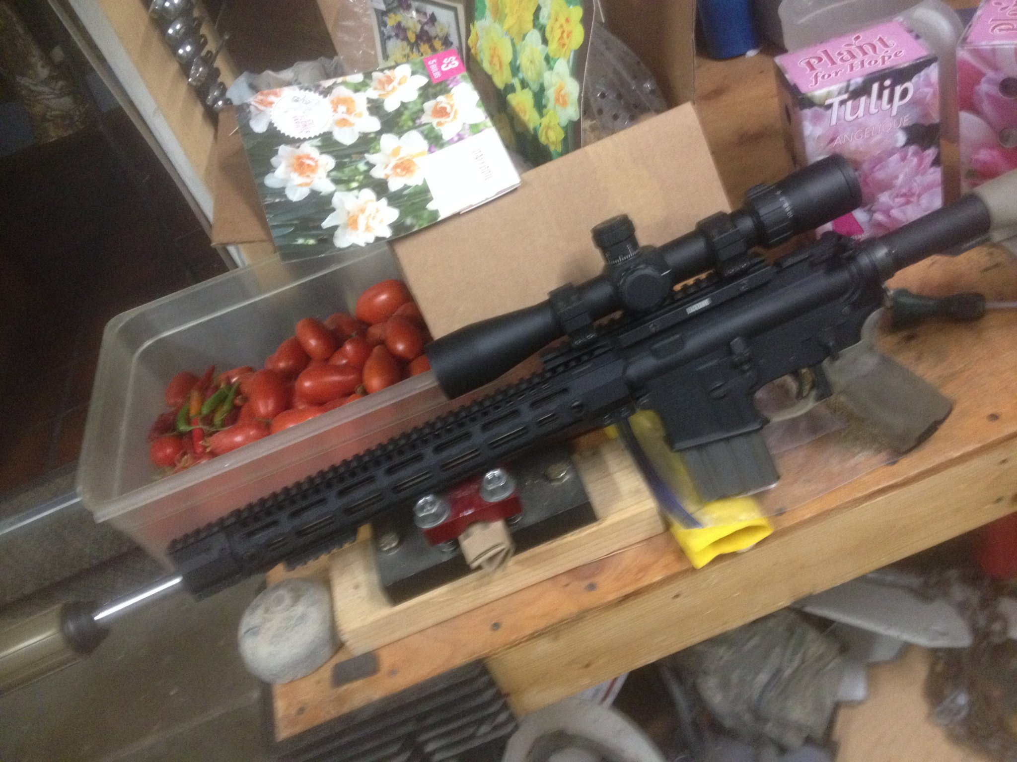

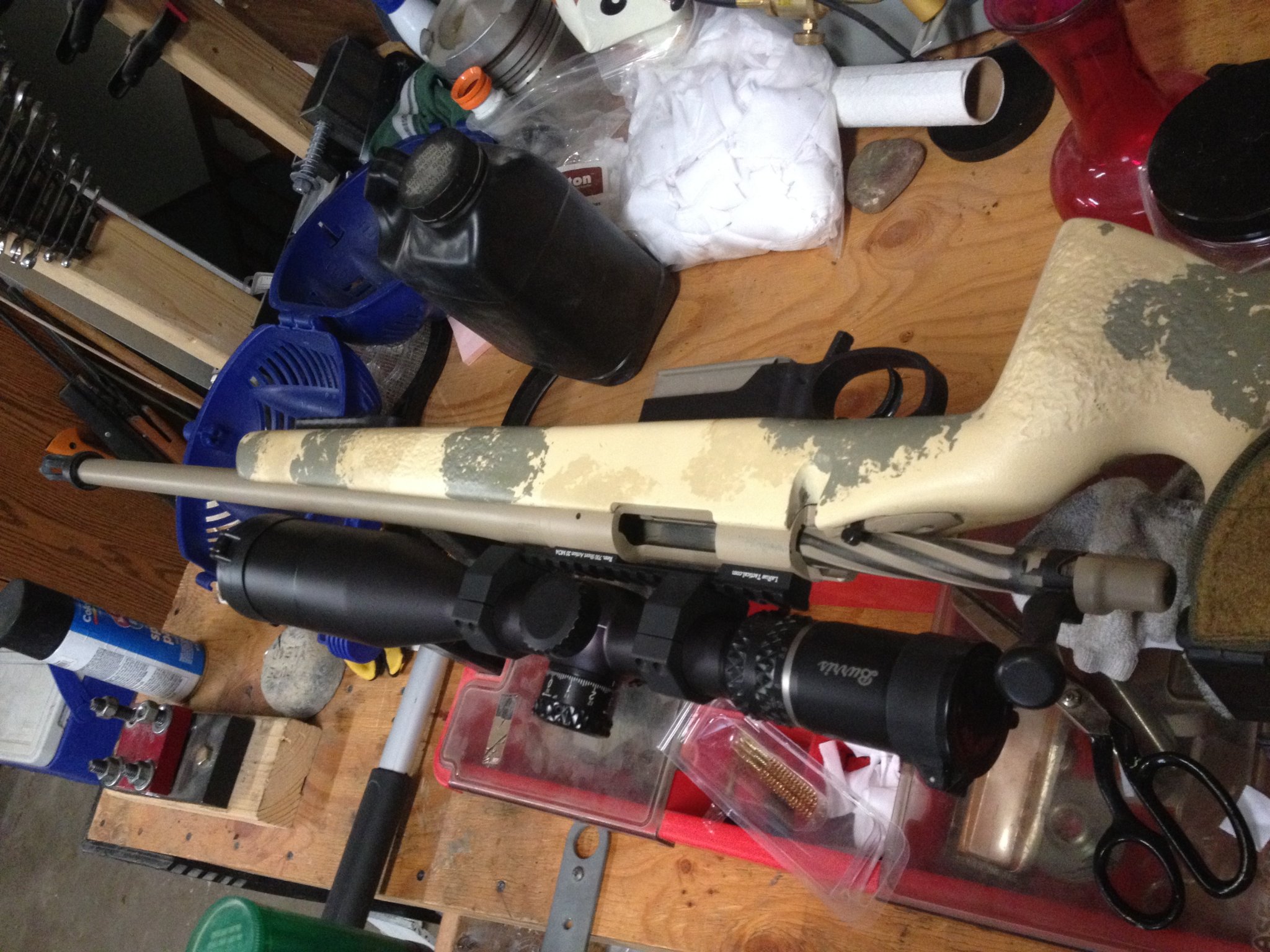

I mounted mine of the corner of the table I built using a 2x4 basics kit. I reinforced the corner on the underside with an extra layer of 2x4s, that are screwed to the top and the 2x4 frame on the outside, then used a 2x4 to sandwich it on top. It gives me some extra room over the bench for tightening muzzle devices without pulling the BA out of the vice and turing it around. A couple kind of bad pictures I had laying around.

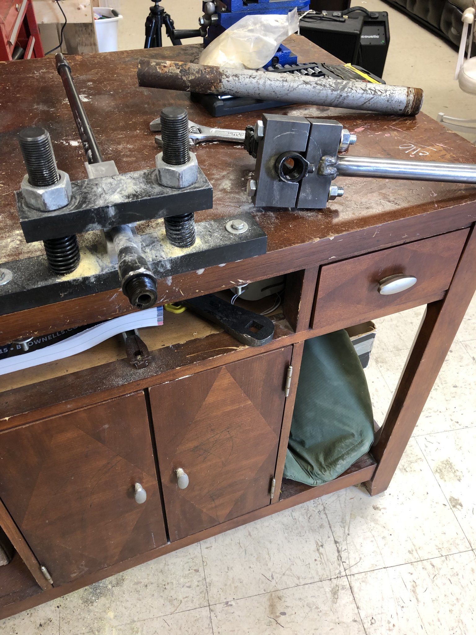

I have a 2" trailer hitch receiver mounted to the underside of my bench with the receiver tube flush to the edge. I bolt all my vices to trailer hitches and secure with the Curt anti-rattle hitch pin. It locks up nice and tight. It makes it easy to swap out different vices. If I need the entire bench top for something large, it is easy to get the vice out of the way.
