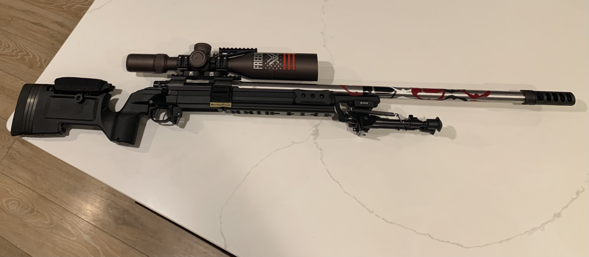

Rebarreling a Howa on a budget:
1. Take your factory Howa barreled-action to a local gunsmith and have them remove the barrel, should be less than $50 and is worth every penny compared to fighting with removing it yourself (unless you happen to own everything needed for a worst-case-shit-it's-not-moving scenario).
2. Go to Crown Ridge Barrel Works and order an X-Caliber barrel with one of their barrel nuts: ~$400.
3. Spin the new barrel on in your garage/basement. Interestingly, since a Howa 1500 has a square bottom, you don't even need to buy a barrel vise, a regular bench vise will do.
I've had 2 of them for Howa and both shot as good or better than anything I've ever had from Proof or Bartlein.
Howa + CRBW MTU (zoom in to see the barrel nut installed):
