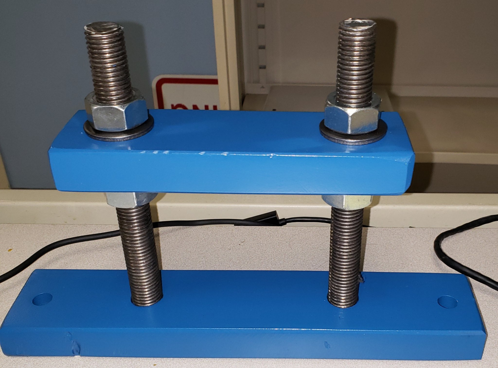

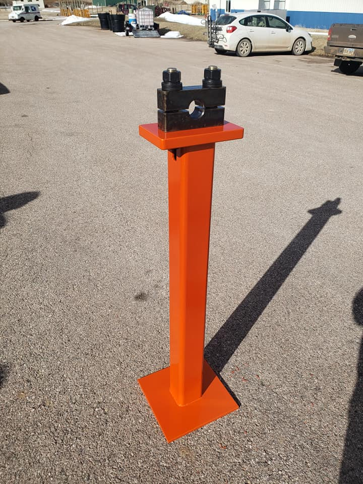

Friend of mine built this one from scrap.

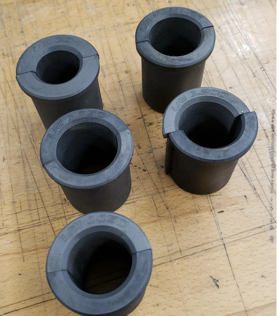

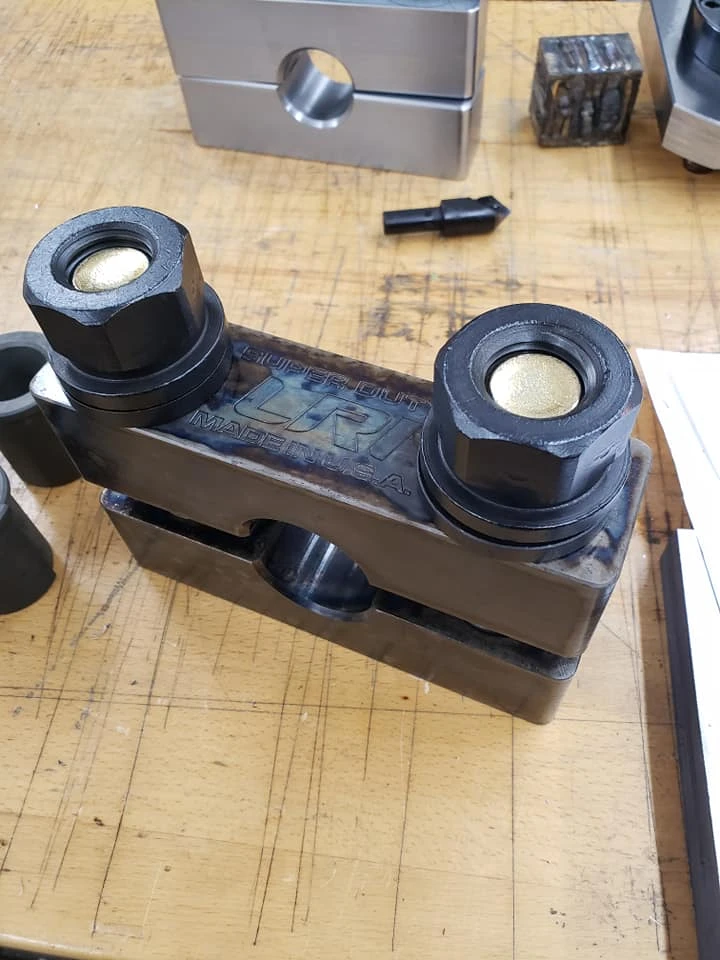

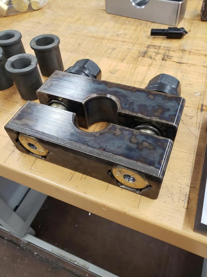

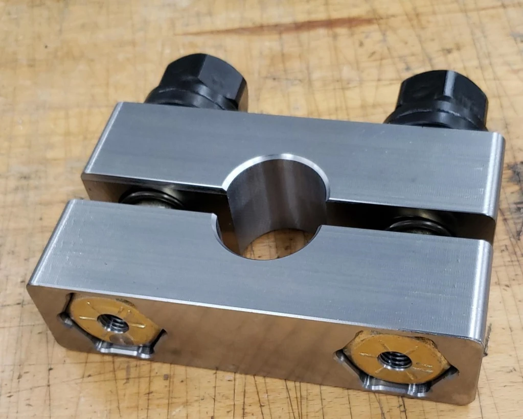

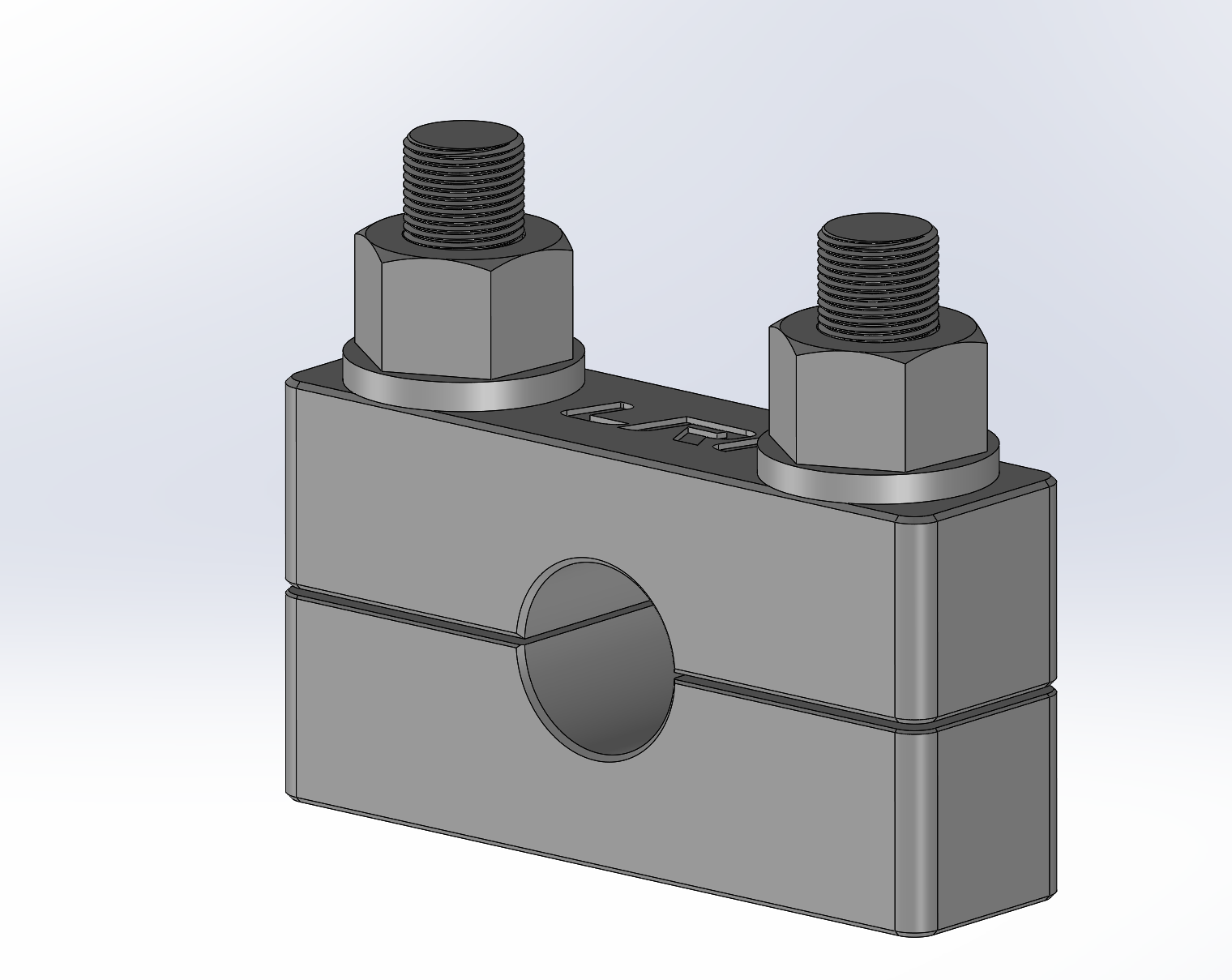

Going into production tomorrow:
LRI Professional Gunsmithing barrel vise and collet set.
All steel.
All heat-treated hardware (1.0" grade 8 bolts)
All steel machined collets
Spring-loaded to split the halves when breaking it back down.
SEVEN years of vetting on the first one I made for myself. We've been a steady 110-130 barreled actions a month for a few years now. On average a barrel will go on/off a receiver at least 4 times during its normal process here. That equates to around 35,000 duty cycles.
I made this vise out of pure necessity after killing several other brands. I had to replace the bolts last year and one of the collets is starting to deform a bit so it's due for replacement as well.
Collets are 36 Rockwell Chromoly. The vise is 8620.
It won't be exactly cheap but if you work in this trade and do this for a living, this is the vise you'll buy once. We pull Tikkas apart, RPRs, 03's and Mausers all day with this thing. By comparison, I've replaced the drive head on our 3' breaker bar 4 times now.
Debating on selling the stand as well so that its all in one.
