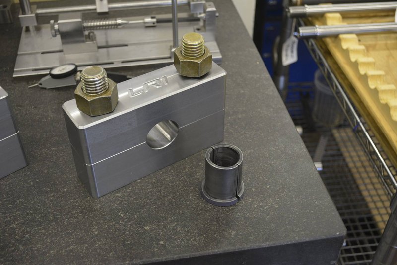

Wanna do this once? Here you go: Collet sets available also. I made this 5 years ago. At a 1400+barrel a year install rate with a min of 4 cycles per job it's lasted over 20,000 duty cycles. No stretched bolts, no slippage, no nothing. It just works.
I made this after literally killing every barrel vise I'd ever bought. Probably more than what a home hobby guy needs, but it's kinda' like a Matco tool; buy it once.
These are not exactly cheap as the collets and what not are a fair amount of work. $1,000.00 for a full set. If your a full time guy, it's money well spent as you get to work instead of cursing a stubborn barrel on a vice with no bite.
I have two units on the shelf. Collets will have to be made, but I do have the material so it's not too long a wait. If this "takes off" I will consider a possible group buy or something.

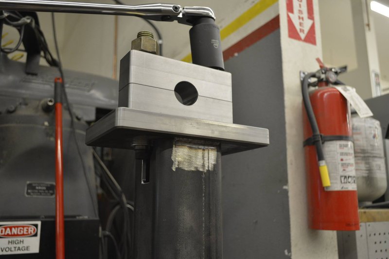

This is a stand I made for our 2nd one back in finishing. The later photos show the bottom but the 1/2-13 holes are not drilled/tapped yet. In this photo you see it fully assembled.

Example of a collet. Heat treated steel machined to a smooth finish. AL sucks for collets. It'll yield every time. If your stabbing a finished barrel then just wrap a layer of note paper around it. Easy stuff. I can also make "Oh Crap" collets that can be machined for odd ball sized barrels.

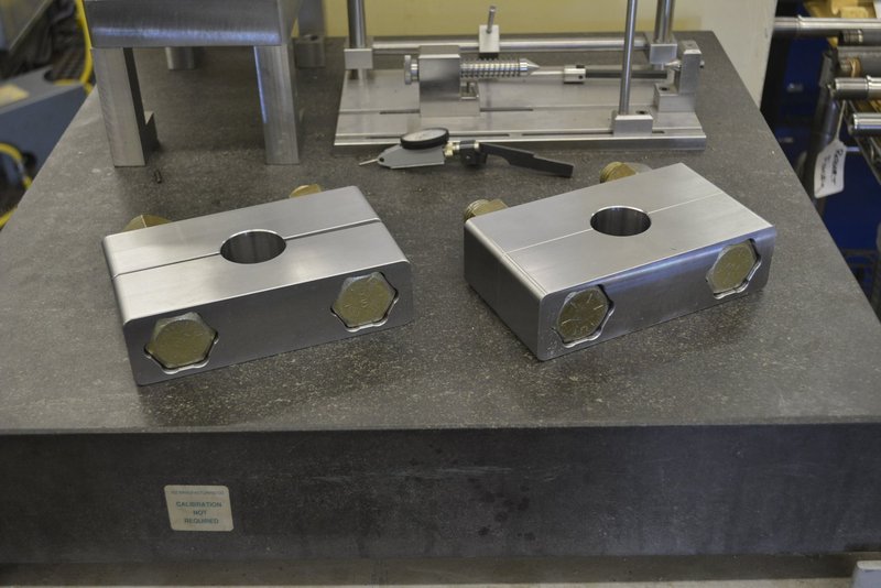

100% machined on every side. No saw cuts, no torches.
We do a tremendous amount of barrel work here. I've killed a lot of barrel vises over the years as I exceed their duty cycle. It prompted the development of this: 5 years and running. Not one issue thus far and we've used 5' long cheater bars on stubborn actions.
We literally just finished 1st op on collet sets. Rem Sporter, Rem Varmint, 1", 1.2, and 1.25" Still have to engrave and finish them.
If you do this for a living, it's worth considering. Not cheap, but you buy it once and it won't let you down.

This pic doesn't show it /\ , but the mounting holes are drilled into the heads of the bolts. 1/2-13 bolts tie it down.

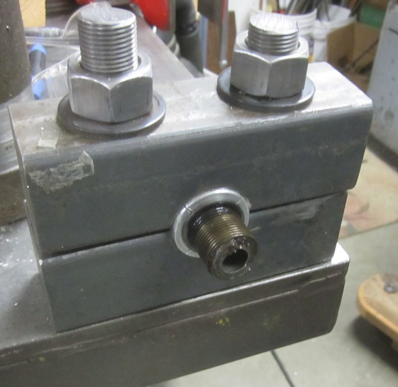

I make my own barrel vises and action wrenches.
The barrel vises are made from 2x2 steel.
The collets are made from 1.5" round Aluminum alloy.
At 550 foot pounds static, Kroil, and a sledge hammer, I can get most any old rusty military barrel off.
I have been doing it this way for 18 years.
For years I did 1/2-13 hardened bolts, but now I have switched to 7/8-14 on the barrel vise.
I use cornstarch to get a higher coefficient of friction on the barrel.
When you design an action wrench, ignore the pictures in the books. Get all the forces in one plane normal to the bolt bore. That will avoid a bind on the receiver..
Whatever Chad does is probably better than me, but I am low tech, with both the mill and lathe with DRO, but no CNC.
