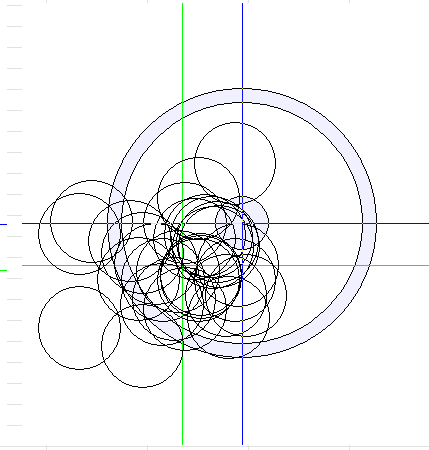

Here is our 30 round test through a Bartlein .30 barrel 1/10 1/11.25 twist shooting .308 175 handloads.
This was our verification group to verify our load was good.
I shot 3 10 round groups for a total 30 round string. Here are the group sizes, the last one made it a bit larger than it may have been otherwise
0.4170.4190.841
SD = 8 for 30 rounds.

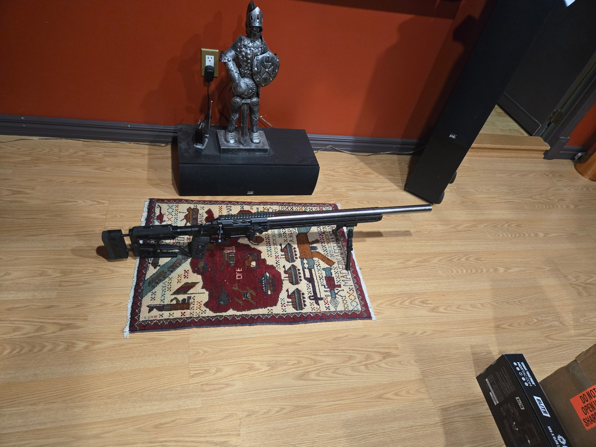

I have to give props to Bartlein.
My shooting partner picked up an abandoned project off of someone.
It has a 26" Bartlein 1.25" straight taper barrel in 6.5 Creedmoor that was spun up by Insite Arms here in Canada.
These are the 25 first rounds out of the barel including getting on paper.
We started load development at 40gr of H4350 with 139gr Lapua Scenars in Lapua LP brass and CCI BR-2's but we are going to back it down to 38gr and start again from there since the velocity is so high.
This rifle looks like it's going to be a hammer.
Weight on the rifle in an MDT ACC Elite Using an Ultimatum Deadline action, a Gen 3 Razor 6-36x56 and an MDT GRND Pod (No Mag) is 21lbs 15oz.
It balances about 4" ahead of the magwell.
Reactions: oldrifleman
