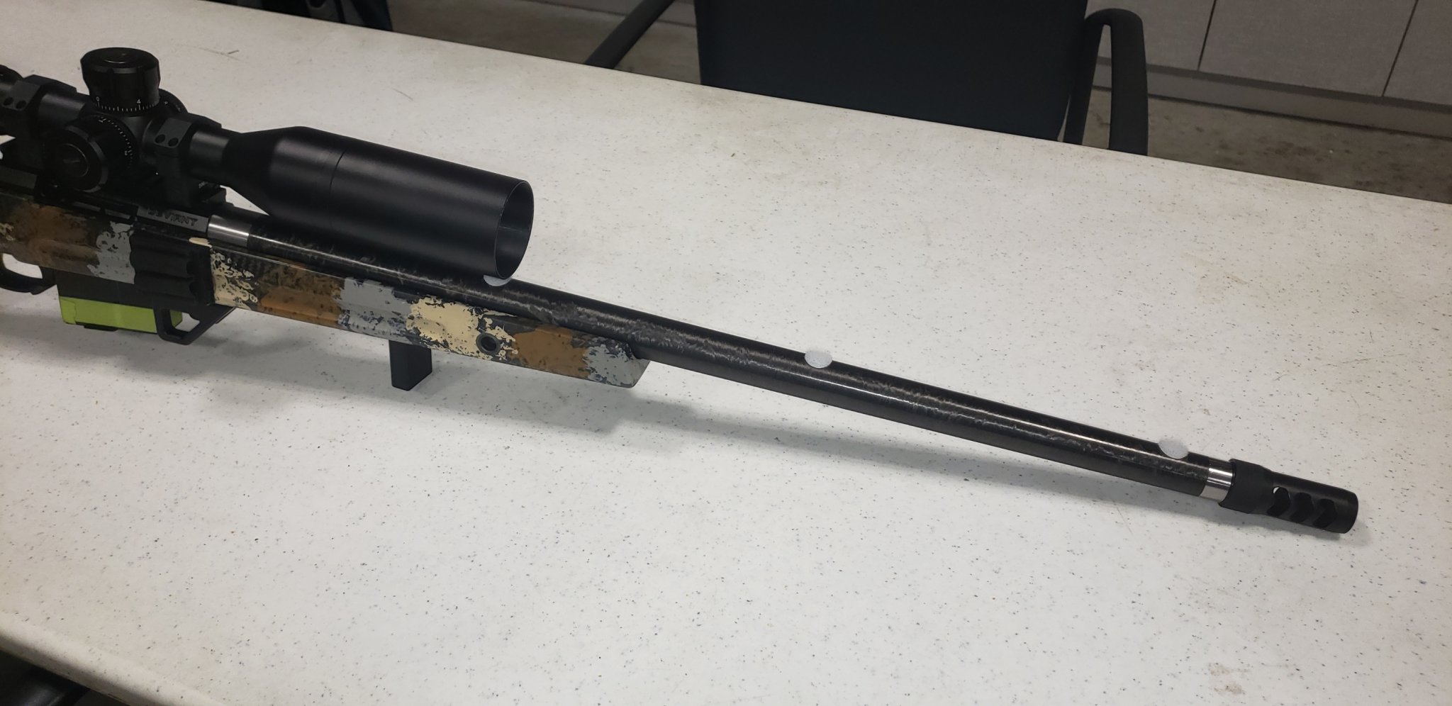

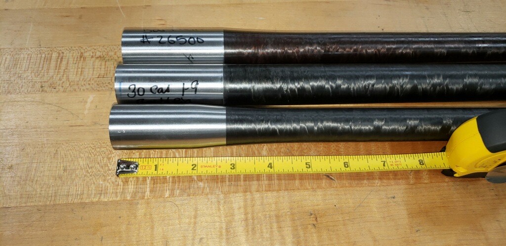

Some more pics attached.
All of the barrels will have a 2" extra steel section on the muzzle end. We still say you have to cut 1" off to cut and crown and bring the barrel to finish length. This still should give you plenty of room to thread the muzzle for a brake attachment etc...The picture with the white dot's on top of the barrel was so I could attach a mirage shield. This was one of the early testing ones (3rd time around on testing CFW barrels in like 5+ years). The heat was coming off the barrel so fast in a short amount of time that when shooting the mirage coming off the barrel effected how the scope reacted to the sight picture/target paster.

@Frank Green how short of a shank could you go with? Assume I could go down to 1” or 3/4”? Not worried about doing a setback in the future
Not sure what your asking about 1" or 3/4"? Just on the breech end? The blanks from us come with a 2.75" breech length of steel showing. I would say cutting an extra 1/2" to 1" off the breech should be doable. Probably have to ask what you are chambering it in?
