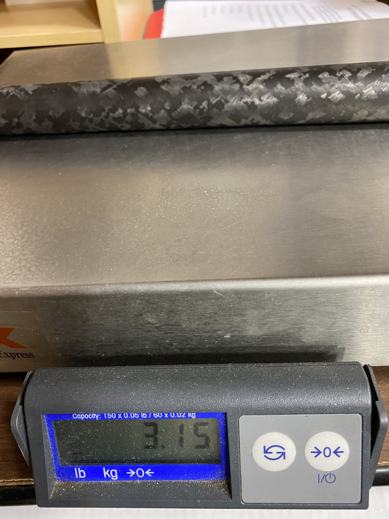

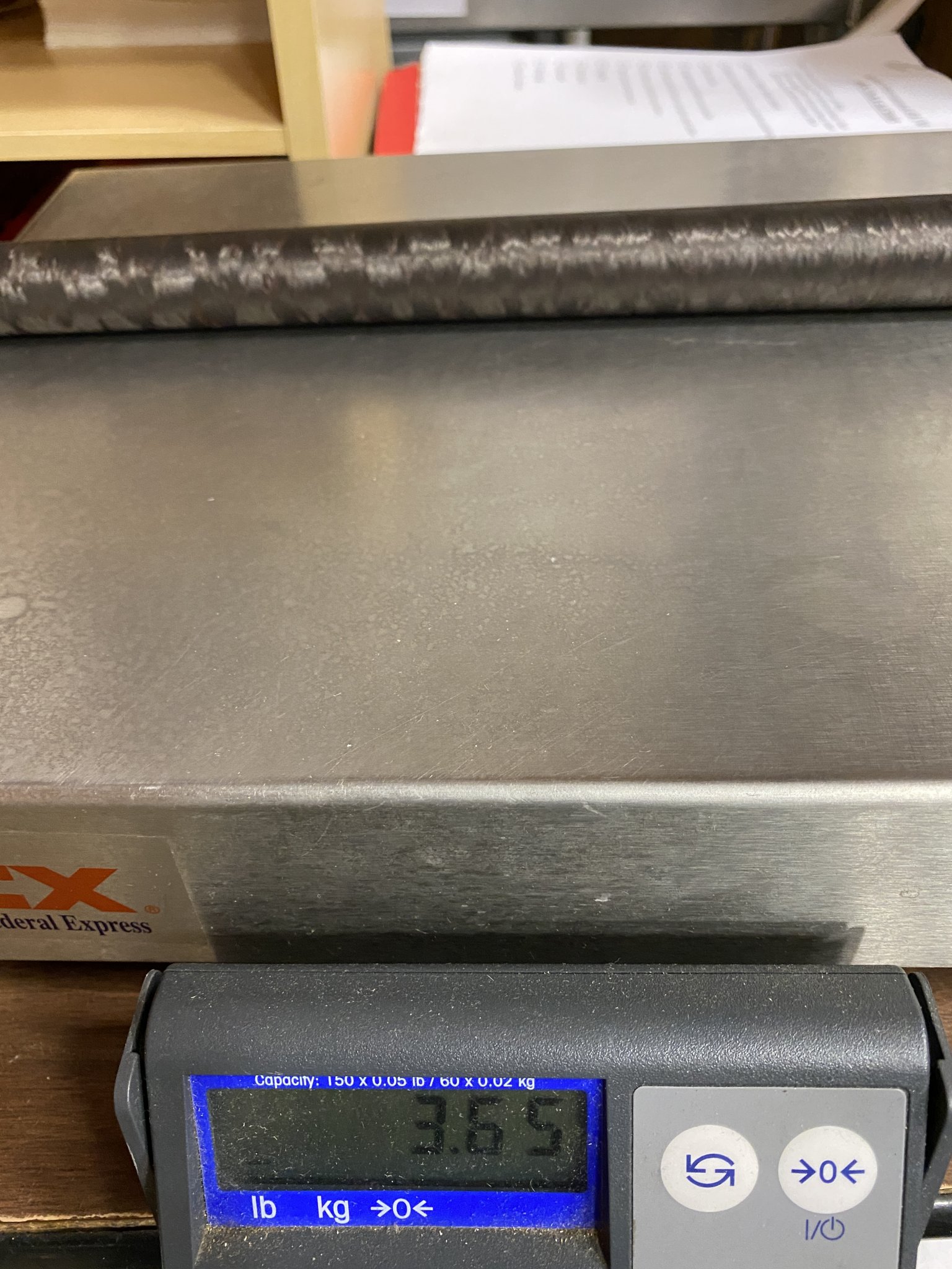

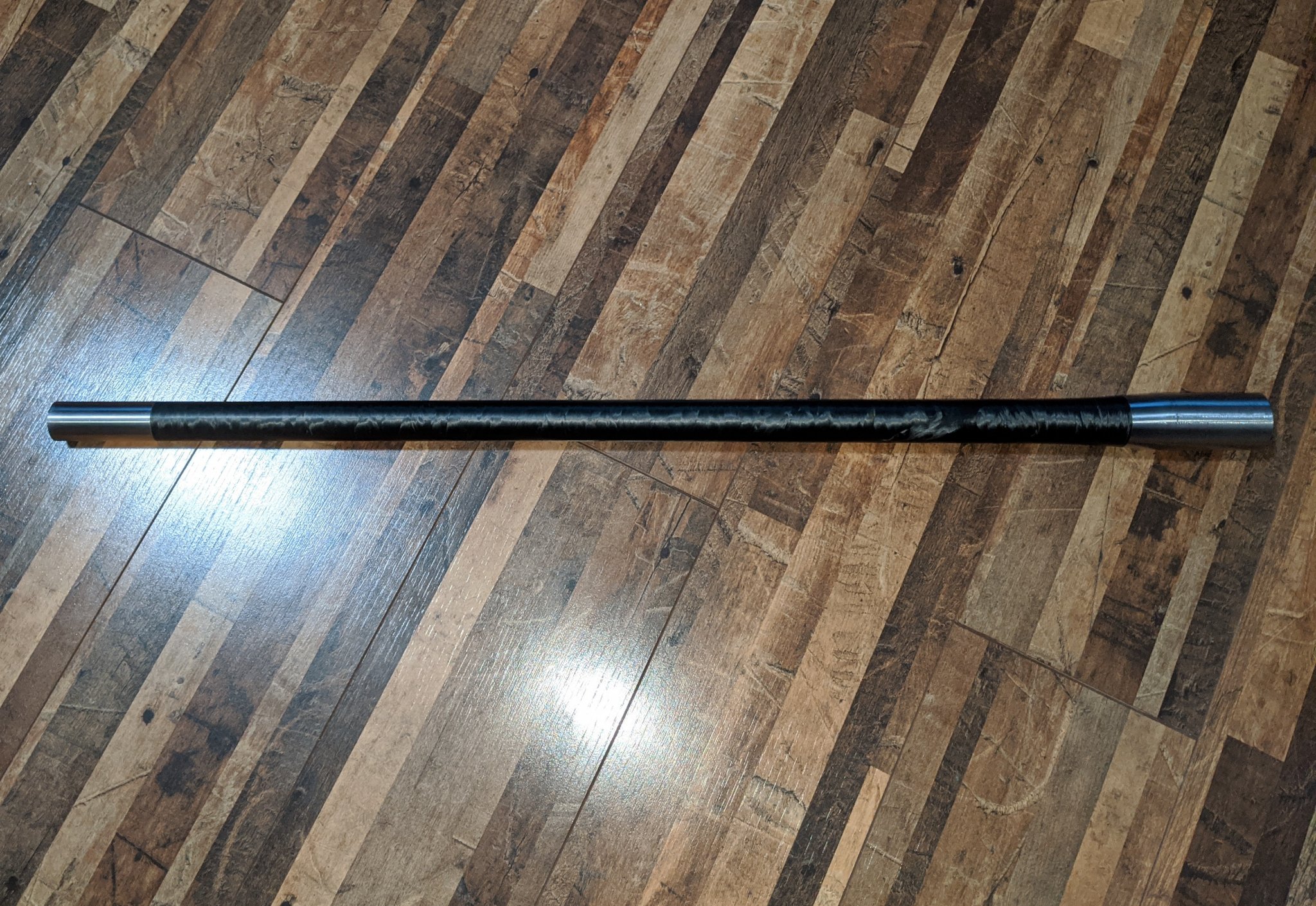

I picked up my Bartlein Wrapped Carbon Fiber Barrel, after being chambered and threaded.
I grabbed a Proof Barrel AI Pre-Fit that matched my barrel pretty darn close and compared the weight
They were much closer when compared this way, pre-chambering the Bartlein was about 1LBS heavier, post chambering it was much closer.
Proof Barrel
Bartlein Barrel

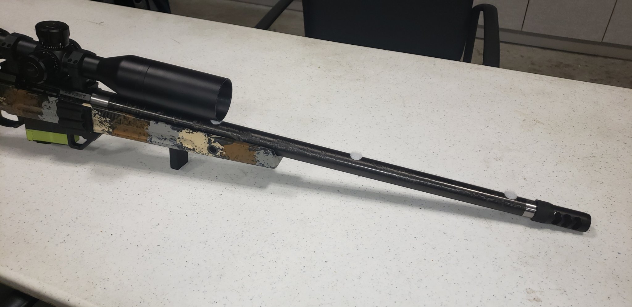

What Frank said!
Back in February Jeff and I went to the range to test a 6.5cm barrels. It was 17 degrees out. After about 7-10 rounds thru it and zeroing the scope (7-32x NF) I went to my first target and tried to shoot a 5 shot group. The mirage/heat coming off the barrel was so bad looking thru the scope that I was using the whole 1" paster at a 100 yards. I had to let the gun cool and then slow down my rate of fire and only shoot 3 shot groups.
Next time to the range and it was 47 degrees out but regardless of the temperature out side I put my mirage shield on the rifle (I have several for my F class guns). That stopped the mirage from messing with the sight picture. In the attached picture the mirage shield isn't on the barrel but you can see the velcro dots on the top of the barrel.
Wade Stuteville and George at GAP has done plenty of shooting and accuracy and getting the barrels hot and not a single accuracy complaint. Wades exact words to me where something close to "Every bit as good as our all steel barrels are!"

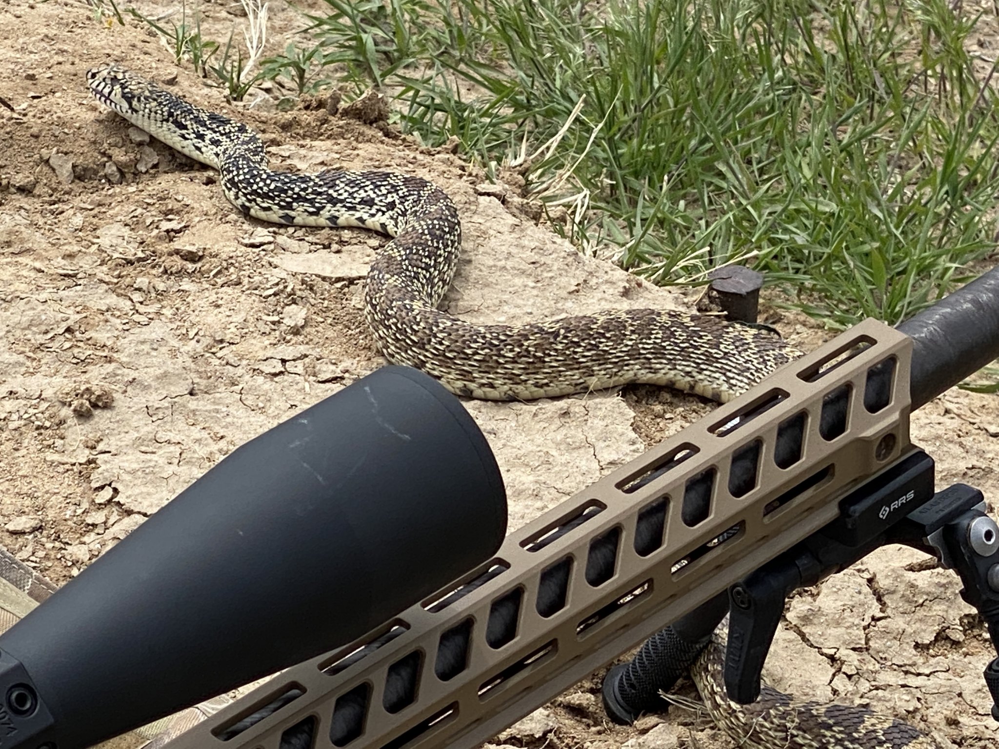

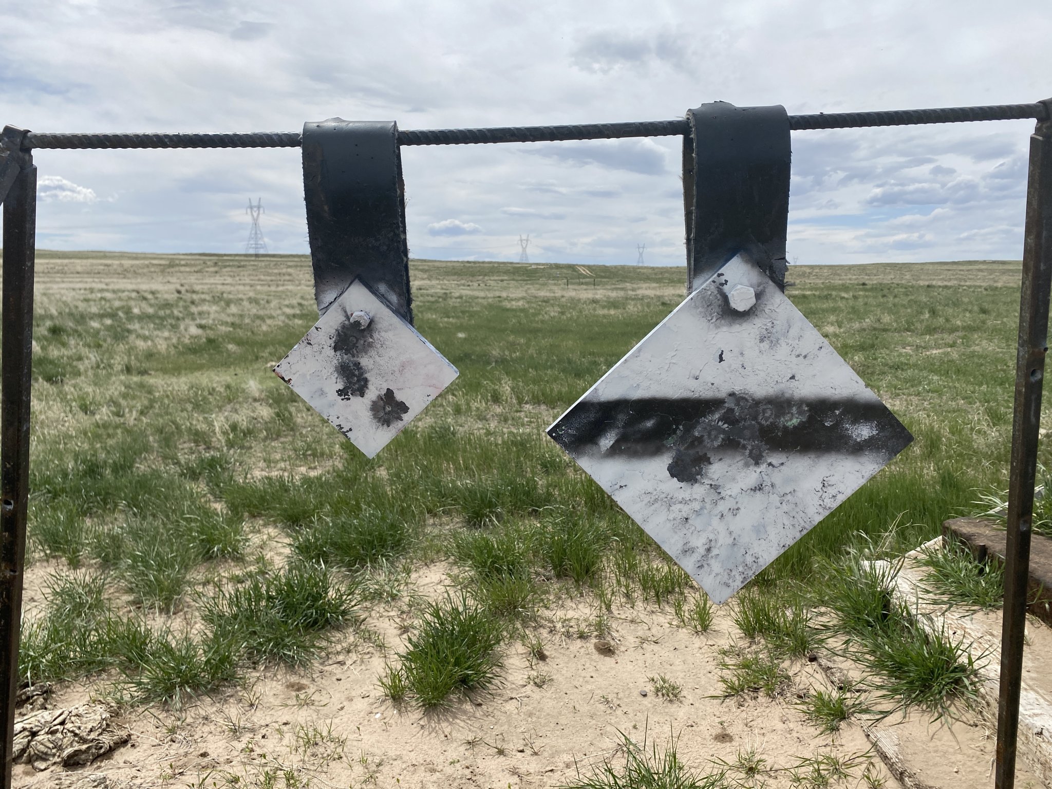

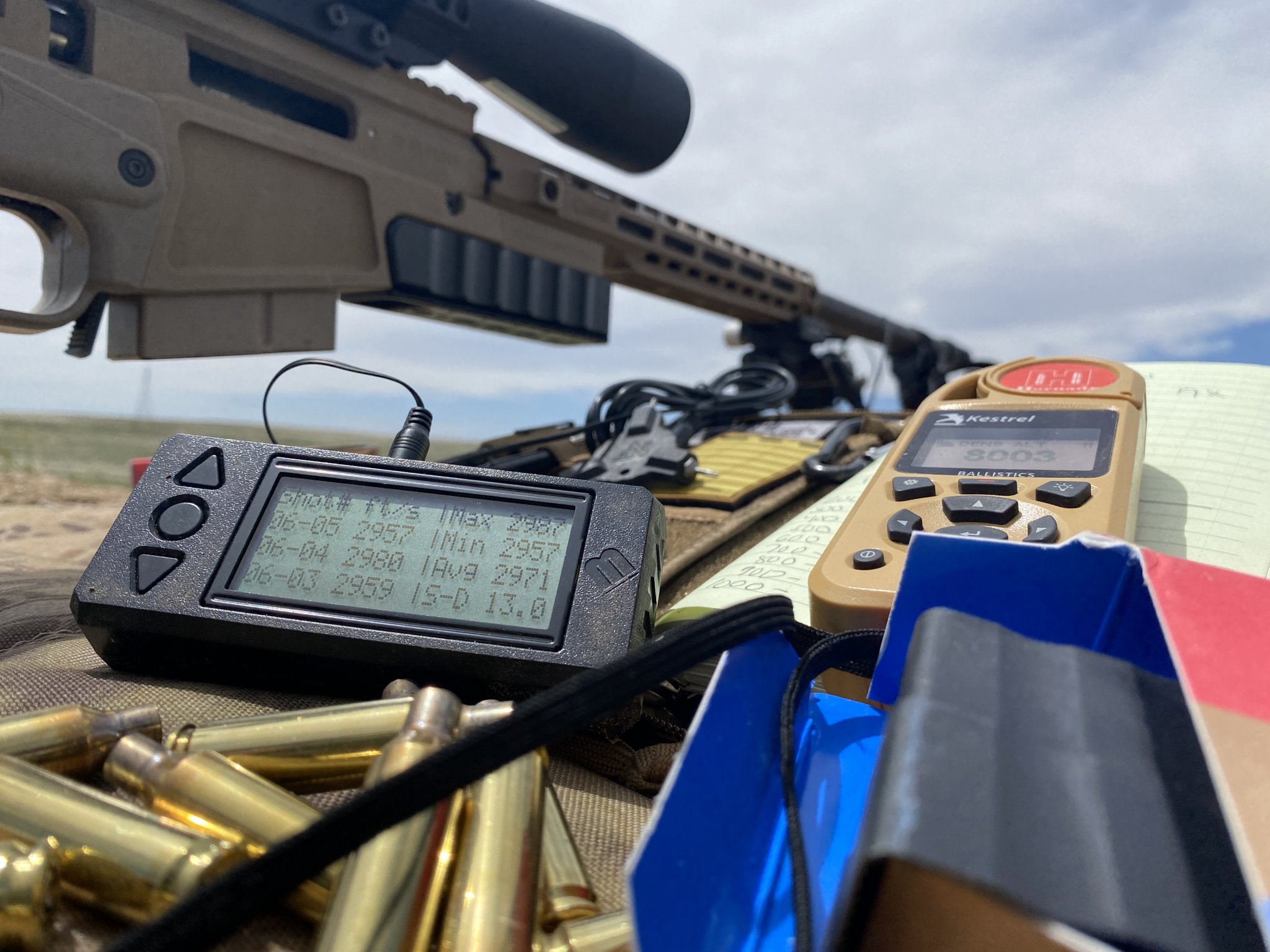

I had a great day out with the CF Bartlein, shot the Prime 6CM and Hornady to test,
Results with the Prime were really impressive, great speeds, superb accuracy.
Speeds with 115gr RDF Prime Load
600 yard plates,
The barrels kick much ass
This little guy decided to camp out under my rifle during some shots, I looked up and saw a snake on my databook at first I thought Rattle Snake but it wasn't poisonous so I let him hang with me
I actually i have no clue
I handed it to MHSA told Adam to spin it up for my AI and walked away
I have no idea what the twist even is without asking Frank.
I am much more lackadayical than many might imagine for me it either works or not, I normally don't ask for much and let the Smith give the best universal reamer they have so I can run just about anything. I sorta hate barrels cut for a specific bullet.
I honestly don't know, I think it is 24" I know it's 6CM, it's for my AX, and it likes Prime Ammo, beyond that, I don't know much about it,

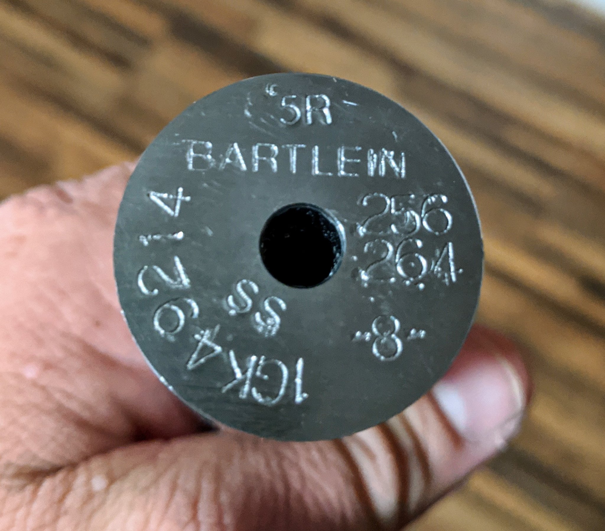

@lowlight any info of your 6mm Creed CF Bartlein? Twist (right/letf/gain), free bore, length? Thanks,
I’ll double check tomorrow.
It was one of two left over CF barrel from the first batch we made for testing for this go around of making these things. (3rd time testing CF barrels). When Frank and I talked about the CF barrels it was the only thing I could get to him quick that I could lay my hands on.
It’s a right hand twist, and believe it was a 1-7.5 twist and 5R rifling. It was a 27” blank M40 contour.

Looks like a Bull Snake, used to catch those guys when hiking around Boulder, love those snakes. Were you having mirage issues with the rate of fire you were shooting?

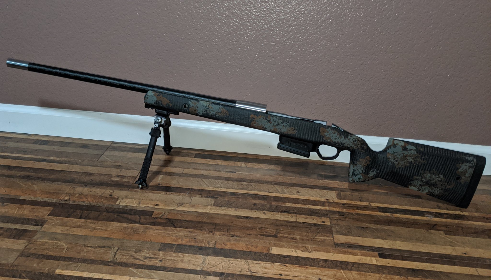

Brady what up! You sold me mine. It was the 8.5-7.5 GT in 6mm creedmoor. It came in a week or 2 ago and the smith is spinning it up now. Can't wait.
Will def be reporting back once up and going.
Tanner in Vegas
