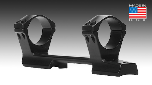

I have had about 12-15 Bergaras at this point and my favorite base for their guns that are not in chassis is the Nightforce Direct Mount. Its 20MOA and you don't need a base at all. Mounts directly to the action. Saves weight, eliminates possible tolerance stack issue and works like a charm. Not sure if they make one for 8x40 screws or its setup to accept them though. I ran these on the HMR which is not 8x40. If you go with a standard base and mount, I like the 1.375 high if not running NV with a 50 tube and 1.5 if you are going to run NV. Ive used ARC which are awesome, ZR0/Alamo and NF which are better than advertised IMO.
