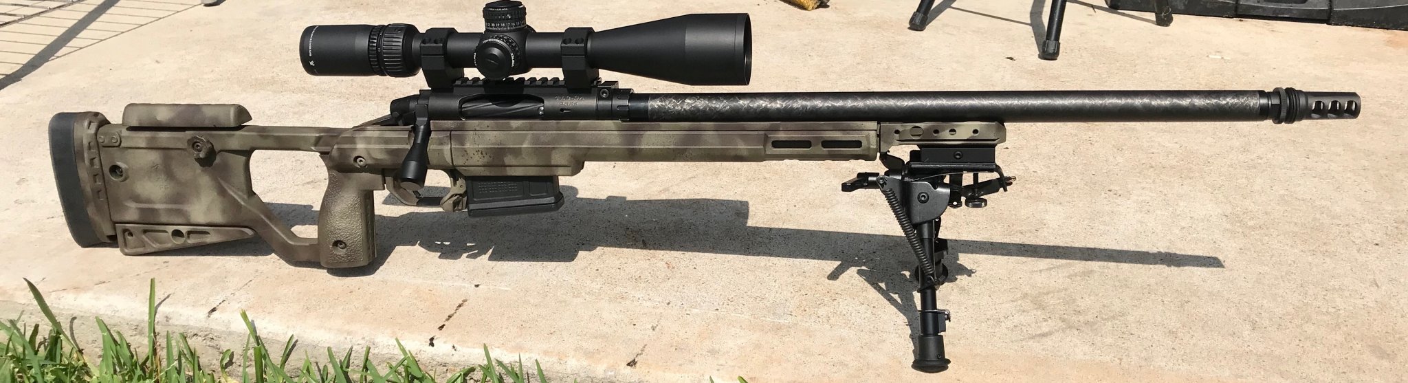

just as skunkworx stated, its very easy and all you need is an action with savage threads, barrel nut, headspace gauges, and a way to torque the barrel nut down via vice and action wrench. I built a 6.5 creed with a bighorn tl3 action, proof cf savage prefit barrel, and an arc barloc barrel nut. came out beautiful and shoots .25-.5 with factory match ammo. I use the barloc barrel nut because it allows barrel changes without a vice or action wrench. My build is based off a short action so you would just need a long action to get into the 300magnum.
