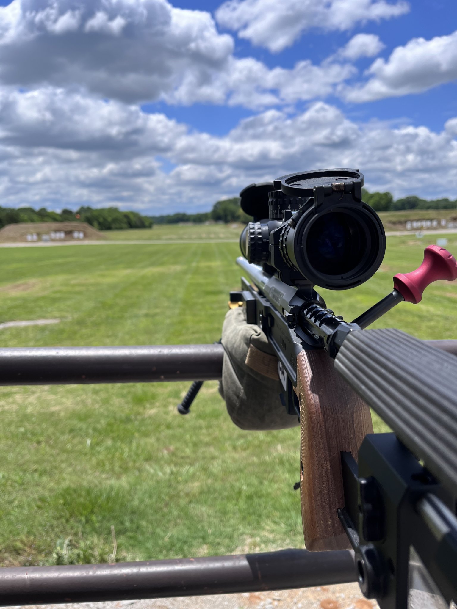

ARC CDG or Aero Solus.
Seriously, don't just laugh at the Solus because it's Aero...Check one out before scoffing at them. Mine was a tiny bit stiff when new, but after about 500 cycles with some Aeroshell 33/64 on the bolt head, lugs, and raceways, it is now ridiculously smooth, with light bolt lift. It glides like it's on rails. 60º bolt throw. Dual ejectors. 3-lug. Interchangeable bolt heads. AICS & AW cut from the factory. Uses a really nice (no play) trigger hanger setup. 20MOA integrated rail on top. Dual, forward-facing gas ports. Heavy duty and made from a solid billet of 416r stainless. Specs-wise, it's pretty decked out for a sub-$700 action on sale.
