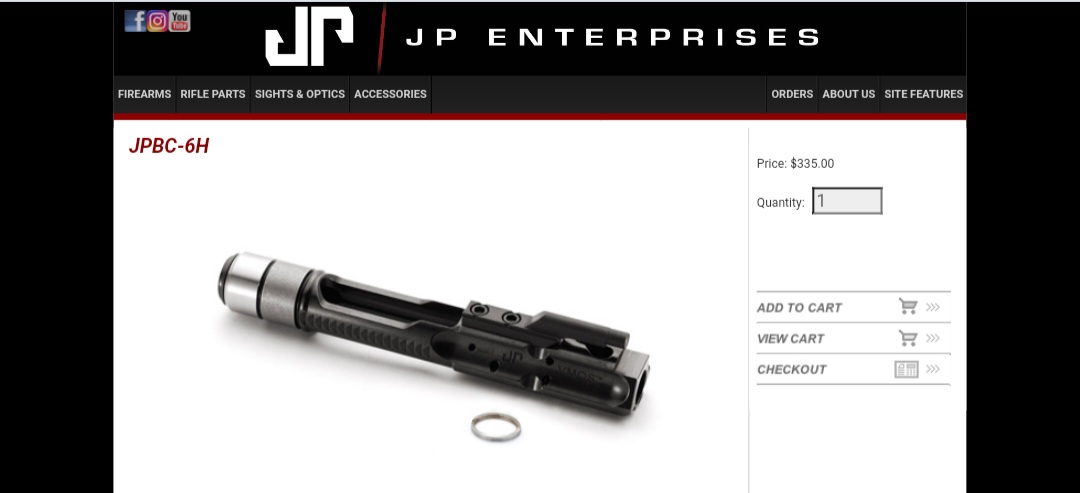

I've never watched any videos from this gentleman but have went down the BCG tilt rabbit hole before and as he mentions above proper fitment is paramount. I will say that there are better options than drilling and tapping the rear of the BCG available, now it's not as cheap but in my opinion and better option.
If carrier Tilt is a concern I recommend buying the JP variable Mass BCG.
The weights at the rear of the Carrier are easily removable and you can have your local Gun Smith measure the exact amount needed to bring the rear of the carrier up and in line with the center of the bore by turning some custom weights in aluminum or steel also providing more options for tuning the operating mass.
