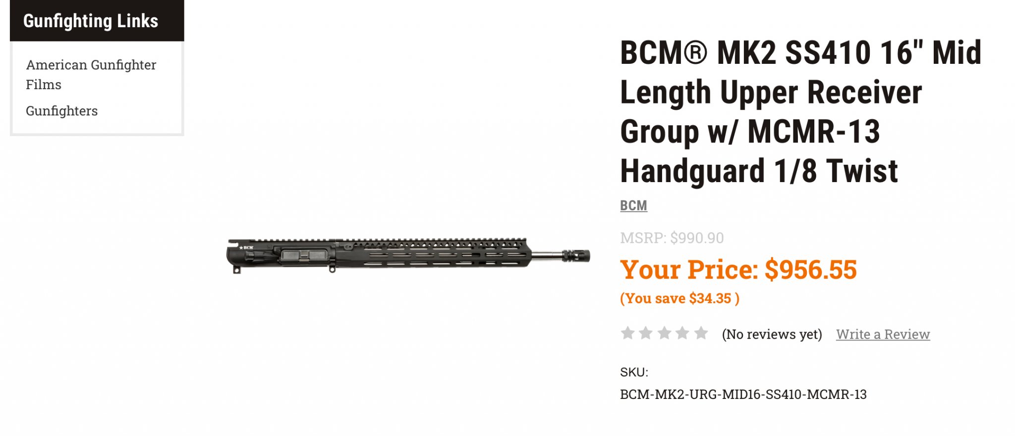

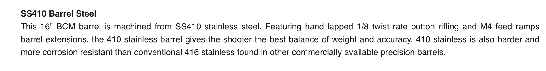

Has anyone ever used one? They say they are hand lapped and button rifled. I wonder how they compare to WOA and other barrels in the sub 400$ price range? You never really here anything about their barrels and precision rifles in the same sentence. Is there a reason? Or are their barrels precision oriented barrels just not well known and good stuff? Or should I stick to tried and true.

Read the fine print. he says his 410 is superior to conventional 416....not 416R from crucible which is US steel like the premium 416R barrels from good American barrel makers. ..conventional 416 is usually chinese shit like the 410...
Well thanks guys. Sounds like I should just order the BCM upper I want and immediately pull and sell the barrel. Since it will be the only way to get the new MK2 upper.
