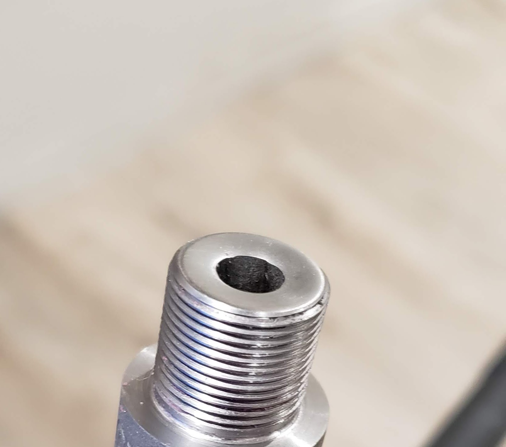

Hey guys just got a bartlein barrel today had the shop bead blast the barrel. I just want to ask before I contact the company.
The rifling that meets the crown looks like it took a beating during the bead blasting. Its like that all the way around
Thanks
I was prepared to tell you that you were worrying about nothing but looking at that it does appear the edges are rolled over. I dont know why they would even get near the crown while bead blasting but they may have slammed it in some type of spindle for the work in the blast cabinet. I would recut it if you have the tool, you can buy from brownells or send it to have them do it.

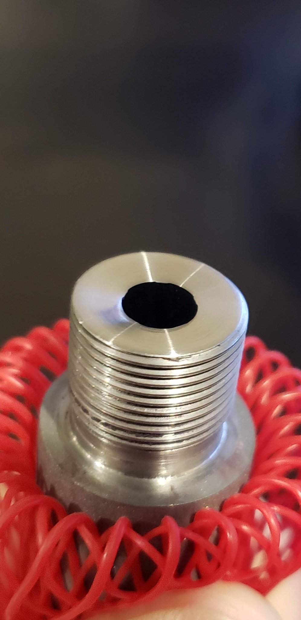

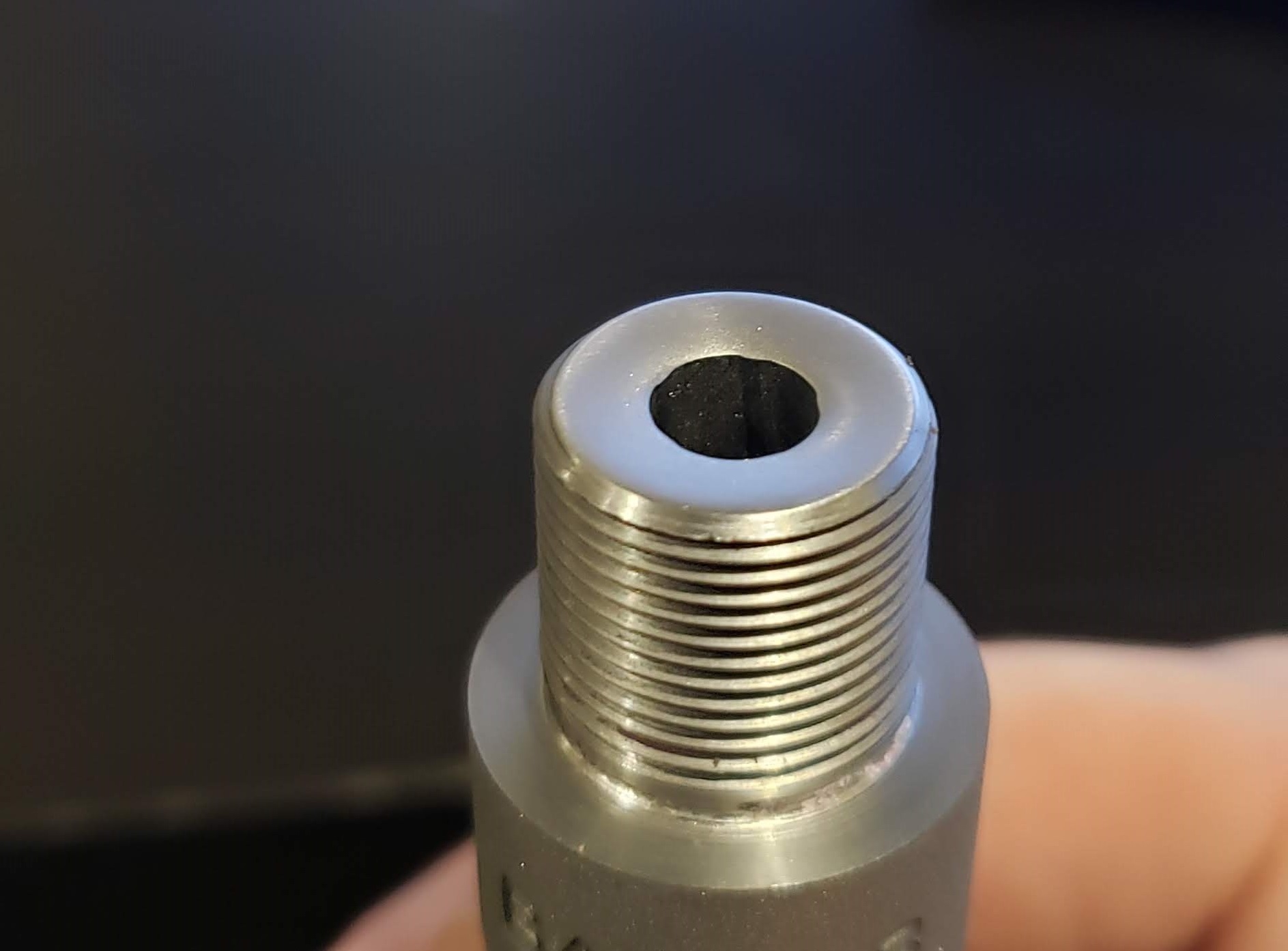

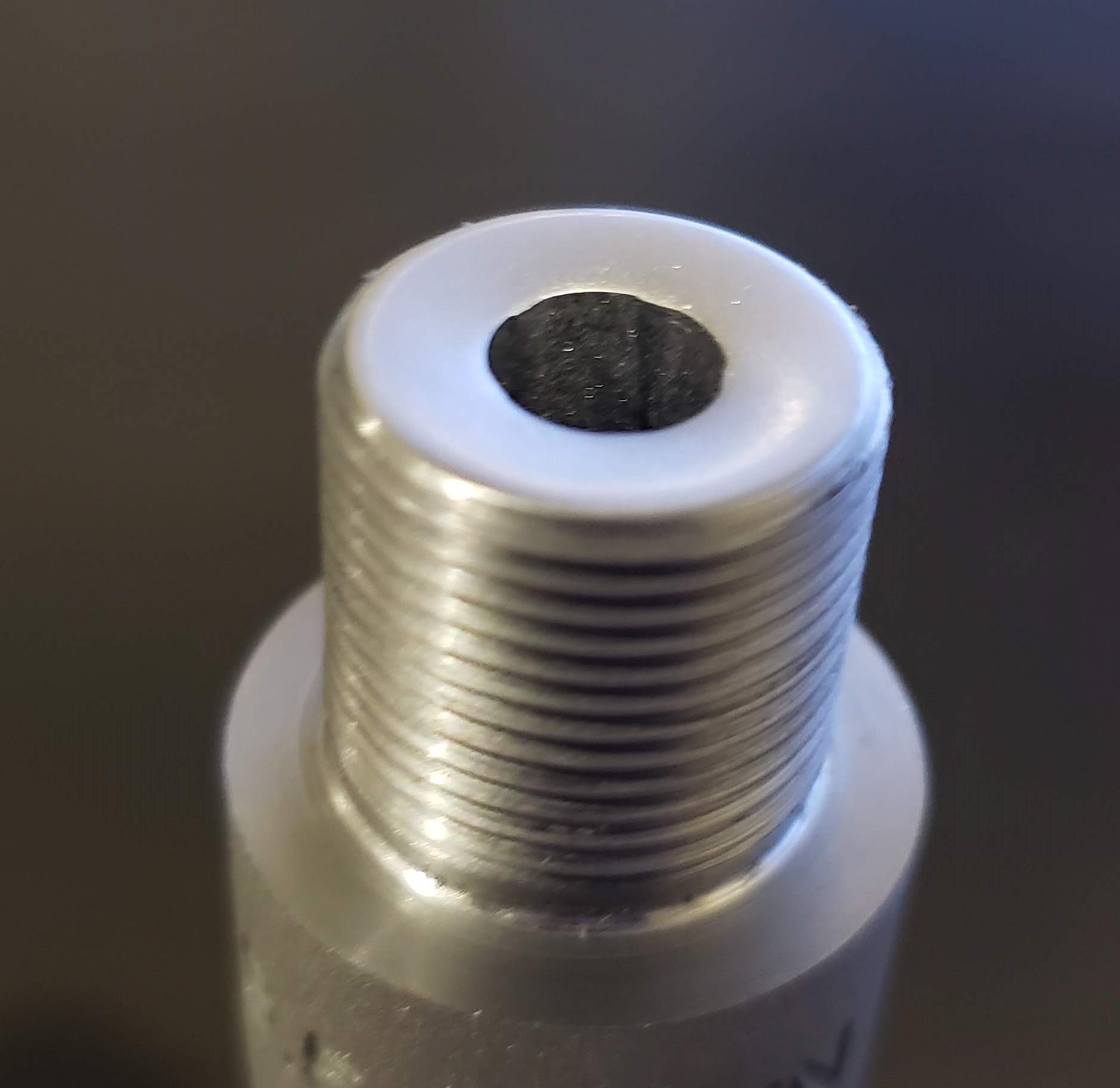

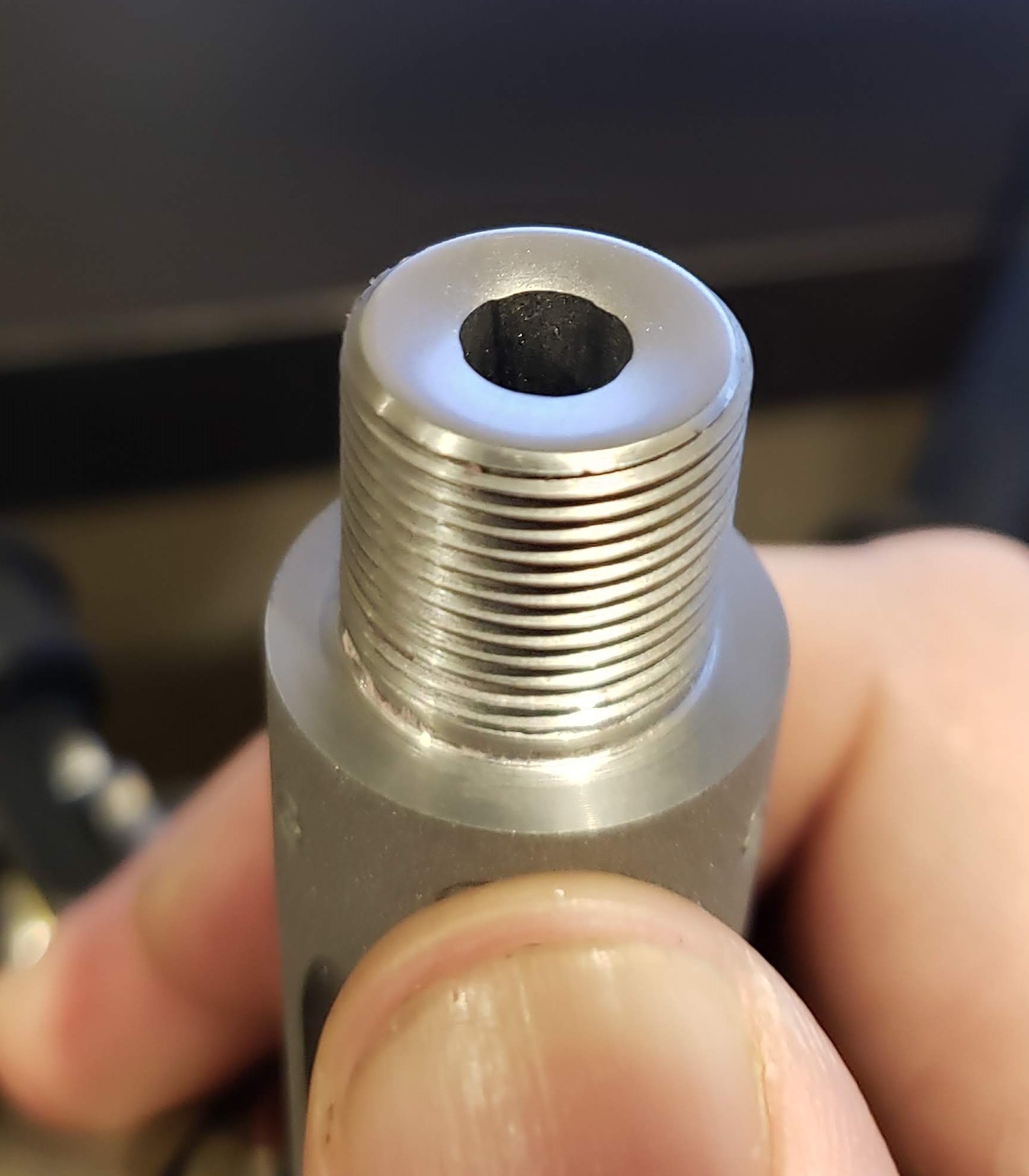

Ok guys, this has been eating at me and wanted to just show a few more pics of the rifling and the crown. To me the rifling looks rolled and I dont think it can be fixed.
Just to hear what you guys think. I think the barrel needs to go back, most likely redone.
The first couple is the barrel that is causing me my anxiety right now, the last picture is how I think the crown should look.
I always install muzzle and barrel extension caps on and tape the hell out of them before bead blasting. Those glass beads are very fine and seem to get into places you wouldn't believe possible. Make sure to clean the hell out of that barrel before using it. I'd be a little pissed if I was you.
