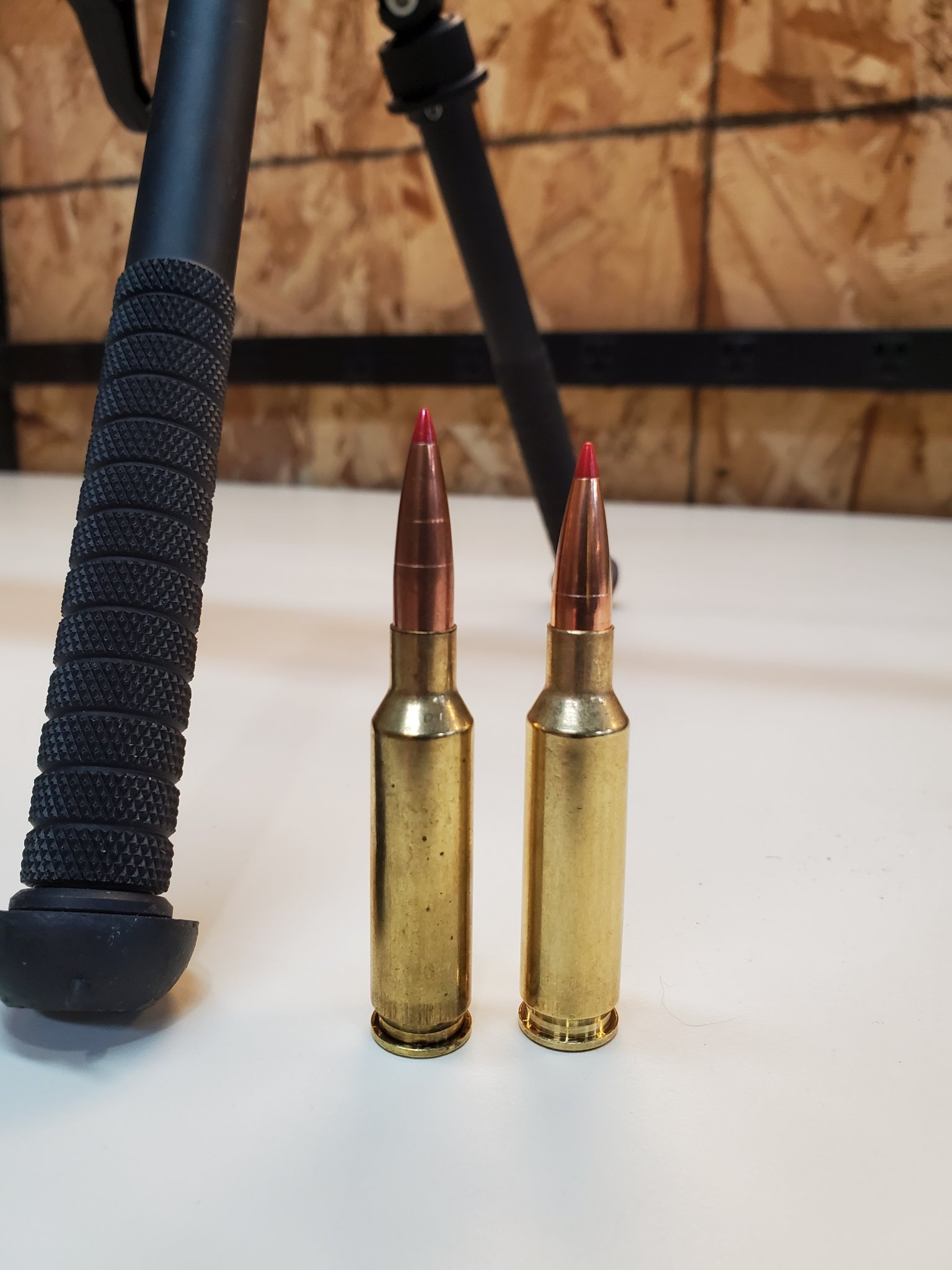

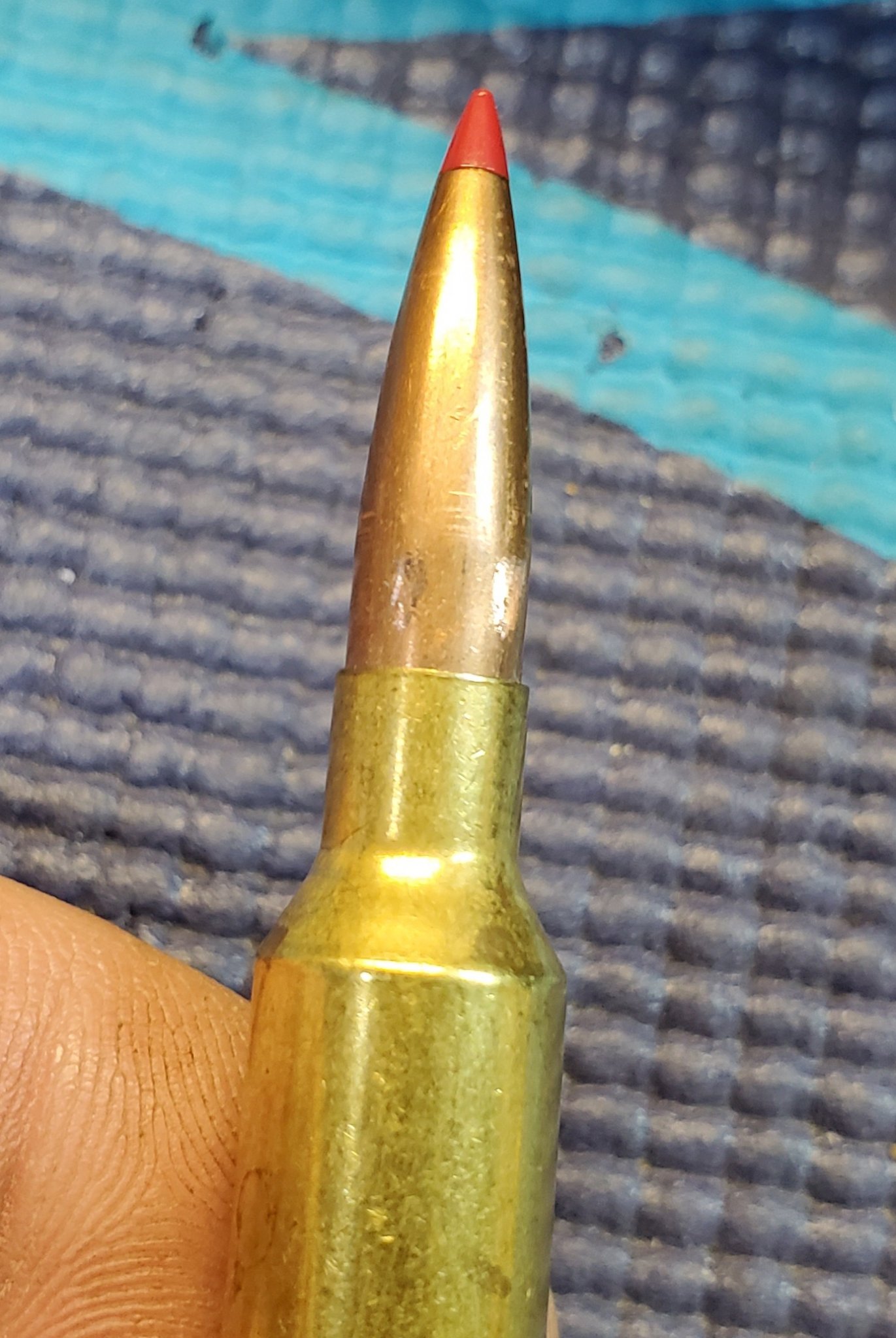

As far as the chamber, you would have to ask the well known Smith on here who i got the prefit from. I'm not saying I was perfect at finding the lands as it was a pain keeping the bolt head pin in place on my Nucleus while doing it, but here is a picture of a factory Hornady 140eldm round from it.
Is it sticky on extraction or pushing the bullet back?
I've not noticed it ever being hard to insert or extract a round nor have I ever measured a new round verses inserting and ejecting to see if ita pushing the bullet in deeper. Maybe I just assumed since it was leaving rifling marks on the bullet that its was being jambed.
Here is a photo of a comparison of what I came up with of a factory round on left versus my no touching the lands on the right. Maybe I should go back and do it again as I have a the new generation extractor for my nucleus that doesn't rub on the receiver like the old one did when I did this. I was doing it per the wheeler video but it was a pain trying to keep the pin and bolt head in place and may be the extractor was making it feel like it was still engaged into the lands??

was it cut with a saami .199 fb reamer?
if your barrel is cleaned well and thats supposed to be saami spec, it looks like a chamber was cut with a worn/slightly undersize freebore section on the reamer...it shouldnt leave those marks or touch that deep

So the left cartridge hits the lands aproxamatly. 100 thousands before the right cartridge and they both chamber?
The chamber bolt face to lands lets say is a fixed measurement (less 2500 rounds).
So one of the rounds is jambing .100 thousands?
Wow
Agree 100% with @morganlamprecht
Lands on my rifles leave sets of "teeth marks" evenly spaced not circular mark.
The circular marks are not the marks im referring to in referencing jambing . It is the marks on the picture on post #4. The higher circle mark on the tall cartridge is from me turning my seating stem down on the bullet to get a starting seating reference and the lower circle is from spinning the round in my forster compararor. Yes the long round id factory Hornady 140s with plenty of room in my non binder mag.

I can not distinguish any landmarks on any of the 3 bullets.

It looked disproportionately long amount of bearing surface outside of cartridge
for some reason to me.

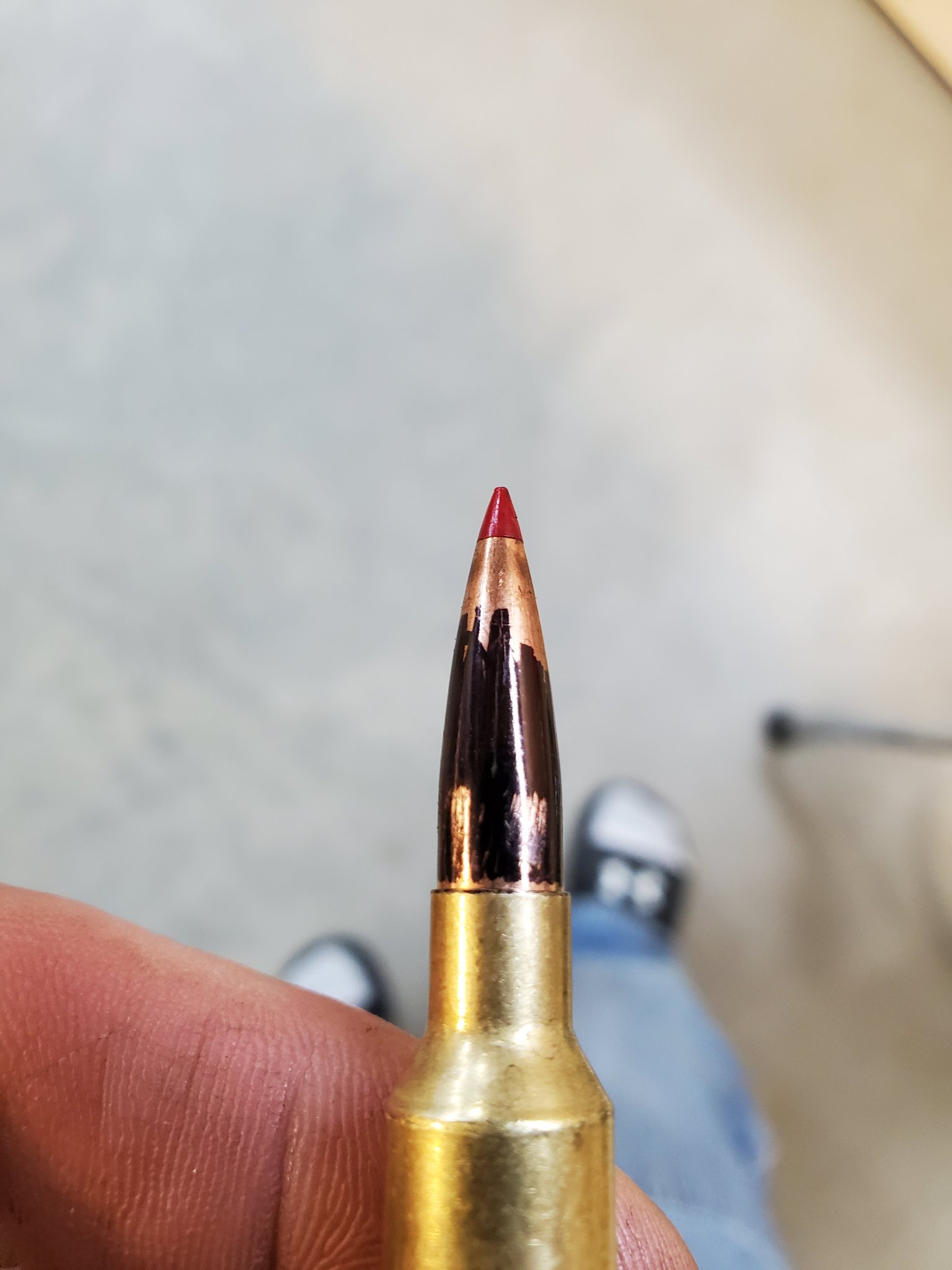

It has been awhile since I have ran factory ammo and I guess I was wrong. It isn't really hard to close but there is a slight resistance closing the bolt. When I opened it I did have to smack the handle to the rear to get it to open. Here is the round. It is definitely jambing on factory Hornady 140eldms. Left 5 nice marks and no marker necessary to see them.
