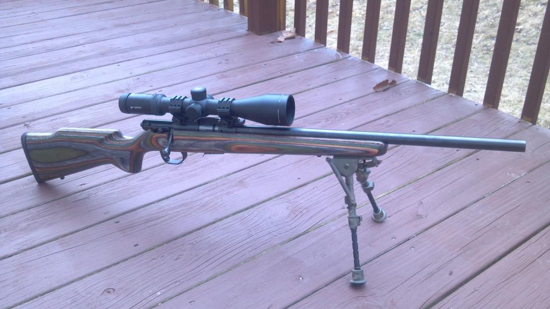

seriously, lose the tupperware, spend the money, get a real stock.
I have a boyd's tacticool as well, just didn't like the feel of the gun in the field with that stock on it (way too bulky for my purposes) which is why I thought about tweaking the factory stock.
