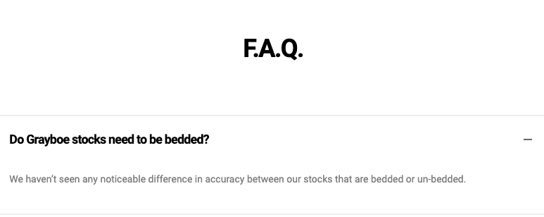

I run mine in a chassis without bedding...but here is a screenshot from Grayboe FAQ:
