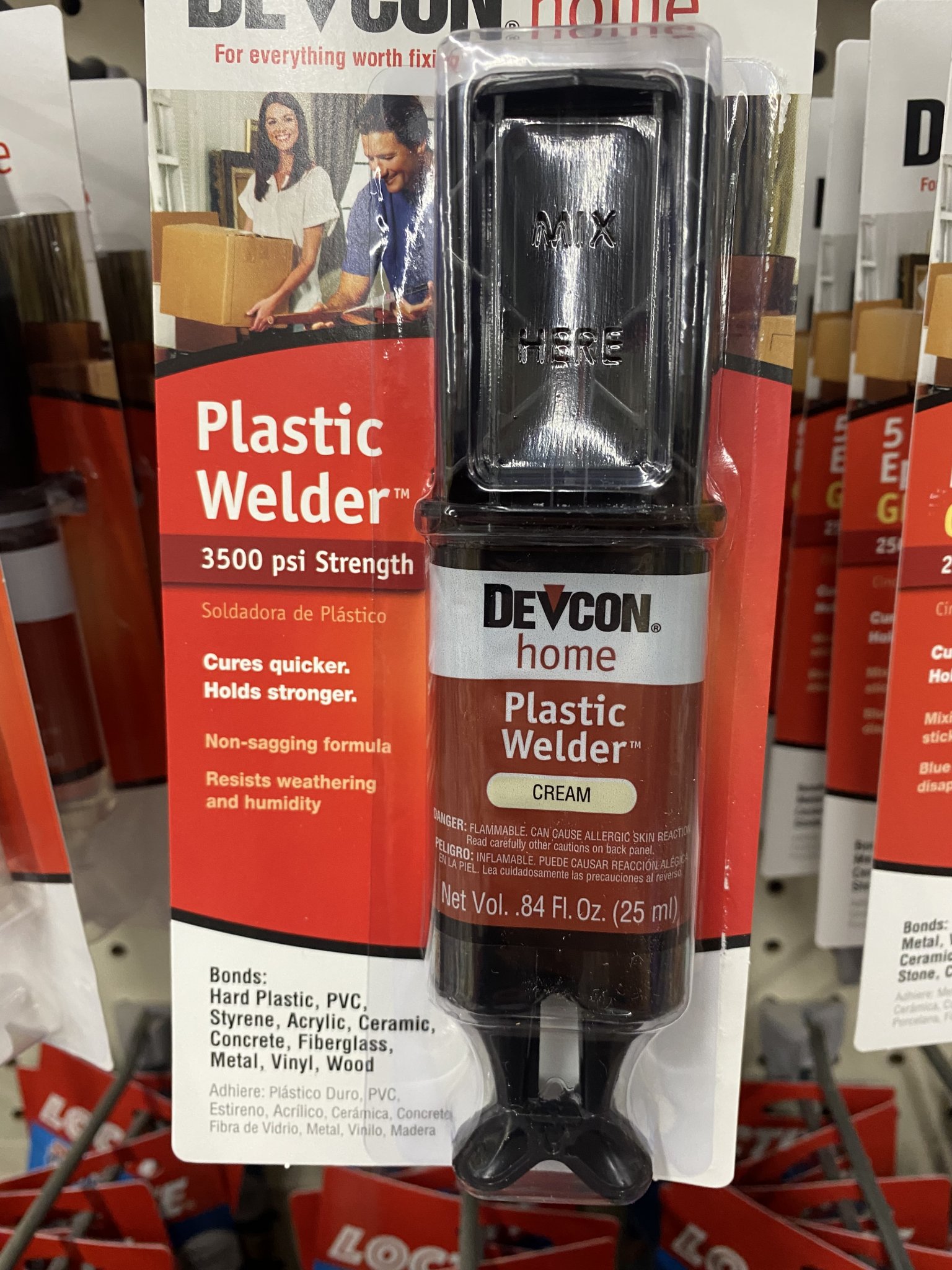

Just left my local Ace and picked this up. I know through research that Devcon makes multiple epoxies that are popular choices for bedding rifle actions. Anyone tried this stuff? I have an aftermarket composite stock on the way, but I may try this on the OEM stock just to give it a go and it would be good practice since this will be my first time completing this task. For 5 bucks it’s work seeing the results anyway. Thoughts?
Edit: I’m an idiot and not photographed and purchased the wrong one. I’ll have to go back and get the right one.
I've had good success with JBWeld putty. It's in a clear tube off white on 1 end and dk gray on the other. They make different strengths/hardiness. I also use HEAVY motor oil for the release agent. I used 2 small lengths of lamp threaded tube for the pillar bedding. I contoured the tube to the bottom of the action before I started the job. It's easy to forget. Just ask me.

No I ddidn't take pics. It's not pretty and I due to health I haven't been able to shoot it in the past few years. When it was finished it was a 1 hole wonder at 100 yards. I know tthat's not far but it was preeffy much round not oval. It's in the safe. If I get some help getting it out, I'll try to get pics. I'm still learning that too.
