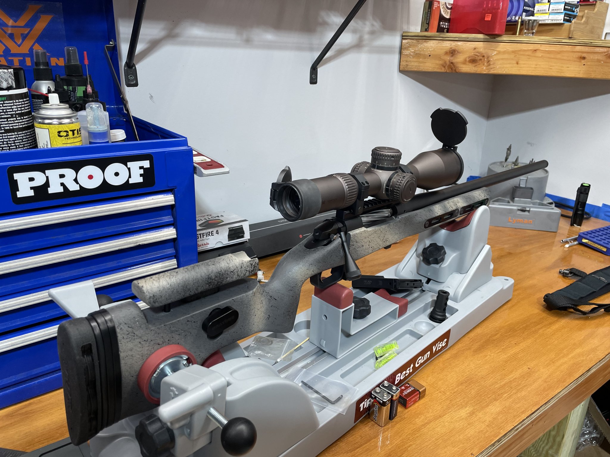

Ffs.
So, after 2 fucking years, Bergara as a company hasn't learned shit or attempted to fix a known issue.
Damn, It's not like we're talking about an automobile, with ten thousand parts.
I mean, how many fucking things need to be tightened on a BA rifle, 5?, and I'd argue that the barrel is the single most important part that needs to be tightened correctly.
Yeah, I incorrectly assumed a quality check had to have been in place after reading about the issues before ordering. Either that or I got old stock. It has a limbsaver pad on it which I haven’t seen in pictures, but then again there really isn’t a lot out there on this rifle.
My brain was telling me to just build a custom, but the likelihood of getting it done before hunting season was slim so I decided to go with one that checked my boxes. Learning lessons every day! Sucks because I had it all setup too.

The only experience I have ever had was with a Bergara Premier HMR Pro in 308. The rifle was great. My only problem was the cheek riser didn't go high enough for my scope. I eventually put it in a MDT LSS XL Gen 2 chassis. I seriously doubt anyone could tell the difference between that barrel and a custom barrel just by looking down the bore with a scope. They are that good! The action was really smooth, also. But you have to remember, the Premier series are finished up in Georgia by ex USMC armorers. At least, that's what they used to say.
Reactions: FNG1001
I just scoped it before boxing it up and it does look decent, not like my proof barrels, but for a factory rifle it was acceptable.
Outside of the barrel loose I checked over everything and it was good. So hopefully they turn it around in a few weeks and I’m off on my merry way.

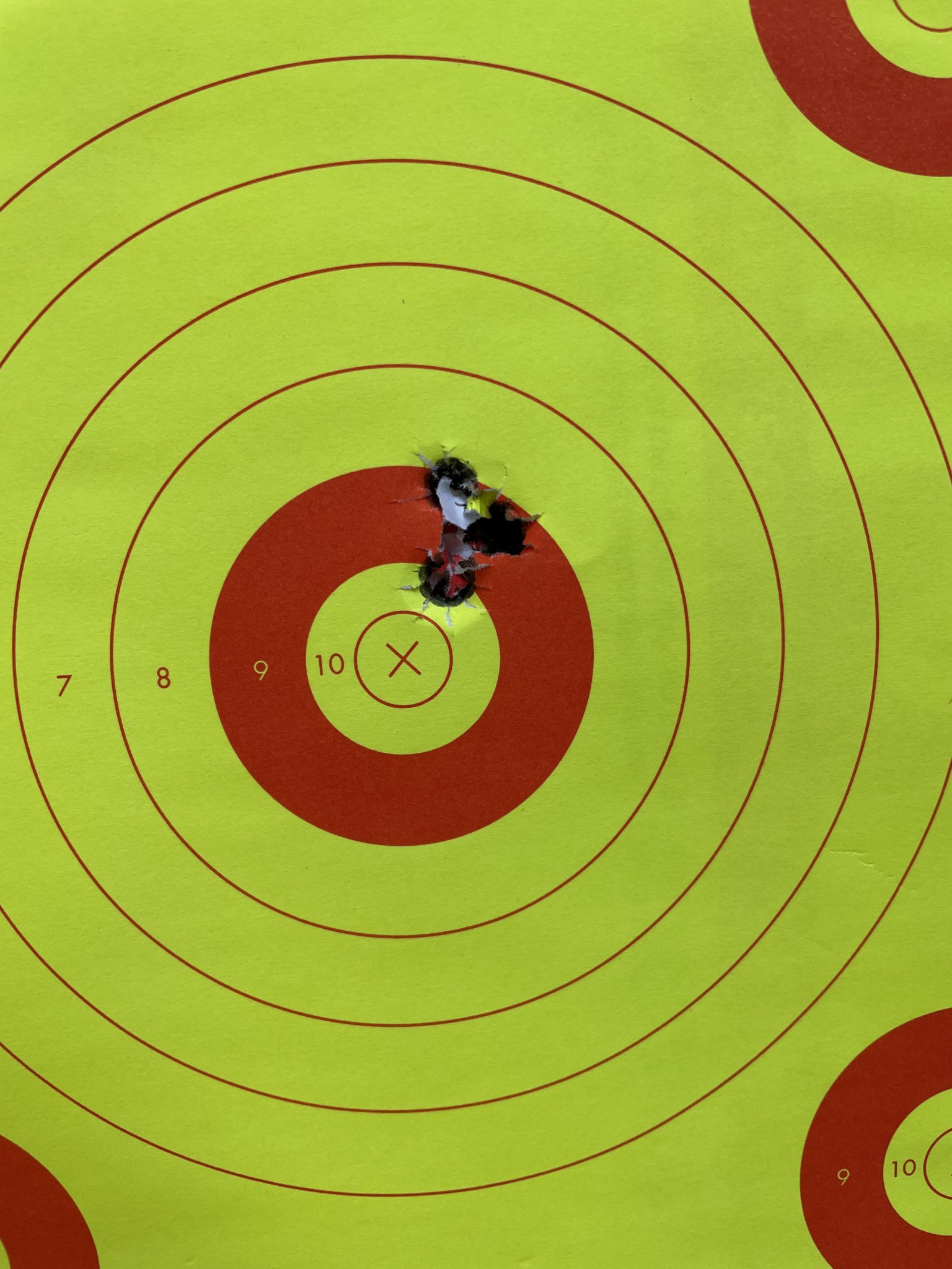

She’s looking promising! I had a few min after bush hogging and setup a target at 100. This was with factory hornady 225g eld match. Really was just zeroing the scope to get ready for hand loads. It was 92° so I was sitting any longer than I had to!
