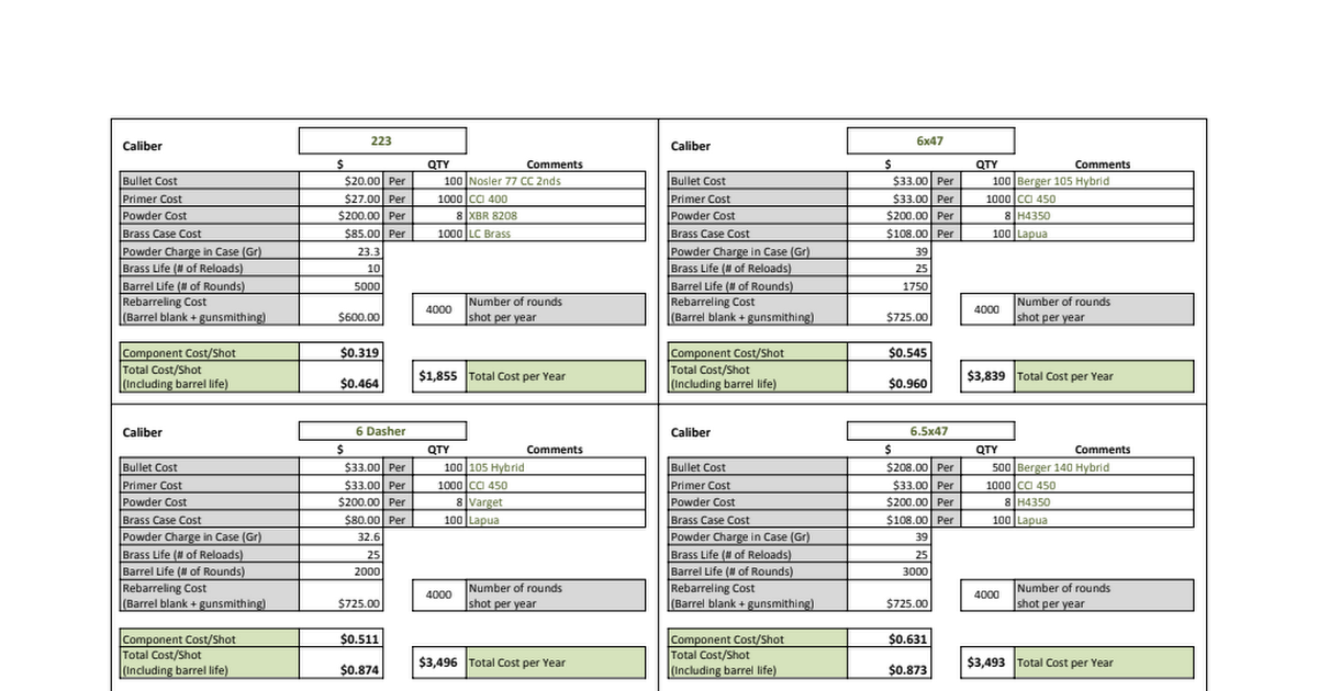

My .260 is my LR precision rifle, and does very nicely for closer applications. But it's also a bit to expensive to shoot (especially in terms of bore wear. It has a Lothar-Walther custom 28" barrel) for training.
I use the .223 for training because it has better numbers for ammo cost and bore wear, and it does not need to be a spendy custom rifle. I have taken a basic Savage varmint rifle, replaced the stock, and added some less expensive optics that have held up very well over the years.
I handload for both, but not because of cost. It costs just as much to load up precisely accurate ammunition as it does to just slap the same components together and simply hope for the best, which is a lot like what happens when one sticks with factory ammunition. The good factory stuff costs more, which is why I handload. I can afford accuracy better when I control the component costs and the load recipes.
The downside is the amount of ammunition assembly time. I skip some of the more time consuming tricks, settle for some minor reduction in accuracy, and live with the compromise.
I shoot mostly (of course) the .223, for the bulk of my training. I had been doing this with .22LR,. but that got costlier, and shortages occurred more frequently. These factors made the .223 into more of a bargain.
For me, training is not about pursuing tiny groups. It's about shooting a lot, finding consistency, then using that to reduce the group sizes, but maintaining that consistency. The target is important, but its best value comes from displaying improvement, plateauing, and/or degradation of overall performance. You do that, and the rest gets easier.

I've got two rigs, one lives 90% of the time as a 223 trainer and the other does match duty with many different barrels. Re-zeroing on a shouldered barrel is super easy, 3 to 5 rounds at most since the offset is so predictable. Swap twice a month and that's still only like 100 rounds a year, basically nothing. I do a lot of barrel swapping but agree that having a second dedicated rifle is super handy.
Depreciation on a full build, I'll use my 223 trainer as an example. I bought it as parts, and if I sold it I would part it out as well.
Bighorn TL3, paid $1250, worth $1100 (dep $150)
MPA Chassis, paid $875, worth $650 (dep $225)
TT Diamond, paid $275, worth $225 (dep $50)
ARC Rings (used), paid $125, worth $125
Harris bipod arca kit, paid $200, worth $140 (dep $60)
Area 419 Brake, paid $165, worth $125 (dep $40)
S+B PM II scope (used), paid $2k, worth $2k
So that's $525 in depreciation. Go out a few years from now, figure another $200 or $300 maybe? It's not going to get much worse over time in the near term no matter how many rounds I put through it.
As far as cost/shot, you really need to figure in all the consumables. Brass has a finite life span, as do barrels. Each trigger pull costs you money in using up those consumables. That's why I say that cost per shot difference is about $0.40 between 223 and 6mm. Take a look at this spreadsheet in the link below and mess around with whatever assumptions you want to input about brass life, barrel life, cost of rebarreling, etc.
While I don't have current info for my loads on there, I can tell you that my 223 trainer rounds with my current components cost me $0.33/shot and my match loads with current components cost me about $0.80/shot. At that price difference, I would have spent $2,350 more in the last 12 months had I shot the 5k rounds in my match rifle rather than my 223 trainer.
Again, you're assuming zero scope depreciation (not realistic over any appreciable amount of time). Think if you'd bought the S&B 5 years ago and are trying to sell it now - you'd take a really harsh beating. Or if you'd bought a Razor Gen 2 last year, or a TT Gen2XR, kahles 624, or anything else that gets dated in an industry where things are constantly improving and changing. That's kind of a micro-cosm of the entire argument - you paint everything in rose-colored glasses and try to justify things with tainted information - use realistic inputs and your output will be much more accurate and meaningful.
You're also assuming really expensive bullets for your match rifle and cheap ones for your trainer. Is that good training? You're also assuming component depreciation that's under-stated I believe, but I'm not going to nickel and dime your argument because the point is that the payback is way, way out there unless you shoot a ton of rounds. This guy has 100-yard access now and out to 1,000 eventually and doesn't sound like 10k rounds is in his immediate future. Even if it was, you'd have to be intentionally shooting expensive components in your match rifle in order to make up that cost. Compare 140 ELD-M versus 75 ELD-M and run the numbers for me.
I run Hornady brass, H-4350, 210M, and 140 ELD-M in my 6.5 with 1/2 MOA accuracy and single-digit SD. When I had my 223, I ran 75 ELD-M, Varget, Federal brass, and CCI primers. 1/2 MOA accuracy and SD a little worse than the 6.5. 12 cents a round difference. I think you're just paying too much for your match ammo...
Thats what happens when you shoot bergers and are a national level competitor, stuff just costs more.

Where are you getting .20 hornady /sierr/nosler bullets?
Hornady blems at midsouth https://www.midsouthshooterssupply.com/dept/reloading/rifle-bullets?brand=oem-blem-bullets
Nosler blems http://www.shootersproshop.com/nosler-products/nosler-blemished-2nds/nosler-blemished-bullets.html
Sierra blems are only sold at the factory from my understanding.
Then there is midway which seems like sometimes its a bit of all of them with no real way to tell as its stock images and not necessarily exactly what youre getting. https://www.midwayusa.com/factory-second-bullets/b?bid=2998
