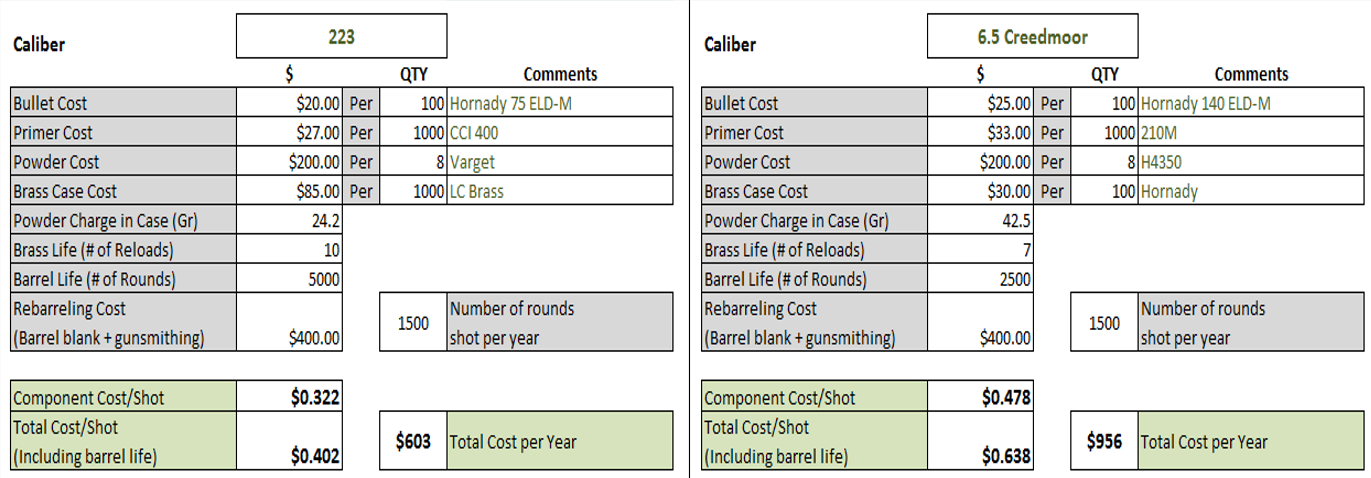

Again, you're assuming zero scope depreciation (not realistic over any appreciable amount of time). Think if you'd bought the S&B 5 years ago and are trying to sell it now - you'd take a really harsh beating. Or if you'd bought a Razor Gen 2 last year, or a TT Gen2XR, kahles 624, or anything else that gets dated in an industry where things are constantly improving and changing. That's kind of a micro-cosm of the entire argument - you paint everything in rose-colored glasses and try to justify things with tainted information - use realistic inputs and your output will be much more accurate and meaningful.
You're also assuming really expensive bullets for your match rifle and cheap ones for your trainer. Is that good training? You're also assuming component depreciation that's under-stated I believe, but I'm not going to nickel and dime your argument because the point is that the payback is way, way out there unless you shoot a ton of rounds. This guy has 100-yard access now and out to 1,000 eventually and doesn't sound like 10k rounds is in his immediate future. Even if it was, you'd have to be intentionally shooting expensive components in your match rifle in order to make up that cost. Compare 140 ELD-M versus 75 ELD-M and run the numbers for me.
I run Hornady brass, H-4350, 210M, and 140 ELD-M in my 6.5 with 1/2 MOA accuracy and single-digit SD. When I had my 223, I ran 75 ELD-M, Varget, Federal brass, and CCI primers. 1/2 MOA accuracy and SD a little worse than the 6.5. 12 cents a round difference. I think you're just paying too much for your match ammo...
Okay, take away the rose colored glasses. Double the depreciation and call my costs $1k. It still has a fairly reasonable break even at 2k or 2500 rounds. That's not crazy at all. Regardless, I've gone through a half dozen different high end scopes, made good reasonable purchases and haven't taken a bath on any of them.
Using your exact component recommendations listed above, which I would characterize as cheap for match ammo and expensive for trainer ammo, the cost differential is still $0.30 per shot. You're ignoring the barrel life difference and brass life and brass cost difference in your assumptions. Take all your costs, however long you think your brass and barrel will last you, and how much you pay for a barrel job, and plug them in that spreadsheet. It's meant to be a calculator where you can figure out your own costs. It will tell you how much you are paying per shot for components, and per shot once you include barrel life. It will also give you a cost/year based on how much you think you will be shooting.
As a side note, I think my match ammo is pretty cheap. Lapua 6BR brass, 105 hybrids at a good bulk price, etc. That $0.80/round includes brass life and includes barrel life.
My point isn't that the OP should shoot as much as I do or that everyone should have a 223 trainer. I'm just advocating for realistic assessment of what a second rifle costs you (depreciation) and for how much the TOTAL cost of shooting really is per shot (brass wear, barrel wear, everything).

you can lead a horse to water but you can't make him do a simple spreadsheet
he must get his brass and barrels for free

I can't view your spreadsheet at work - I work for a defense contractor and google docs is firewalled.
I do agree that barrel cost should be considered, but that's variable depending on what his larger caliber is. 6.5 CM barrel life is still pretty good. And again, that's where my comment of "a lot of rounds" as the payback point came into play. I think for folks just getting into precision shooting, even 2,500 rounds is a lot. 10k is a ton. It's all about perspective.
As to your match ammo, you've got high-end brass and high-end bullets being compared to low-end brass and mid-level bullets for your 223. My point was that for a beginner shooter, that comparison isn't all that valid. Maybe your ammo is cheap for national level competitions, but for those of us going to the range once a weekend or every other weekend or twice a month during our lunch breaks, there's no reason to have Lapua and Bergers for a 6.5 if we're willing to have Hornady brass/bullets for the "trainer". Obviously in your situation a trainer makes sense. But your situation compared to the OP are very different.
I will concede your point that the resale value of a trainer significantly reduces the payback point. It's just a decision the OP will have to make about how much he plans to shoot and what his tolerance is for having that money tied up in a 2nd rig for an extended period of time. Neither is a terrible option, but you really do have to shoot a bunch to come out ahead with the 2nd rig if you're using equivalent ammo for each and both are outfitted with similar scopes/accessories/stocks/etc.

Let me re-phrase the question in the only relevant format for this discussion: Why would someone who is on a budget and just getting into precision shooting buy bullets that cost twice as much as ones that perform 98% as well. The last 2% matters for national level competitors. For the rest of us, it's a complete non-issue. And if you're using ammo cost to justify a separate rifle, then picking the most expensive ammo for a beginner rifle shooter just doesn't make sense.
Lapua brass and berger bullets is very very very common. for EVERY level of shooter. if i were new and going 6/6.5 Creed i'd be buying 400 rounds of Berger ammo anyways. free Lapua brass.
and the reason to use lesser stuff on a trainer is exactly that. its a 223 TRAINER. for 3-600y. loaded on a full progressive press. not that there's even much of a cost difference in brass/bullets on a 223
he never said he's on a budget. but we're just doing the math comparison of 223 trainer on same action/chassis/scope versus a separate dedicated 22, which unless it's a vudoo there will be sacrifices on the trigger/chassis/action, not to mention doubling a lot of costs versus a $600 barrel and $125 bolthead
knowing the ranges he's going to be shooting on (it is my league after all) he could very easily get away with shooting the 223 a lot of the time and saving the 6/6.5 for the other matches where we stretch it out far
the whole point of a 223 trainer comes when you're running a Bighorn/etc. barrel swap. zero on lunch break. done. easy as pie.
You should check it out when you get home, it's a super handy resource. Here's a quick screenshot of what it looks like. You fill in the fields and it does the math for you. The full spreadsheet has space to compare 4 calibers at once.
Going back to the OP and what he should do... right now he's talking about a single TL3 with two barrels. That forces him to tie up a bit of money in a second barrel (again a consumable so it's just more inventory on hand, not necessarily a "cost") and a few accessories for a second caliber (mags, dies, bolt head, a few reloading accessories). Call that $200 in actual costs and he's gonna break even super quick, even if he only shoots a little bit.
Besides, I'd much rather shoot a 223 at 100 yards than a 6 or 6.5. Heck, my original recommendation was that he buy a Vudoo and only shoot 22LR. :)

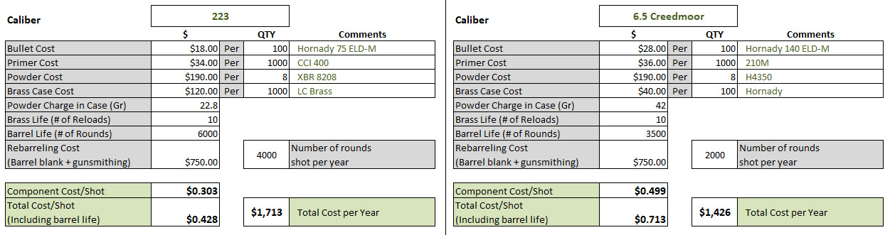

ETA: here is the spreadsheet with my 6.5 reloads and my 223 reloads in it:

Those of you worried about depreciation and resale are in the wrong hobby. Don't buy guns because of monetary value, get what suits the need.
I get that some of you are gear whores who needed the latest greatest every week. That's not how you grow and get consistent.
Or maybe I'm the weird one because I've never sold a gun? I don't actually know that anybody I shoot with sells guns, we just keep buying more. (Everyone needs 5 prairie dog rifles, 10 "deer" rifles, a few elk rifles, 5-6 target rifles, 6+ shotguns, and a pile of pistols, right? Or is that just a montanan thing?)
For what it's worth those compasses shoot way above their price range. They will have almost zero "trade in" value, but who would sell one? Just keep shooting!
Those of you worried about depreciation and resale are in the wrong hobby. I get that some of you are gear whores who needed the latest greatest every week. That's not how you grow and get consistent.
Big difference between "worried about' and "making informed decisions". Not in this hobby to collect guns, I'm here to shoot, improve and compete and that costs a lot. Don't get me started on match entry fees, plane tickets, gas, rental cars and hotels. That can dwarf the cost of which caliber you shoot. This past two weeks alone I bought another 223 blank for the next trainer barrel, and paid match fees and plane tickets to travel to CO for a match next month, plus match fees for a local match this weekend that's a 4 hour drive away... and still need to decide if I'm getting a hotel for that one or if I'm getting up at 3am to drive there.
The real reason I shoot a 223 trainer is so I can load ammo on a progressive press as fast as possible, and so I can treat the trainer rifle like a redheaded step child and not worry about screwing up my match barrel. I shot ~100 rounds off a barricade after work today in crappy wind conditions and got the barrel good and hot. Still need to load another couple hundred rounds of 223 tonight so I've got something to shoot next week.
How to grow and get consistent? Shoot with and against people who are better than you, attend as many matches as you can, and send lots of rounds downrange in focused practice working on your weaknesses.
Sorry for the rant, but don't assume just because I used the word "depreciation" that this is some gear fondling fest...

Build a .223 rifle with a TL-3 action, KRG Bravo chassis, trigger of your choice, ARC M10 rings and a good optic.
When you out grow the .223, get a 6mm/6.5mm barrel of your choice and a bolt head and get after it. You can do a lot with a .223, including 1,000+ yard shooting.
Alternatively, you can build something similar to the above but in a 6BR/6BRA. Low recoil, Lazer beam accurate so it's fun to shoot at 100 yards, can easily go 1,000+ yards for a training class. I think a 6BR would be a great all-around cartridge.
What I did for my wife, was build her a 6BRA rifle. I wanted to build her a good all-around rifle that had low recoil, great accuracy, and was a very capable rifle at most any distance (short of ELR). It ended up being a Lone Peak Fuzion action, KRG Bravo chassis, BnA Tacsport trigger, ARC M10 rings and a Steiner M5 scope (which I had laying around).
More rifles is always nice, but I think it would be best to start with one rifle and work with that until you start to learn your preferences for triggers, chassis/stocks, optics and reticles, cartridges, etc. It gets expensive if you have to replace or upgrade two rifles as your needs and wants change versus one.
You can accomplish everything you want to do with one rifle. Plus, I think it's better to have one higher quality rifle than two okay/mid-level factory rifles. The goals you set out for each individual rifle can easily be accomplished by one, I really don't think you would be sacrificing anything by going one rifle over two.
