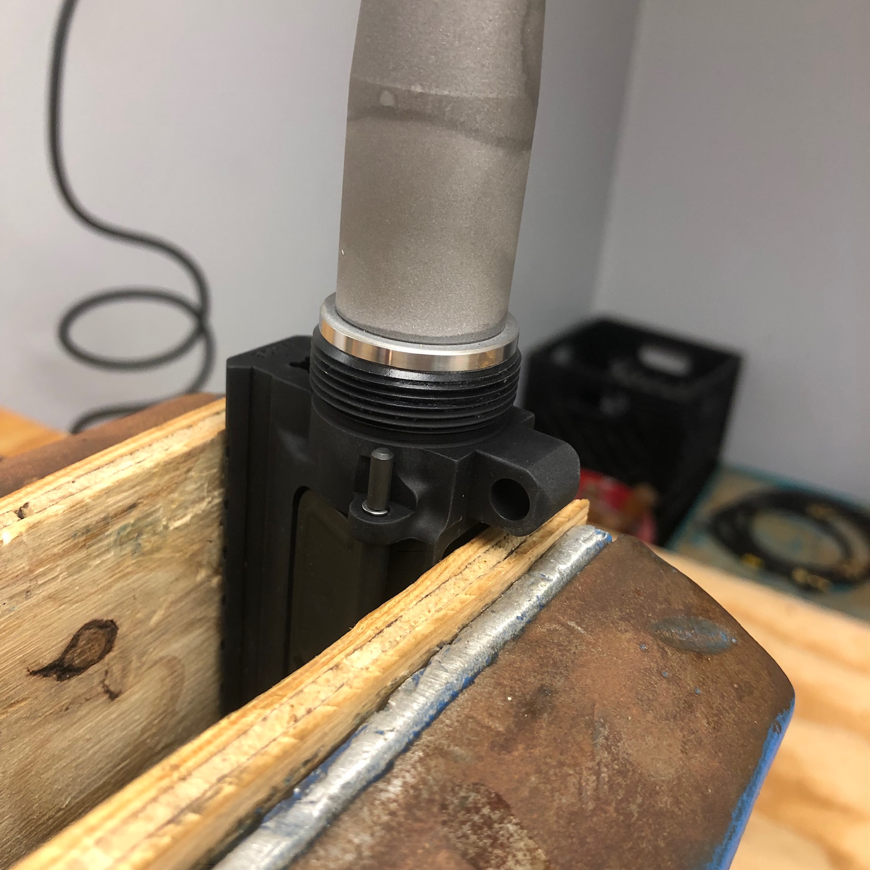

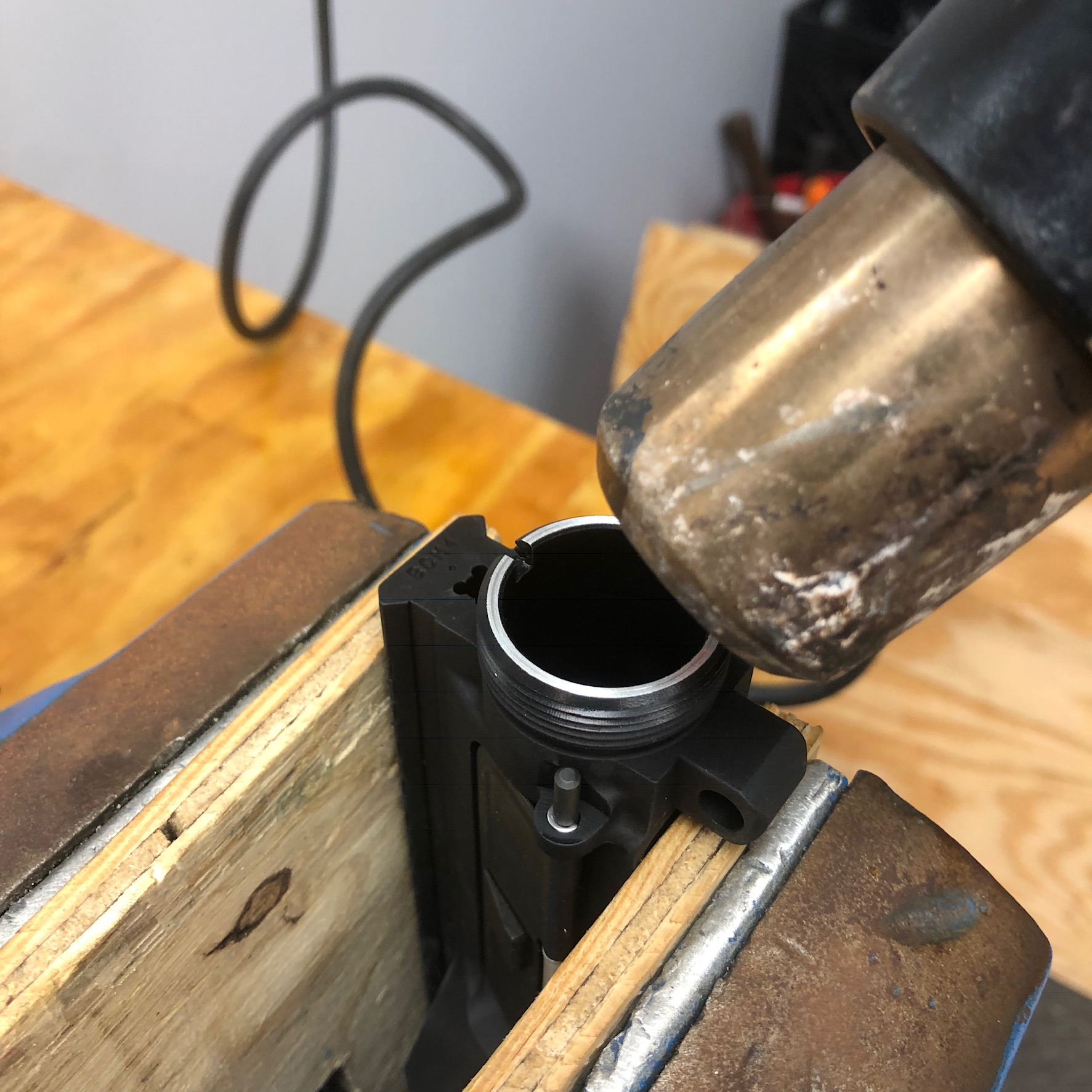

The best way to do it, if you can, take your barrel to the gun store and find which upper it doesn't fit in by hand. That's the one you want, bring it home....
Yep, totally agree on this. I've done 2 ARs. Both with Aero upper receivers. Both times I had to heat the upper in order to get the barrel to fit. That's the kind of fit I want.
And neither of the Aero uppers were "perfect". Both needed a little lapping. Not much, but some. Both rifles turned out great, and are real tack drivers. (At least as much as an AR can be a tack driver).

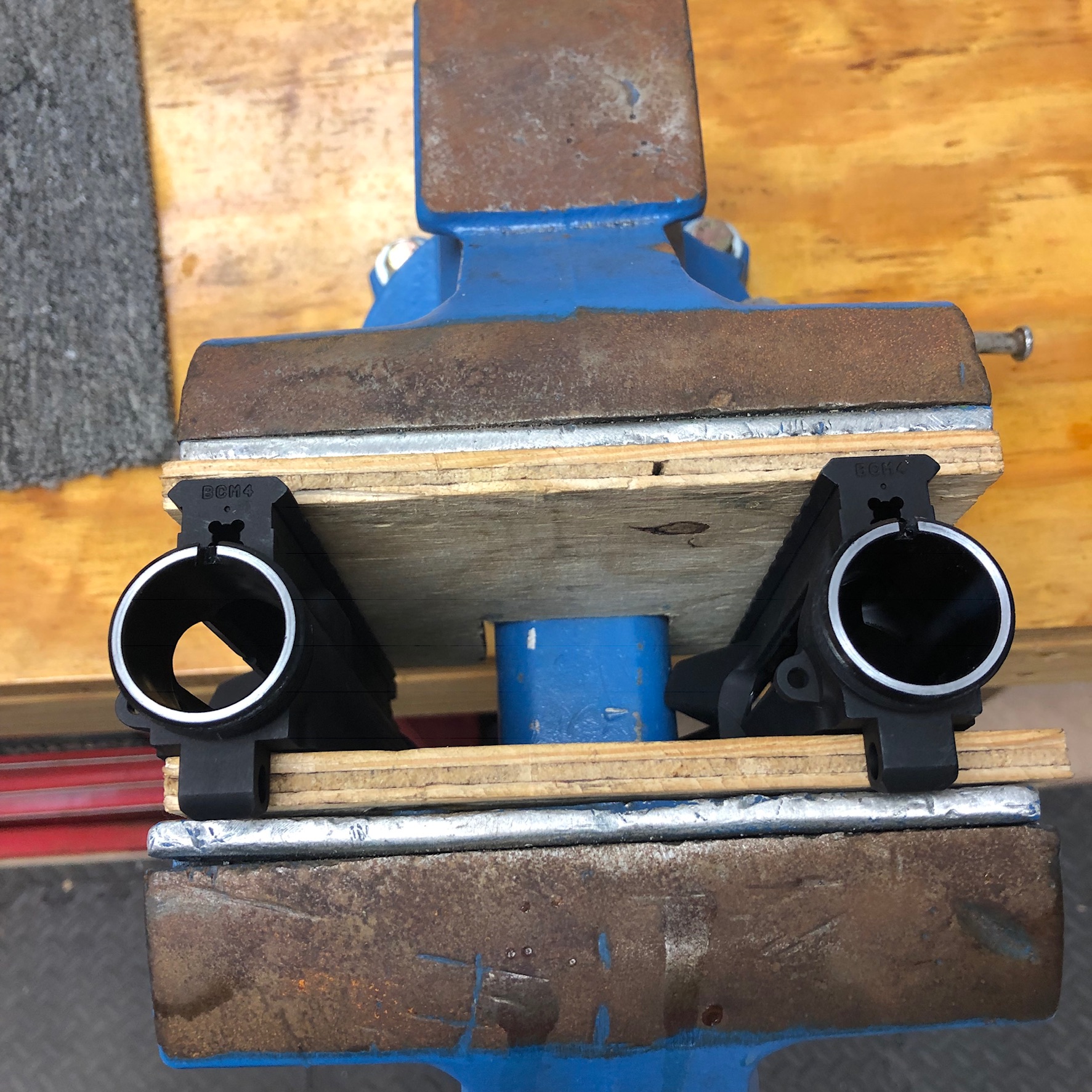

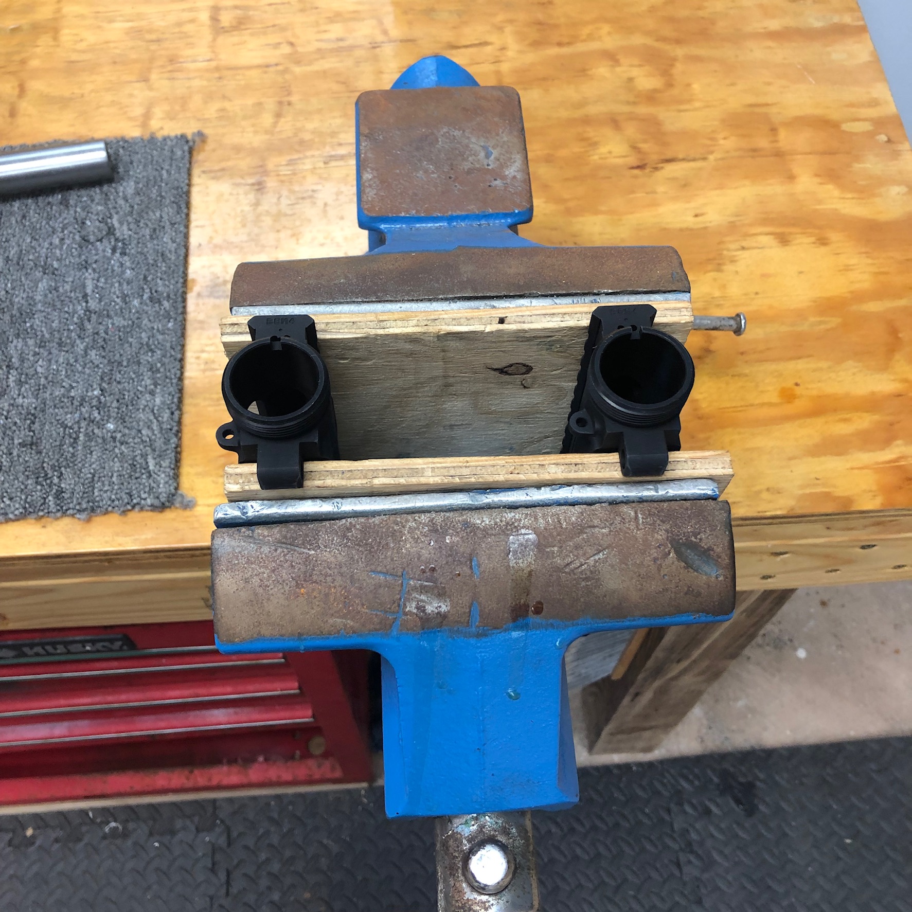

Since this is a thread about receiver lapping - this is the lapping tool I use. It's a Brownells reaction rod with a big nut bored and pressed onto the back end and trued in the lathe. It makes a nice dual purpose tool that way. If you already have a reaction rod, your friendly local machine shop can modify it like this pretty easily.
I can see it if I click on the image.
Cool dual use tool.
How much did the shop charge you to bore, press, and true?
I did the work myself - have a modest machine shop set up at home now and have been machining since the mid 90's, so I make a lot of my own gun parts (like brakes and suppressor mounts, barrels, etc) and tools. I don't know what another shop would charge; my guess is that you'd pay a 1/2 hour minimum flat rate charge. Or find the right guy and bring him some beer? :)
There is a shallow relief cut like you describe, to prevent abrasive acting on the inside of the receiver bore.
