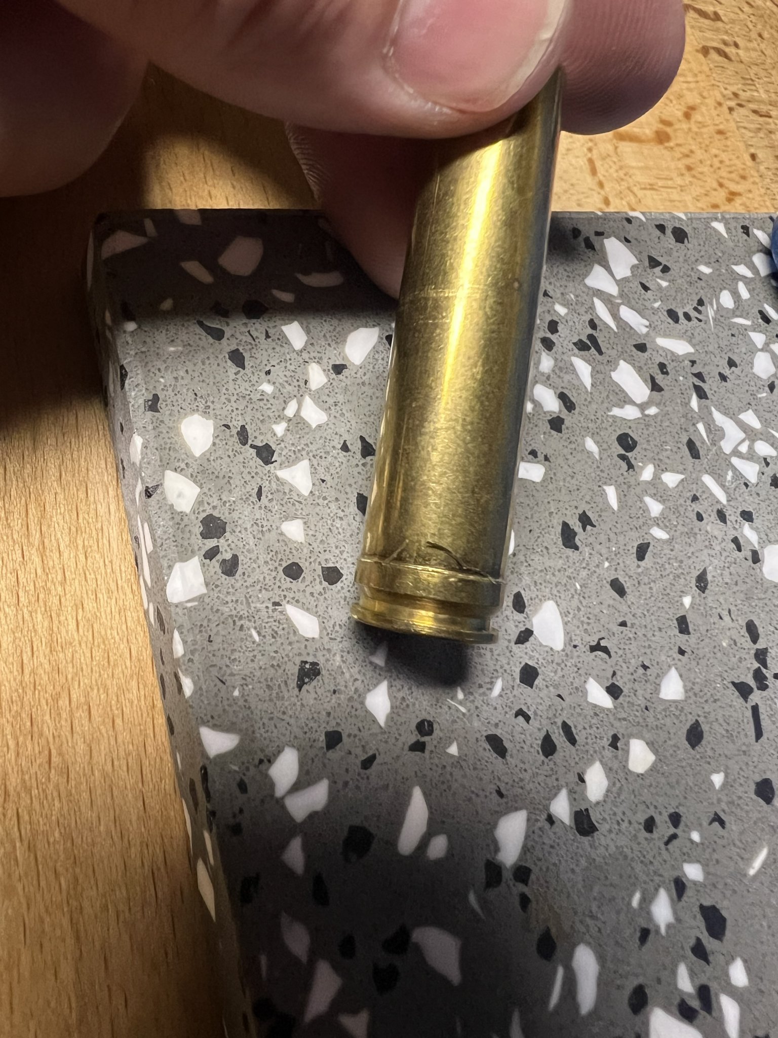

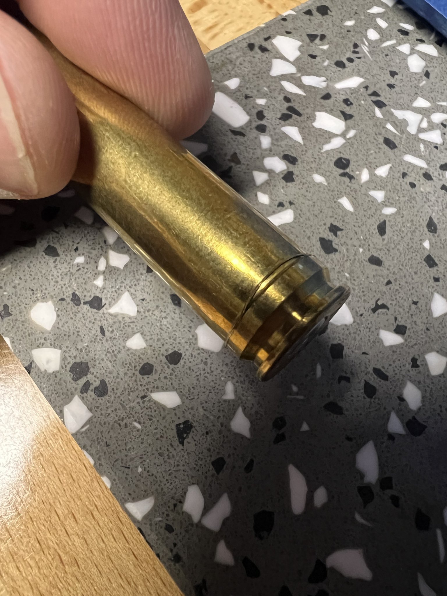

Hey all.
New to reloading belted mags. Haven’t spent much time around them so this may be nothing, but was looking for some input to what it might be and if it’s an issue. Tried the search but didn’t turn up much.
Shot some reloads today in a ladder test. I had a few cases show some wear/damage on the front edge of the belt. It’s like belt developed a bur or lip around the front edge. This occurred in cases with lower charge weights and some higher charge weights.
Federal Brass. It was all FL sized as it had been shot previously in 2 different chambers. This was only the 2nd firing on the brass. I know I don’t want to FL size all the time and over work the brass. Shot from Browning X Bolt.
Thanks much.

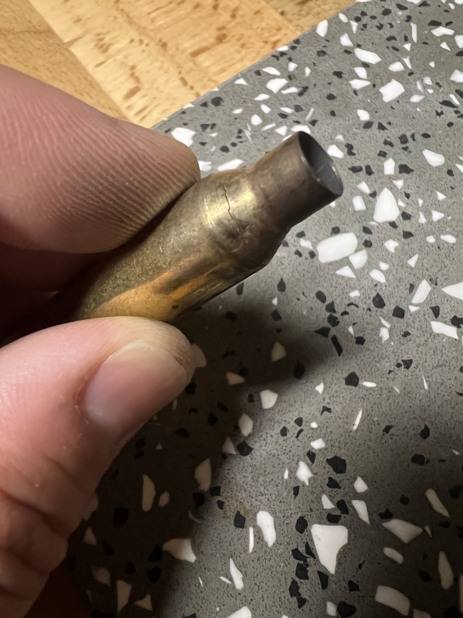

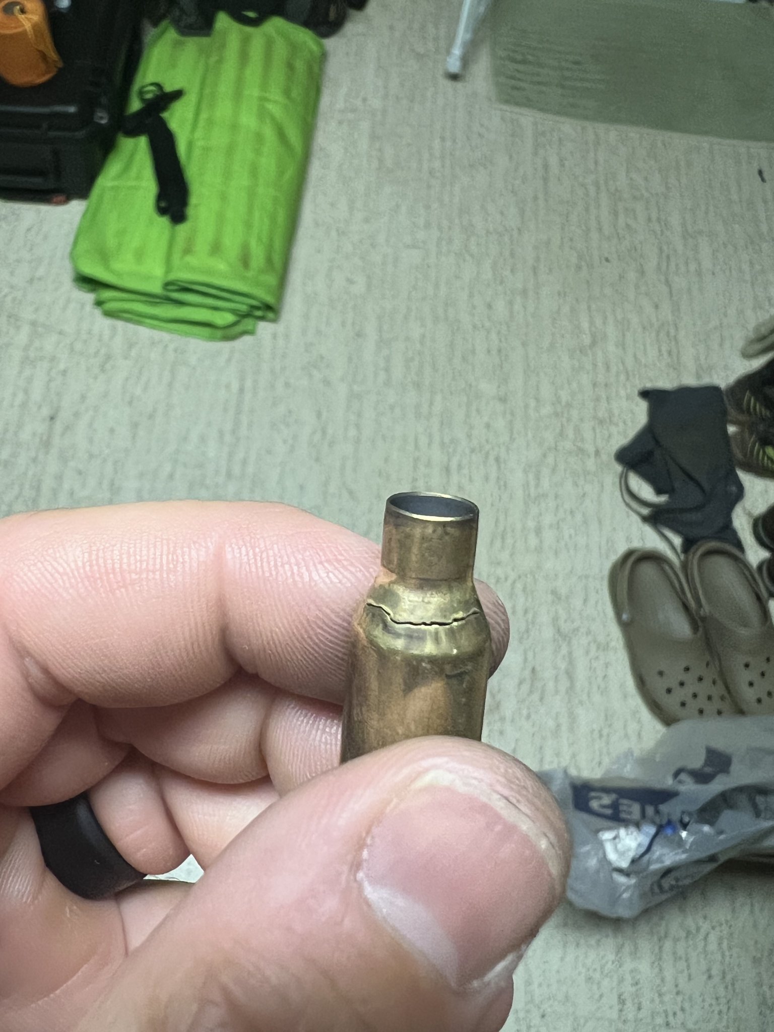

Also. After going back through the brass tonight I noticed 3 cases with a horizontal crack in the shoulder. One of which was from the starting charge and 2 from about 1 grain under book max. Velocity was right on par on the Xero so I’m confident in where I was.
Like I said this batch of brass (when factory loaded) had been shot in 2 different rifles prior to my FL size and reload so maybe these 3 got over worked?

I think the brass is too big for the chamber.
Have your friend measure the brass before sizing and after. Compare those dimensions to the brass fired out of the rifle.
I do all the loading for him. I suggested he buy a lot of brand new brass to start but he wanted to use what he had.
Are you thinking it’s too big for the chamber on the belt end and is causing the shaving on the belt? Or that’s what caused the cracks?
Everything was FL sized. When measured prior to and after sizing with a headspace comp the case head to shoulder moved several thousand back from the smallest piece I had. It was then trimmed, prep and loaded. I know with the FL it won’t change the base diameter and thats what I’m thinking is the issue with some pieces as far as the shaving goes.
That’s what I’m thinking too. The base of the case is too big. The crack in the shoulder is a factory defect.
With the belted mags everything just seems more critical. I’m thinking the ones shaving had first been fired in his other 7mag and the belts just expanded a little more.
Federal brass certainly doesn’t have a reputation for quality. A defect or just bad brass is likely on the shoulder cracks.
Thanks for the input!!!
