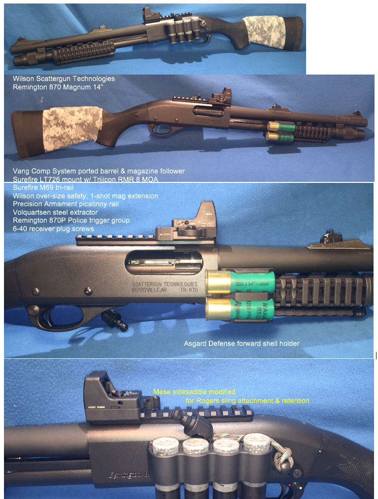

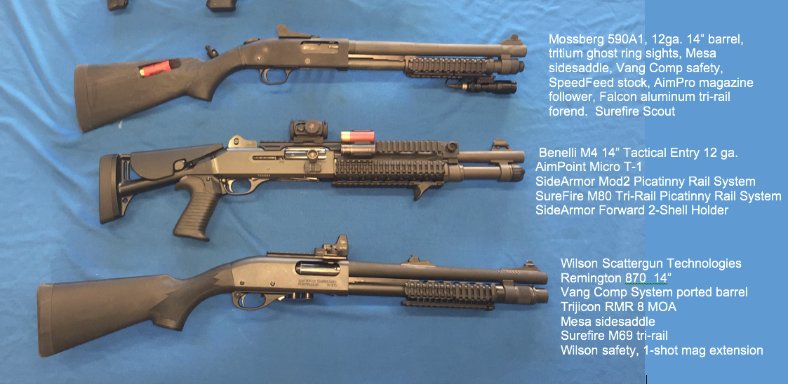

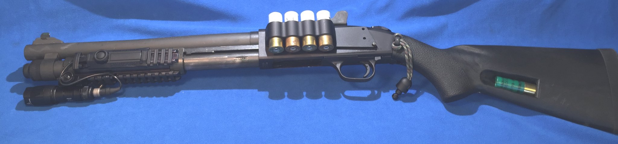

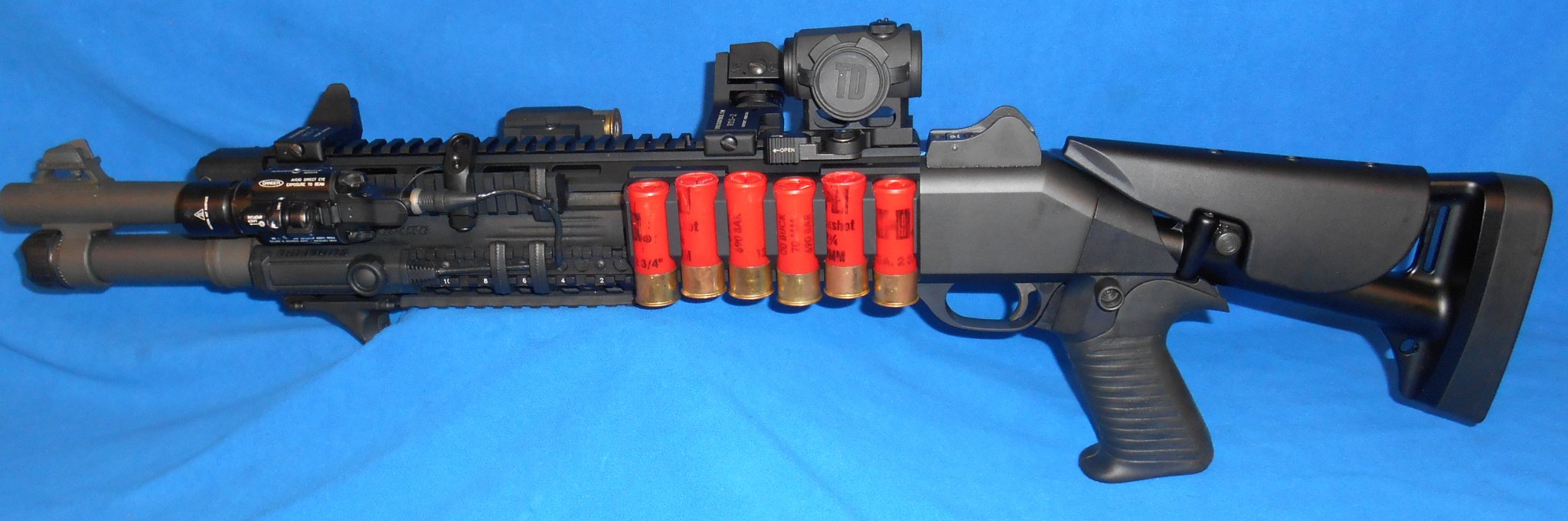

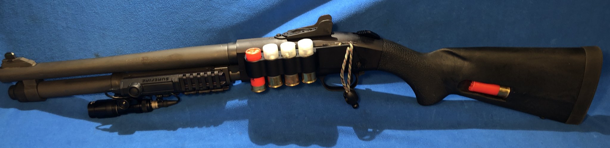

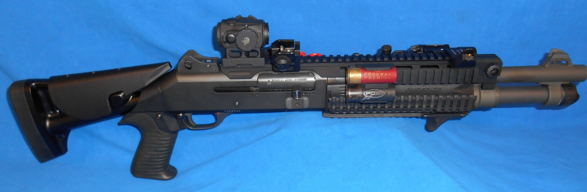

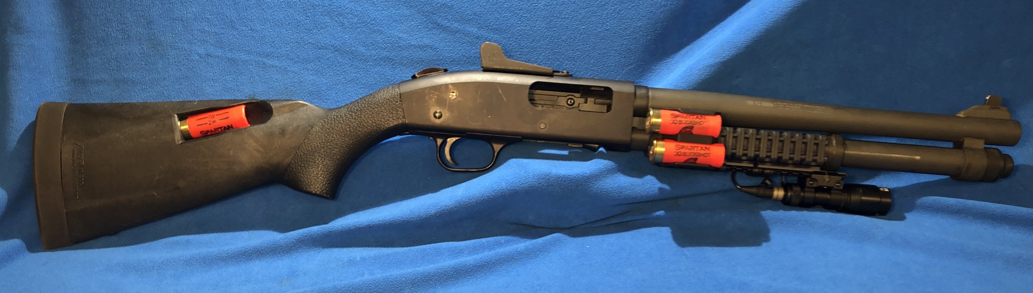

Issues come when you hang shit off the side, especially reciever shell holders, shoot weak side, off barricades or limp wrist them. M4 doesn't have this problem becuase its a gas gun, not inertia driven. M1 M2 and M3's all have the same issues, in addition to 1201FP's.
I like short barrel shotguns. However they are not the "cone of death" out the muzzle many believe them to be; to be effective they have to be well aimed at short distances. This 14" M4 Entry is one of my favorites, but I can almost keep up the down range lead density using a 14" Mossberg 590A1 or 14" Wilson Combat Rem 870. In my opinion a short barrel 5.56 AR is a safer choice for home defense in close civilian quarters as the penetration thru interior drywalls etc is less than a 9 mm. A few of my favorite assemblies; the Aasgard Defense forward shell holders are particularly handy.
IMG_3356Mossberg 590A1 with Asgard Defense Forward Shell Holder Photos copy.JPG
IMG_3347Mossberg 590A1 with Asgard Defense Forward Shell Holder Photos copy.JPG
