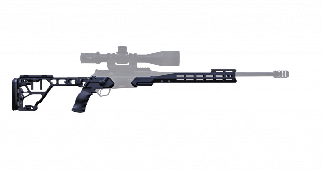

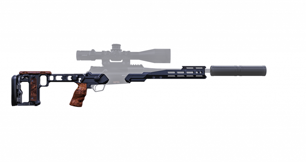

Akila made an upgrade kit for the BRX1 so you can install any AR15 compatible grip or buttstock the also offer the buttstock part separately as well as the foreend part. Here is the link to the full kit:
