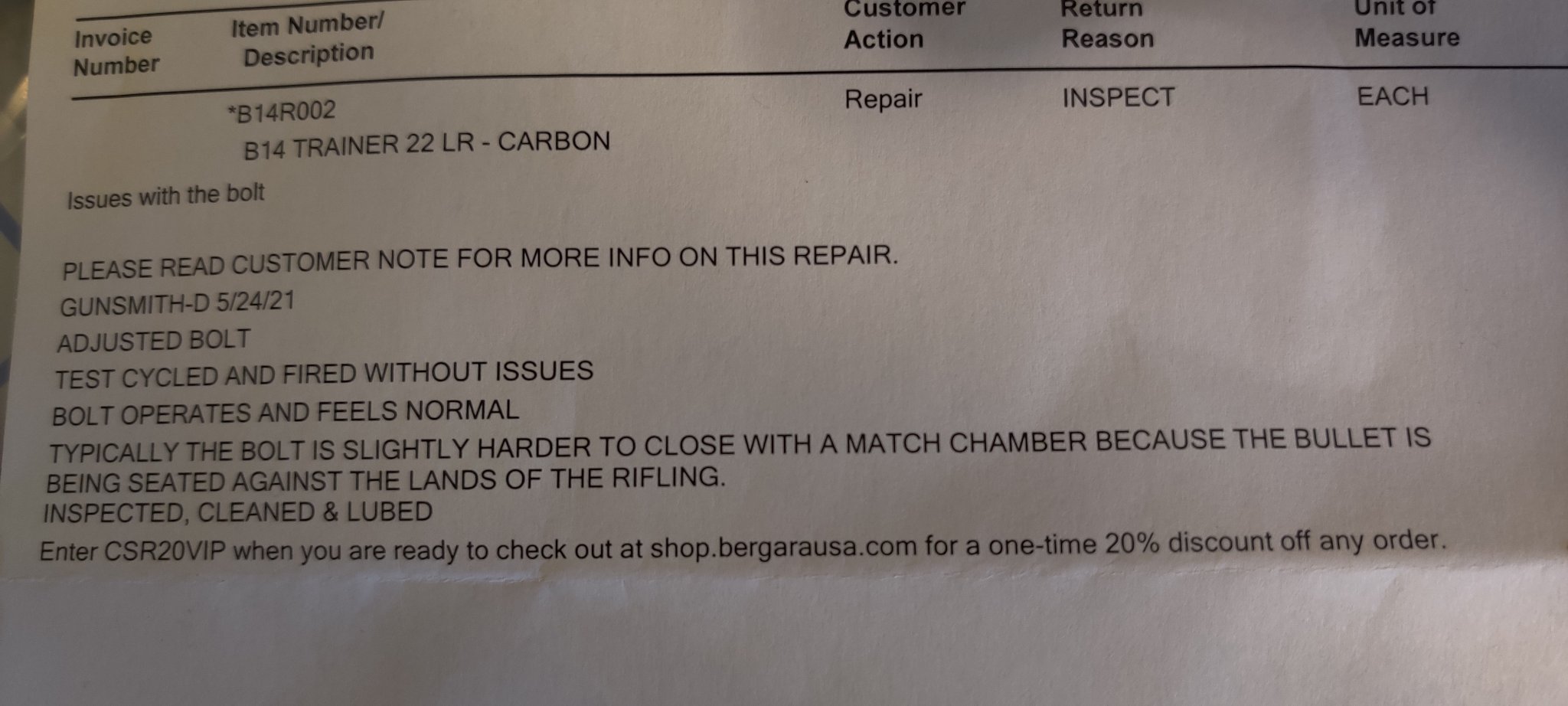

How is your bolt closure doing now? I have a new B14R Carbon, and the bolt is quite hard to close. Noticeable harder (both empty and with a round) than CZ and Tikka 22LRs, and Sako, CZ, and Tikka centerfires.
My bolt closing got easier after 500 or so rounds. Still not as smooth as my well used CZ457.
FYI, I sent my B14 R to Bergara for a hard closing bolt.
Summary is that it just has a harder closing bolt (at least compared to what I'm used to)
See attached.
