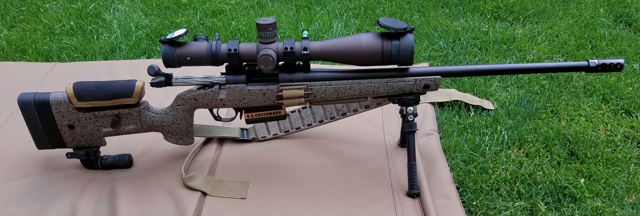

Plus easy 1/4 turn tool free bolt disassembly, the bolt shroud is much more substantial than on the B14, and the fluting is perfect for windy and dusty areas such as here in the Western U.S. Perfect combination with the TriggerTech Special I'm running.
Full disclosure: I guess I'm the other hide member besides JakeTheDog because he gave me the pertinent info for the switch to the Premier bolt and I'm grateful.
Reactions: Jake the dog
