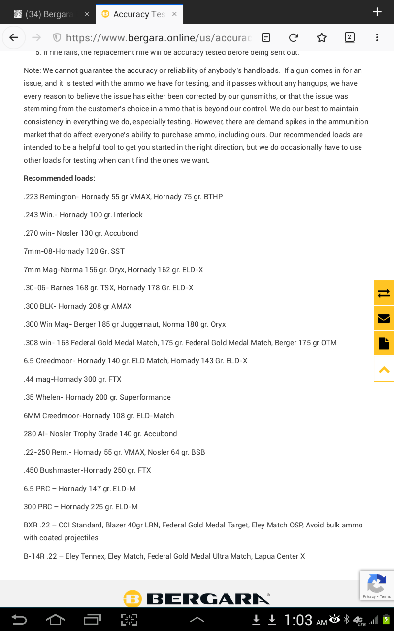

For the record you shot the recommend ammo ?
