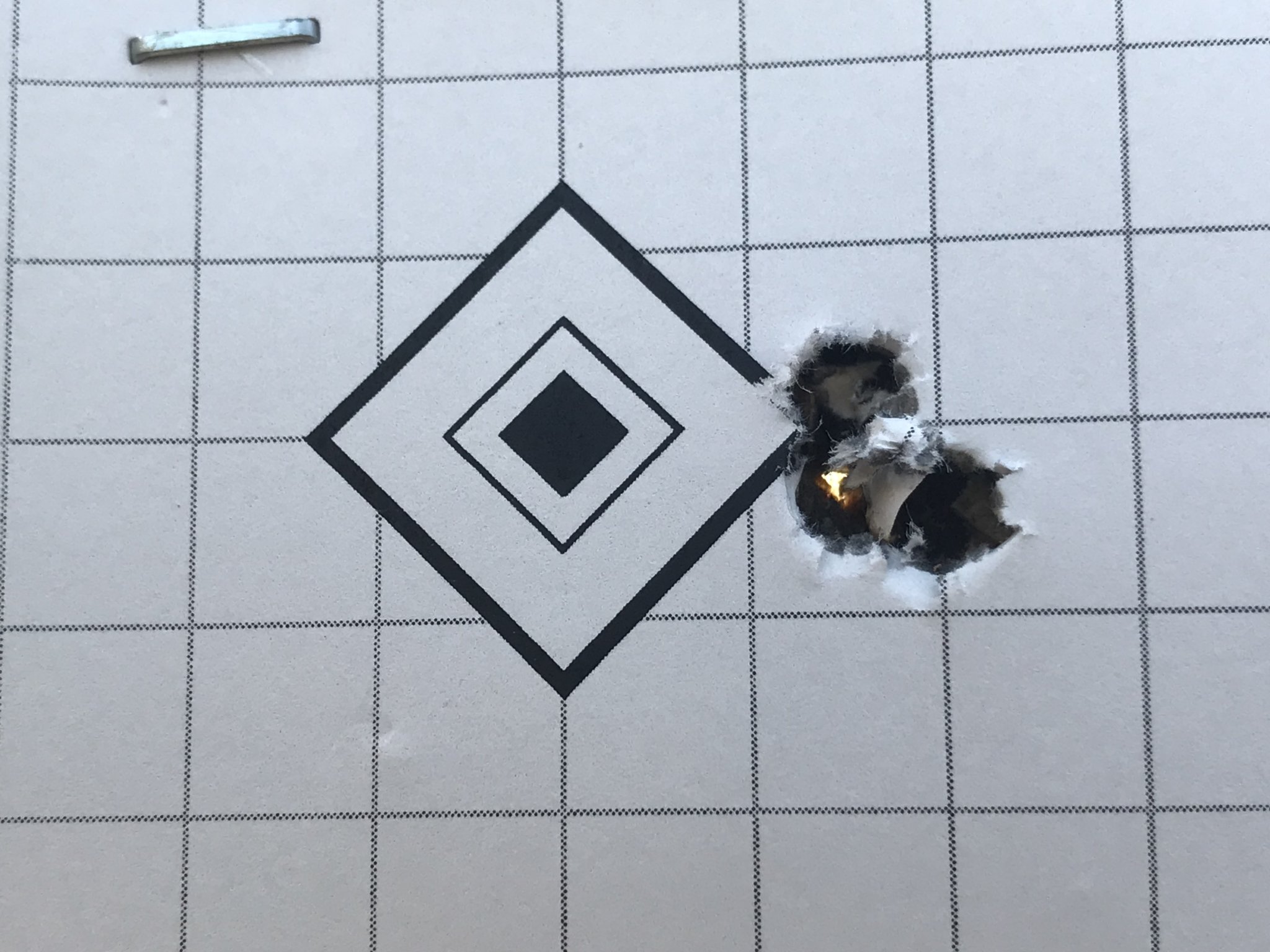

I acquired an HMR in 6.5 creed in a trade and immediately fed it some Hornady Match 140gr ELD factory loads. The results were horrible. Smallest group was just over an inch. Largest group was around 3.
I decided to throw together some handloads using the hornady brass, H4350, CCI BR4 primers, and 130gr Berger AR hybrids. The results were phenomenal (best group of the day attached). Single digit SD and ES.
I have no experience using small rifle primers with this rifle, and I’ve read you’re better off sticking with large rifle primers.
