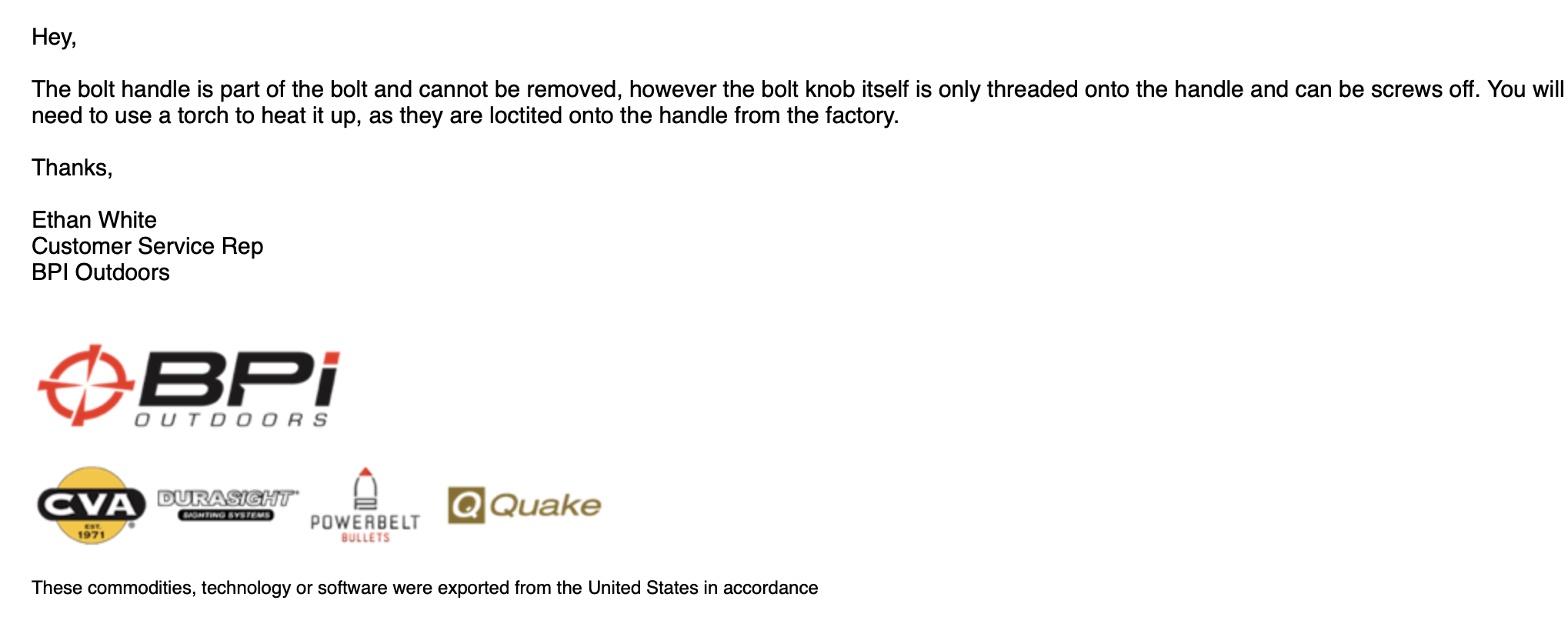

email I received asking about the handle & knob. How did you get your handle off? It wasn't welded?
Where were you told that they are the same? The guy from Bergara said mine is welded. I’ll be taking it to a gunsmith soon. I’m not sure if it can be modified (the handle)
It was the same in my experience, those were the exact instructions I used to replace the bolt handle on my B14r. I have absoltely no idea why yours would be welded. If that's the case then definitely take it to a good gunsmith. If you can't get it replaced, it's really not that big of a deal you'll just need to practice a little harder.
