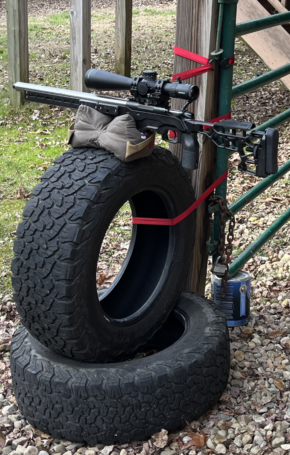

I didn't have a problem getting my carbon to balance well. I actually put too much weight in the rear of the stock. Weighted arca rail, filled forearm with lead. And the butt stock is filled with lead. I have not put it on a scale yet but I'd guess it's around 16lbs total. The way it sits the ballance point is almost dead center of the mag well.

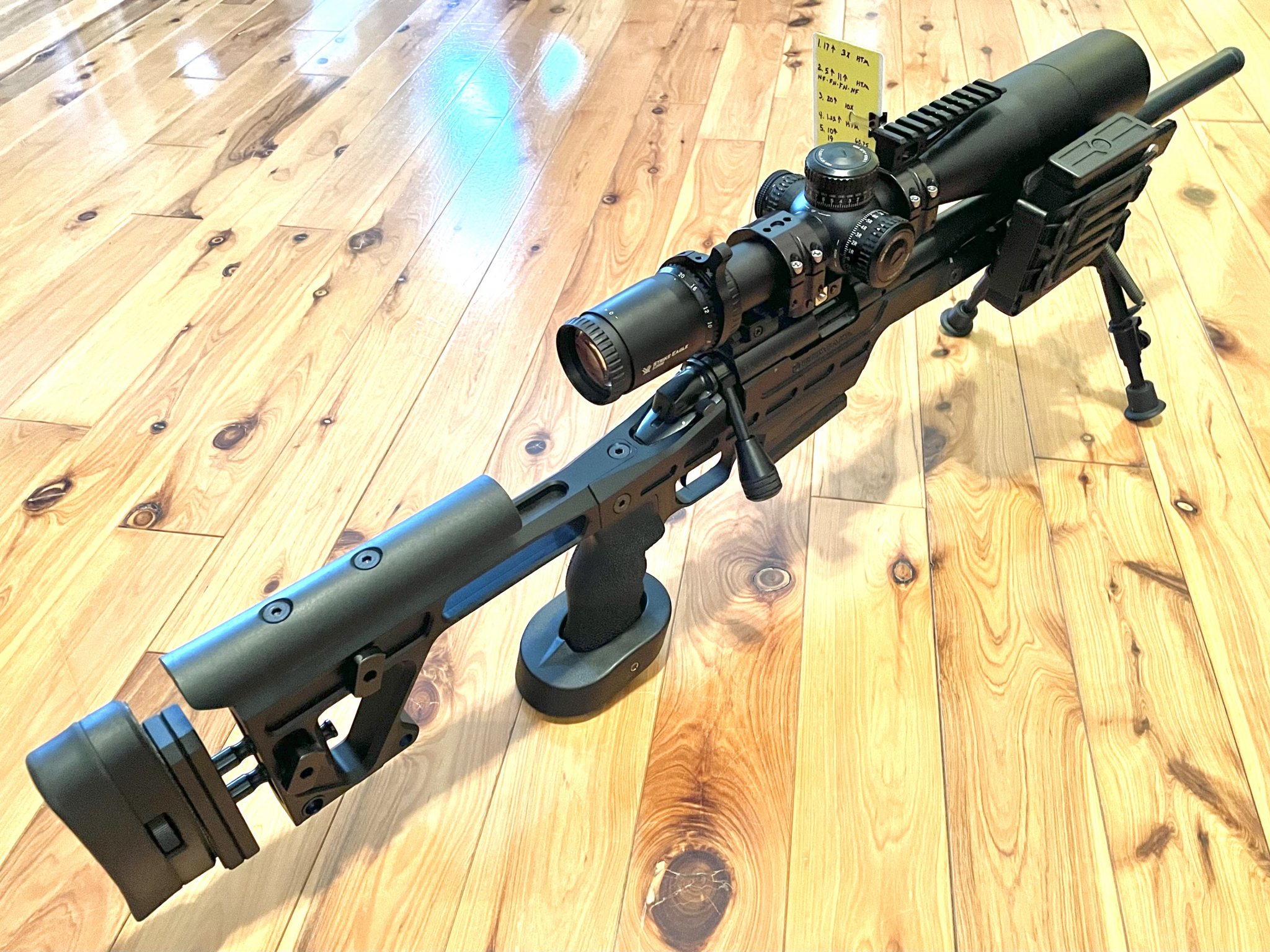

Look at the XLR Envy Pro chassis. It is "light" in the butt so easier to balance a 22. Also has adjustable mag catch to better "tune" the B14R mag to chassis interface. I just got a used Manners PRS1 to try with a centerfire - the PRS1 is pretty light - I would thing a PRS1 with weighted ARCA rail might work.

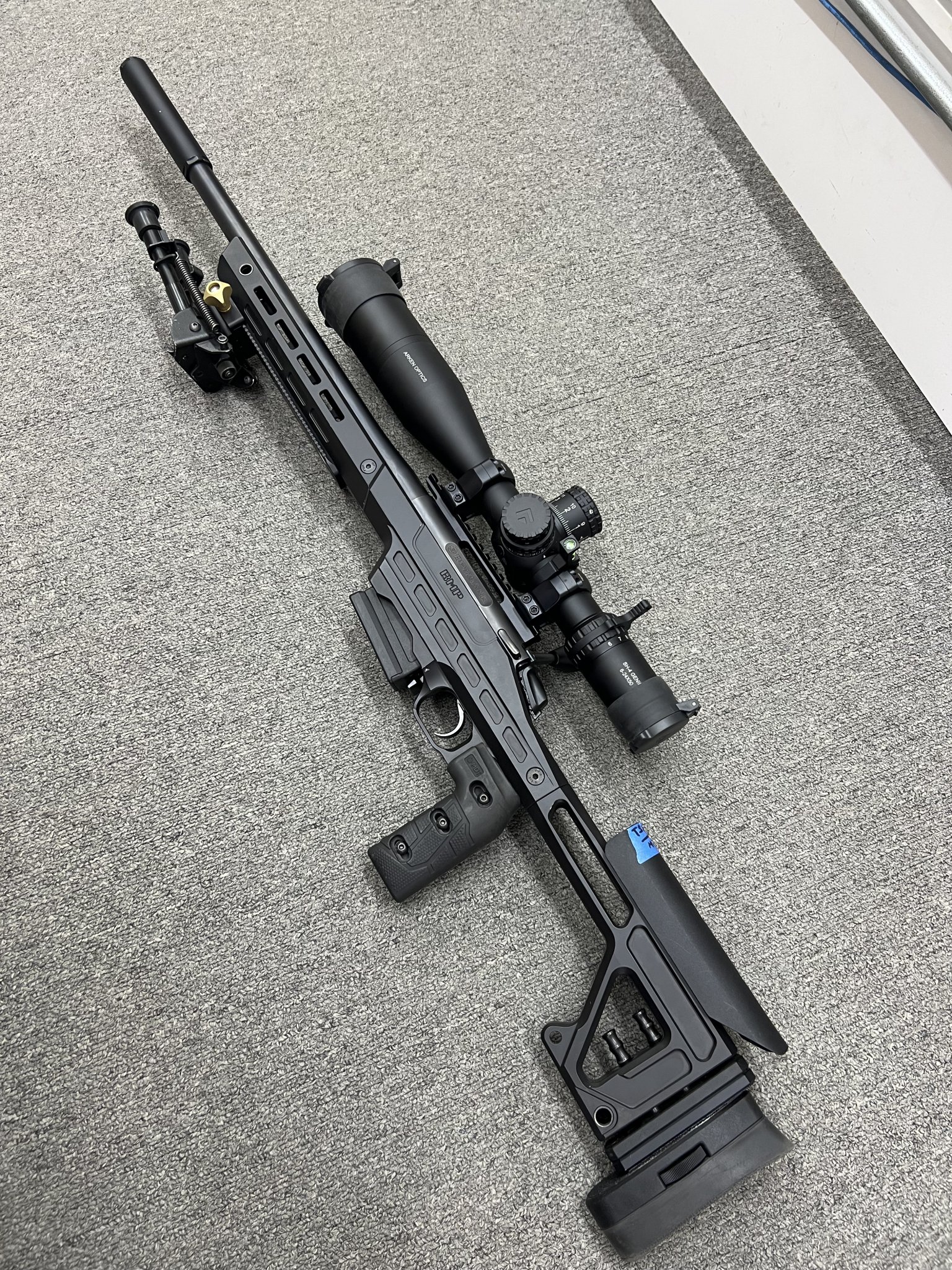

I’ve currently got a 23” straight 1.25” on the RimX with the PRS and it balances out nicely but now it’s close to 20lbs. The envy pro might be on the list for next season if I refresh the build.

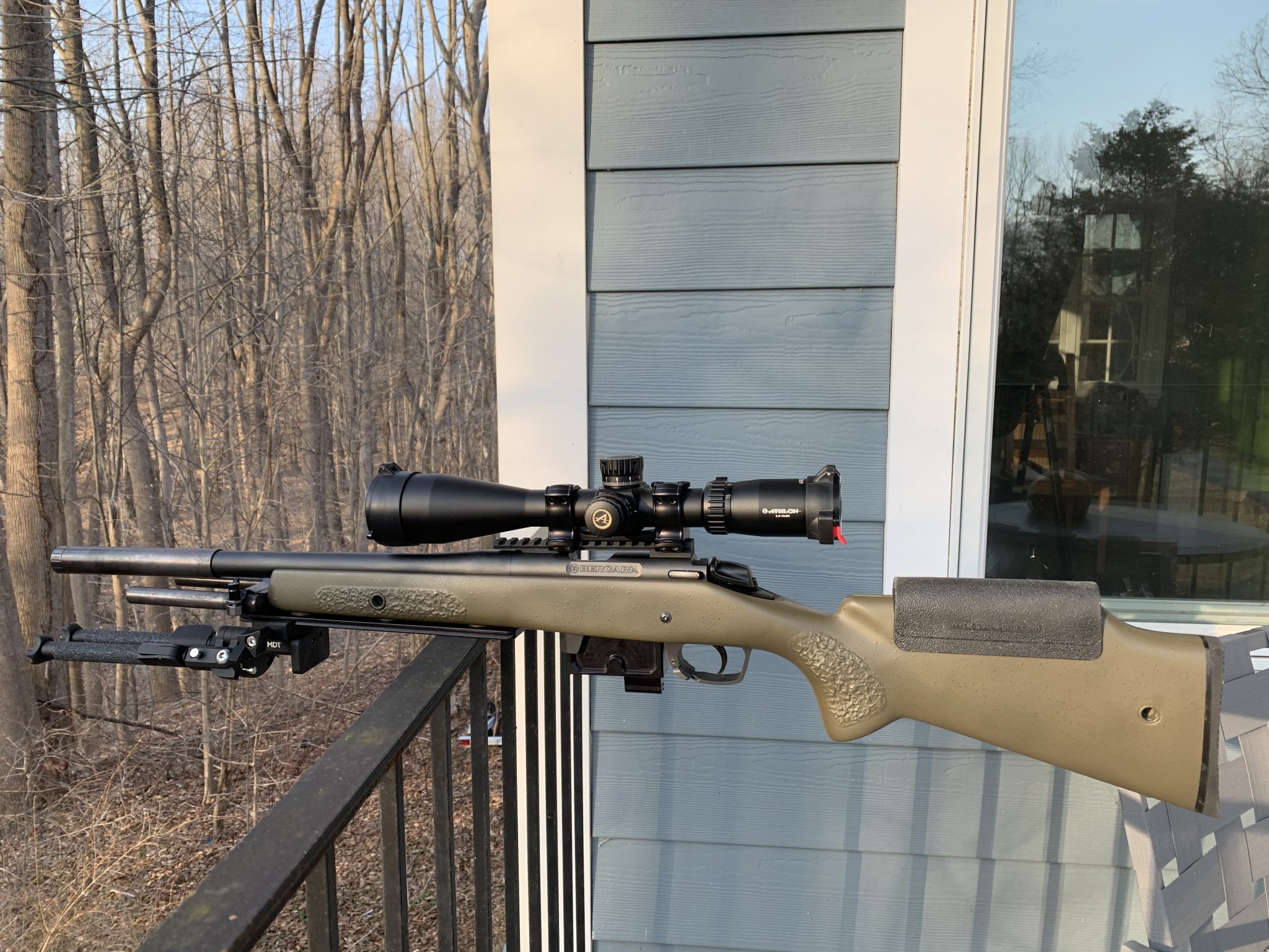

I currently still use the standard HMR stock on mine , with the factory barrel and a Tuna Can (Canadian made tuner) on the end, with the optic in a Recknagel Era-Tac adjustable mount, the balance is extremely good. Depending on the bag I use for a given barricade, it balances right at the magazine or just in-front.
Doesn’t hurt the tuna can is a tank, I weighed mine and if I remember correctly it’s well over a pound possible close to two pounds

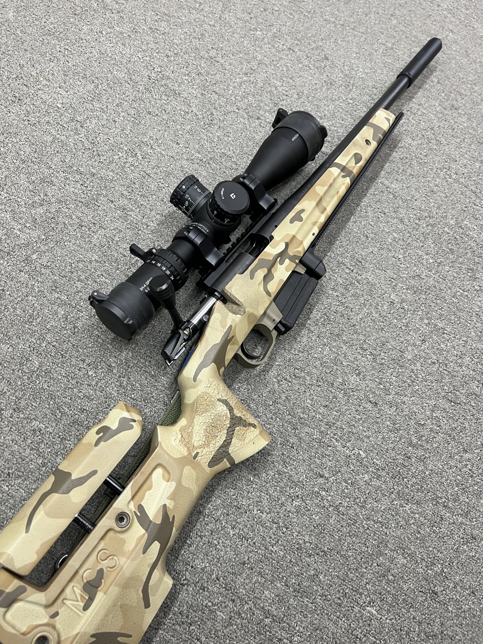

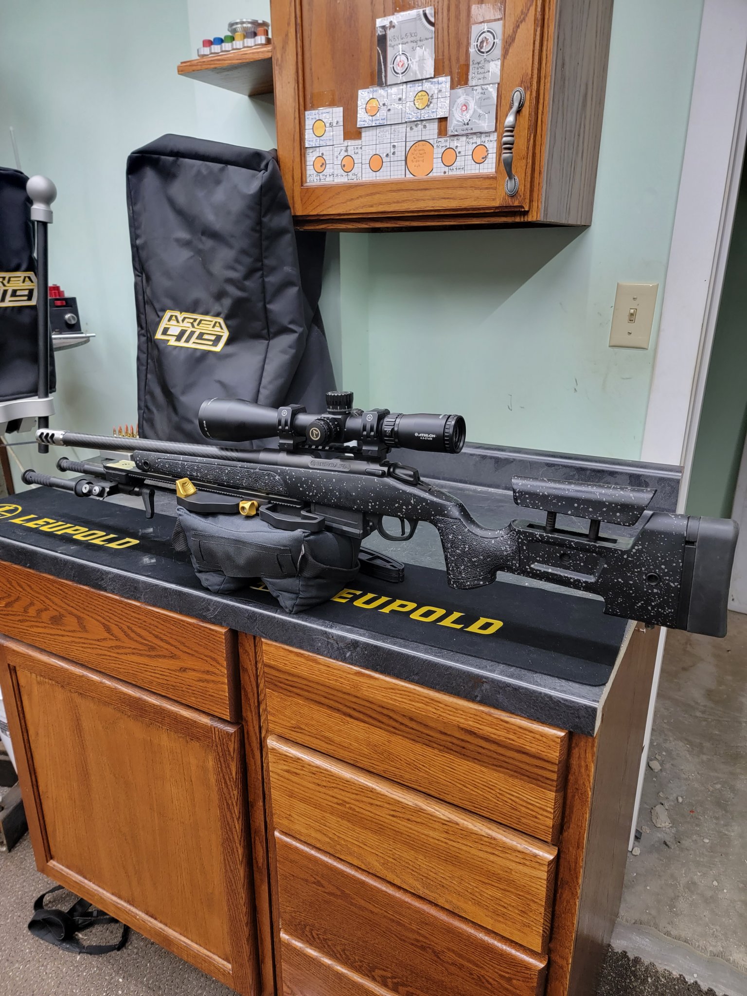

I find myself currently trying to figure out which setup I like better for my uses. The manners prs1 balances much better than the bmp does. But the bmp sits more solid on a bag with the additional weight. On the prs1, in a few of the hollow spaces on the hidden side of the area 419 acra rail I have added some steel shot and linotype to add a little weight up front. I plan to order some forend weights for the bmp to see how it balances then. I’ll report back when I do that.
I find myself currently trying to figure out which setup I like better for my uses. The manners prs1 balances much better than the bmp does. But the bmp sits more solid on a bag with the additional weight. On the prs1, in a few of the hollow spaces on the hidden side of the area 419 acra rail I have added some steel shot and linotype to add a little weight up front. I plan to order some forend weights for the bmp to see how it balances then. I’ll report back when I do that.View attachment 8127070View attachment 8127072
That color scheme makes me want to completely abandon the midnight camo I’m currently running
