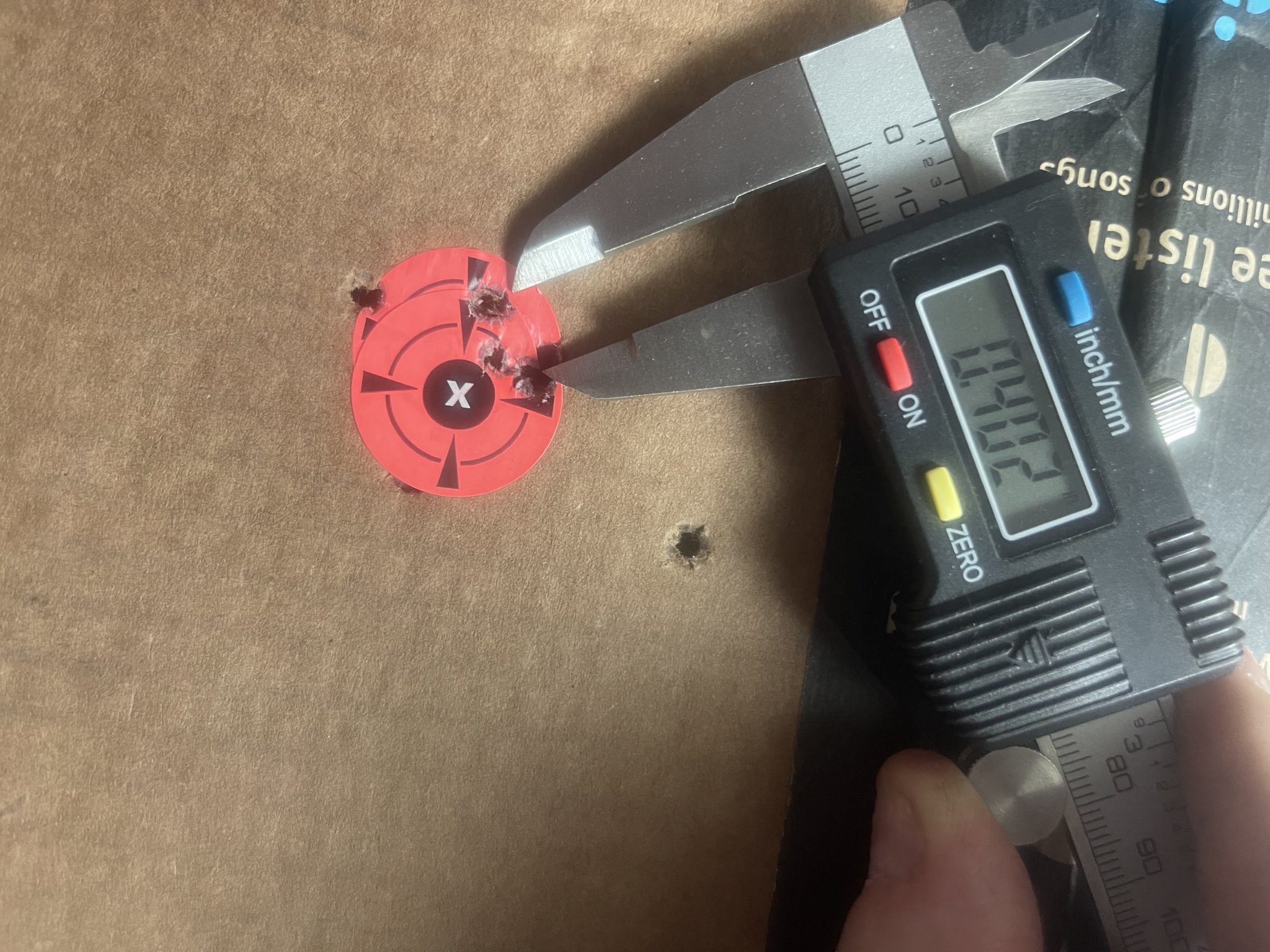

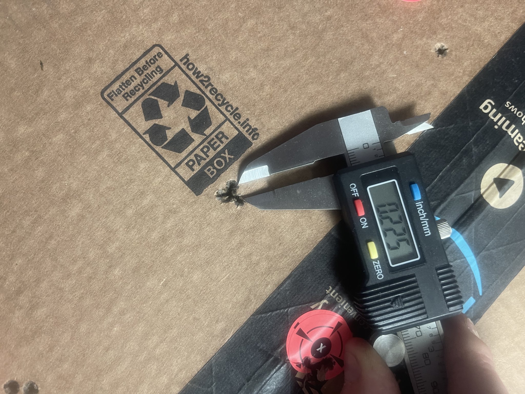

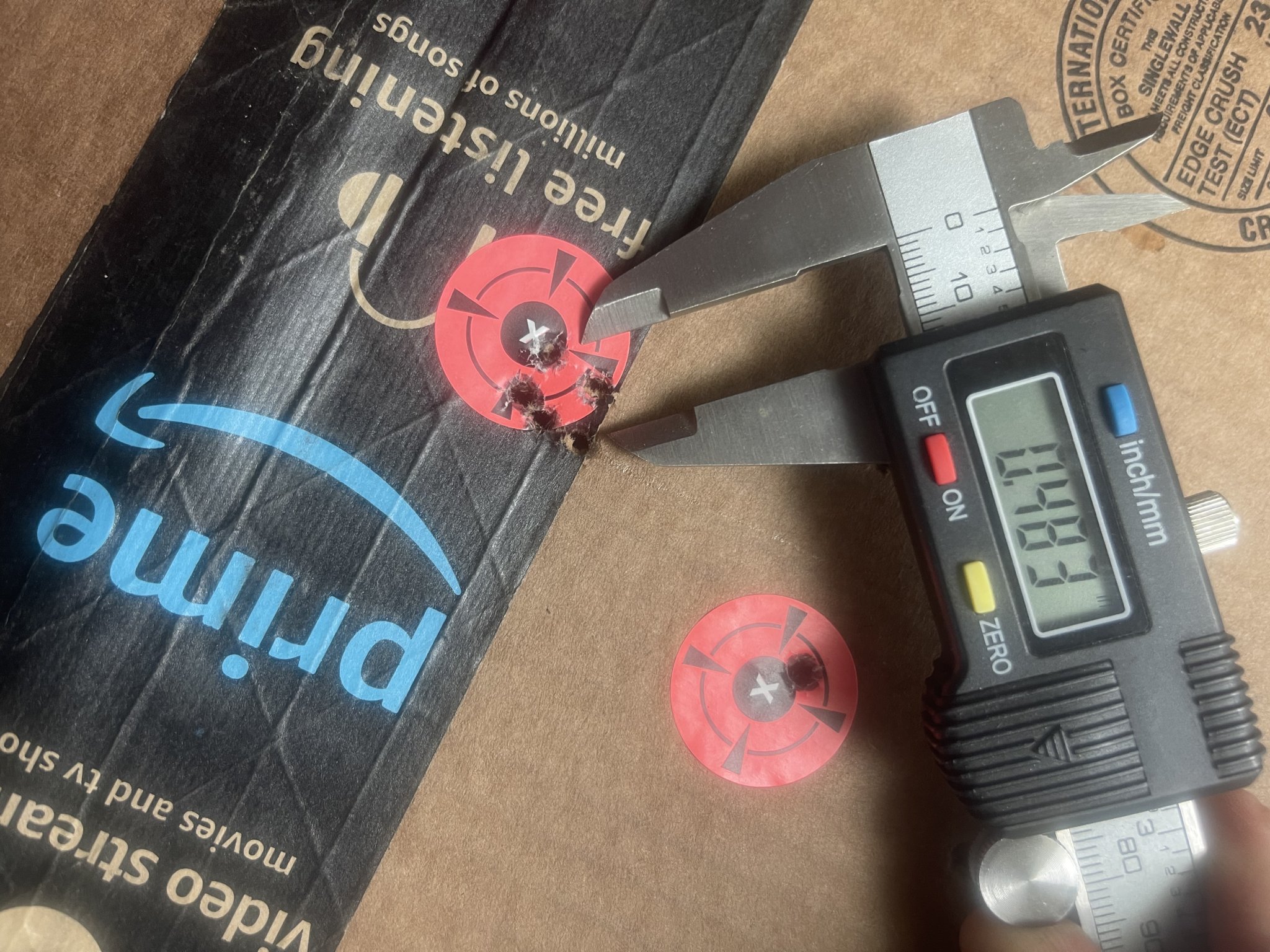

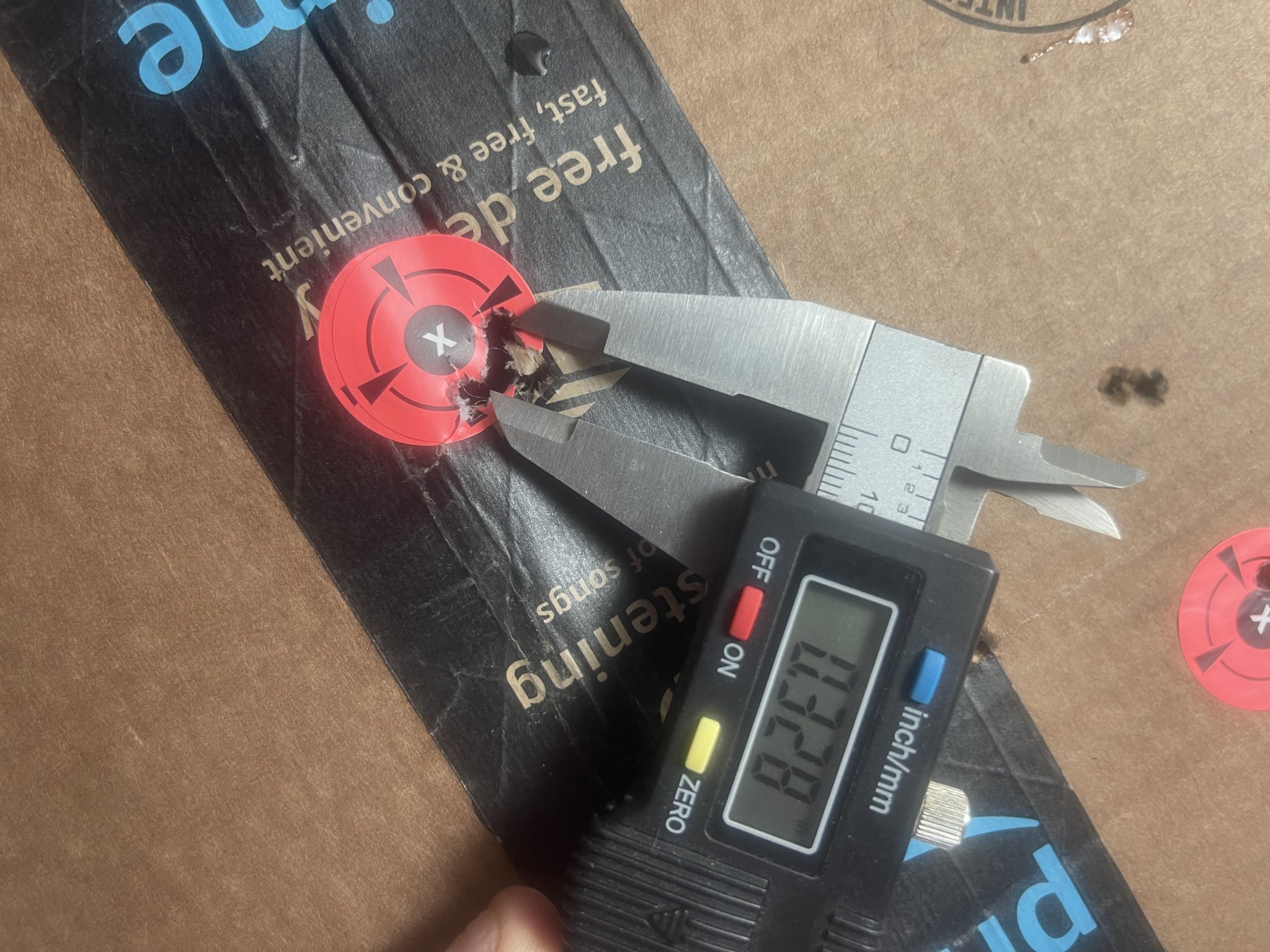

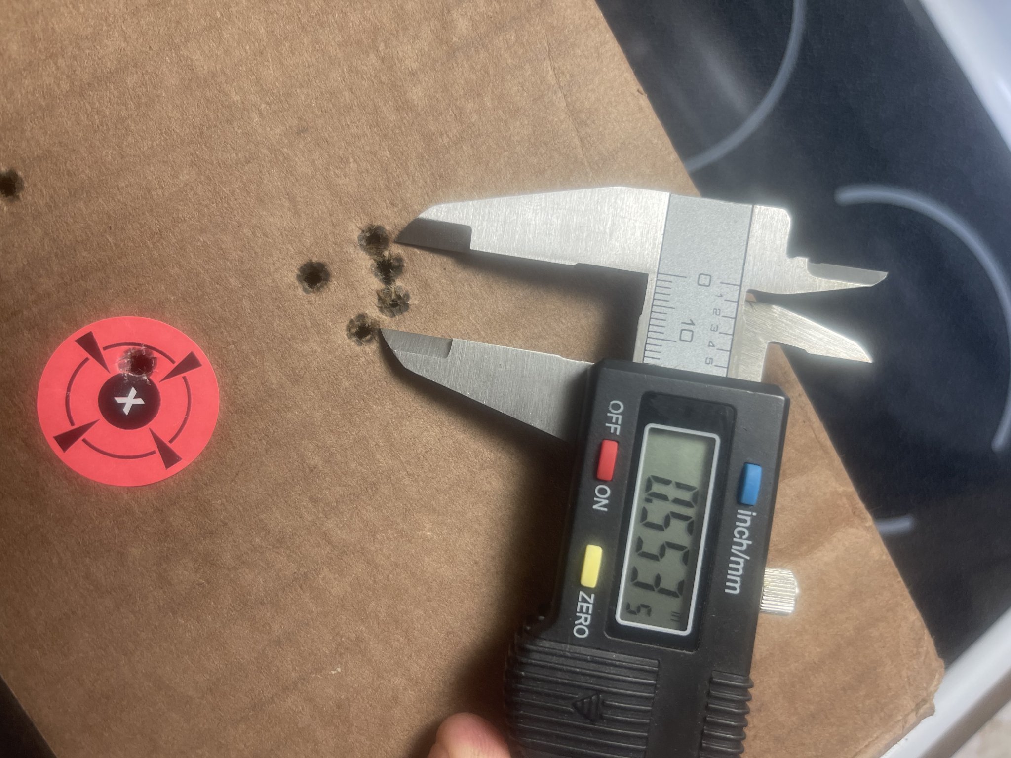

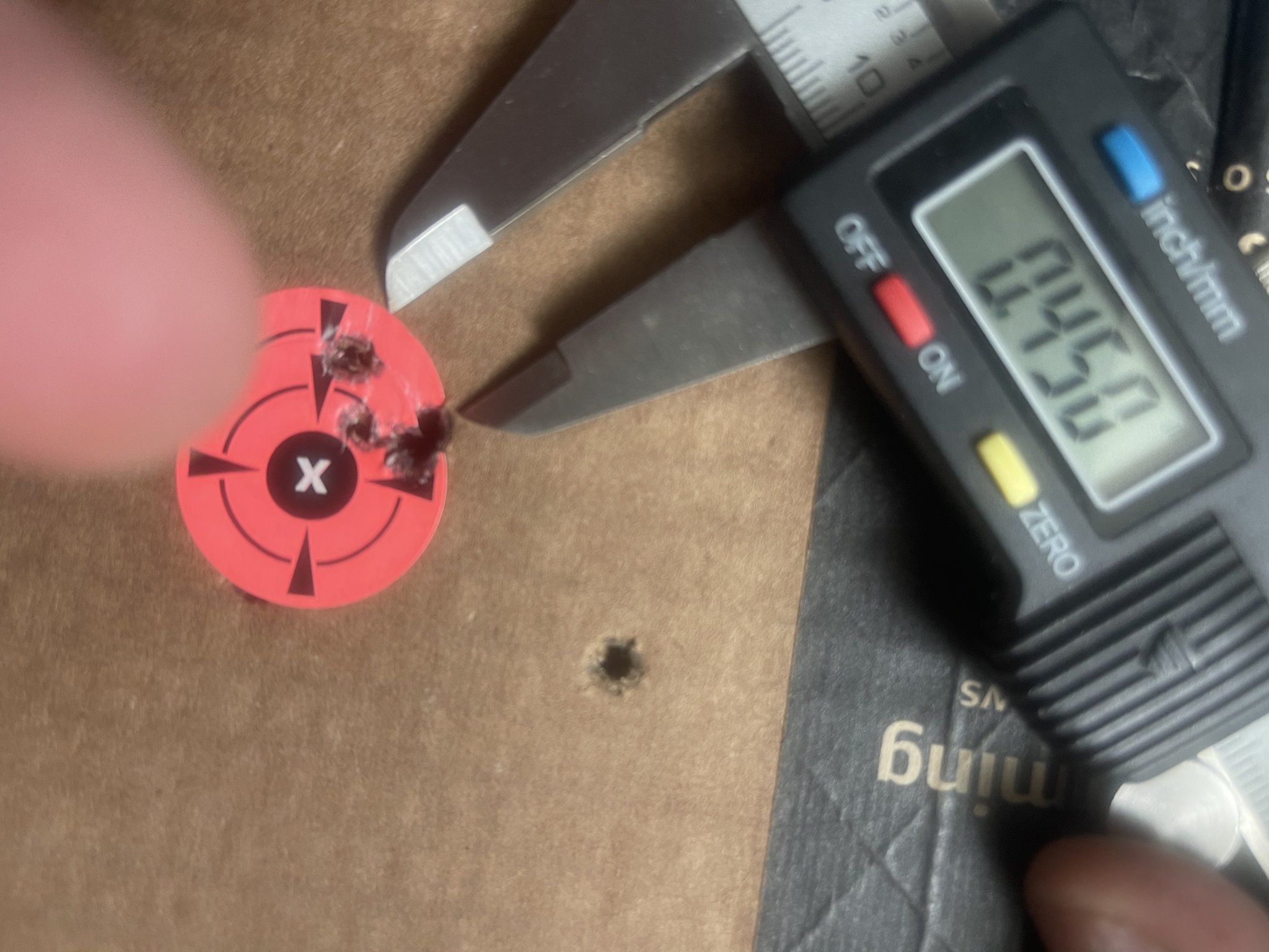

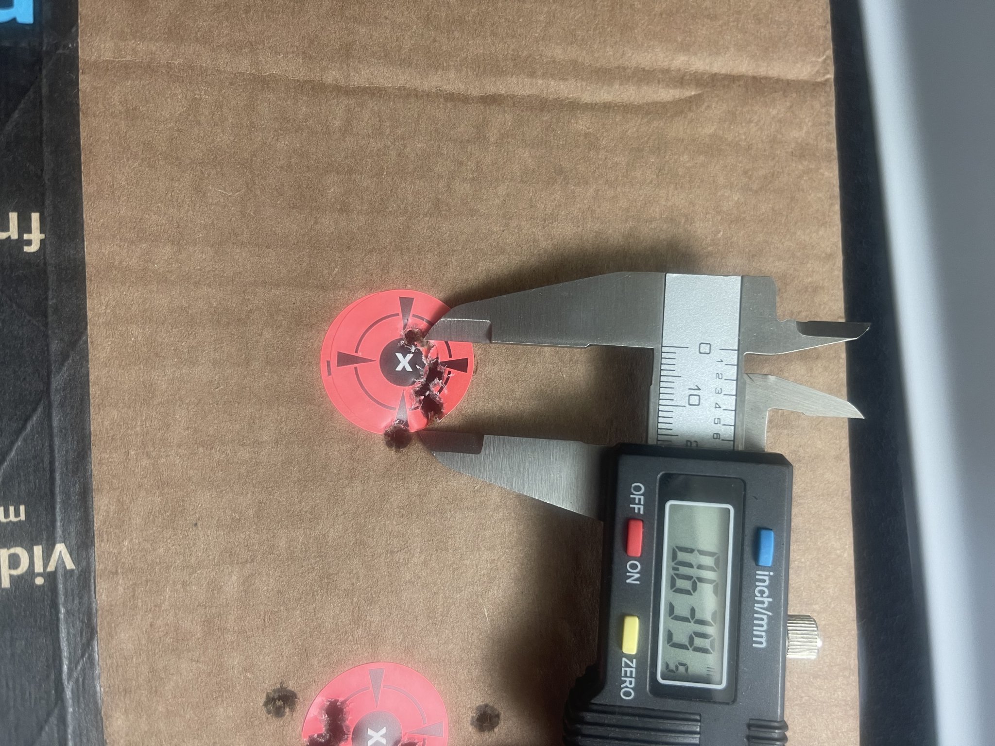

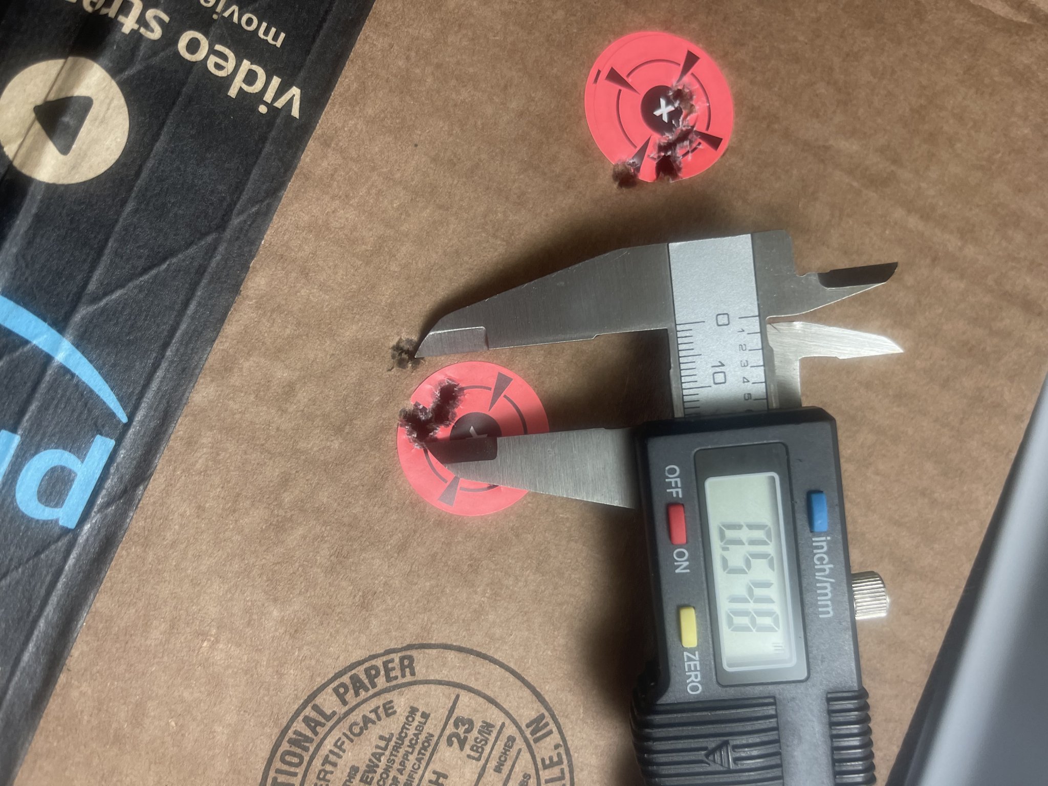

Tested mine yesterday with SK LR match. Fired 50 rounds through the gun. I got more consistent as he shooting went on. I reused some targets that had shots by them already. All 5 shot groups inside the caliper. The only 5 fired for that group. 50 yards. I’m trying to decide if this is good or not
