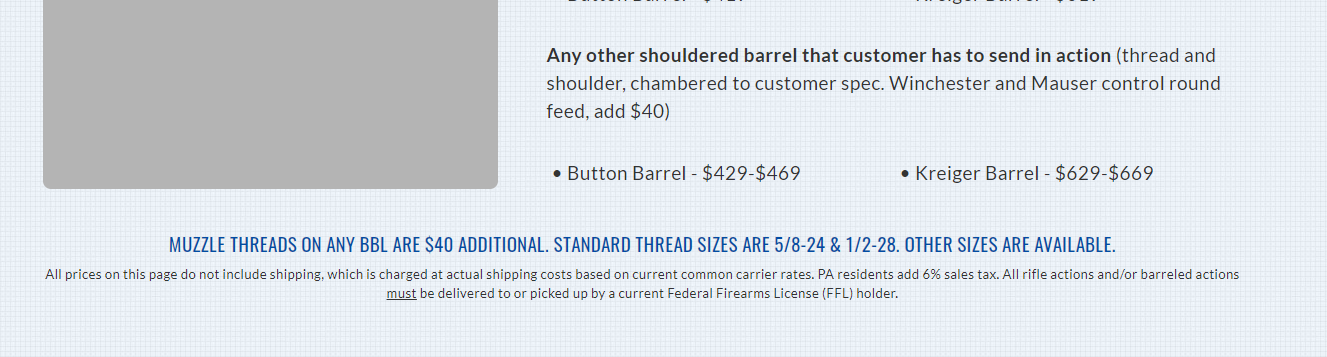

I spoke to Bergara again today. $500 with sub moa guarantee only their contours and chamberings. 6-8 months back log. Way too long of wait time and I'd prefer something bigger than a #5 or medium palma. Best deal I've found is at Keystone Accuracy, but you will need to send in action. You will end up with a button rifled or cut Kreiger barrel that is shouldered. I prefer shouldered to a remage style in my opinion.
Is that installed?
It would be 429-469 or 629-669 kreigger plus 40 for threads + shipping regular price installed but youll need to ship him your action and then he will need to ship it back to your residence for signature required delivery like you have to do for every action you send of to anyone.
He has sales frequently enough, I assume they will pick up again now that he has moved, where you get the muzzle threads for free.
