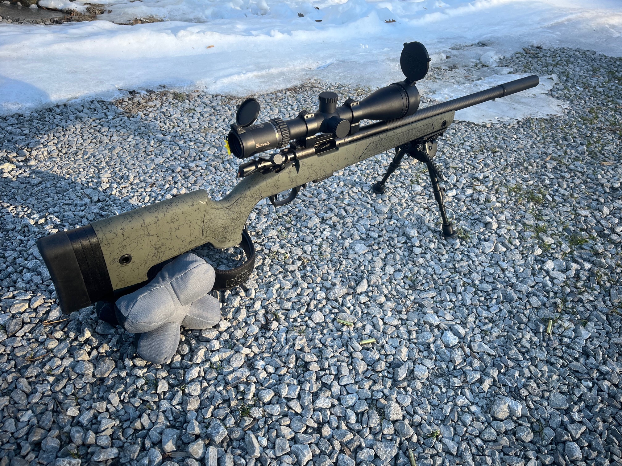

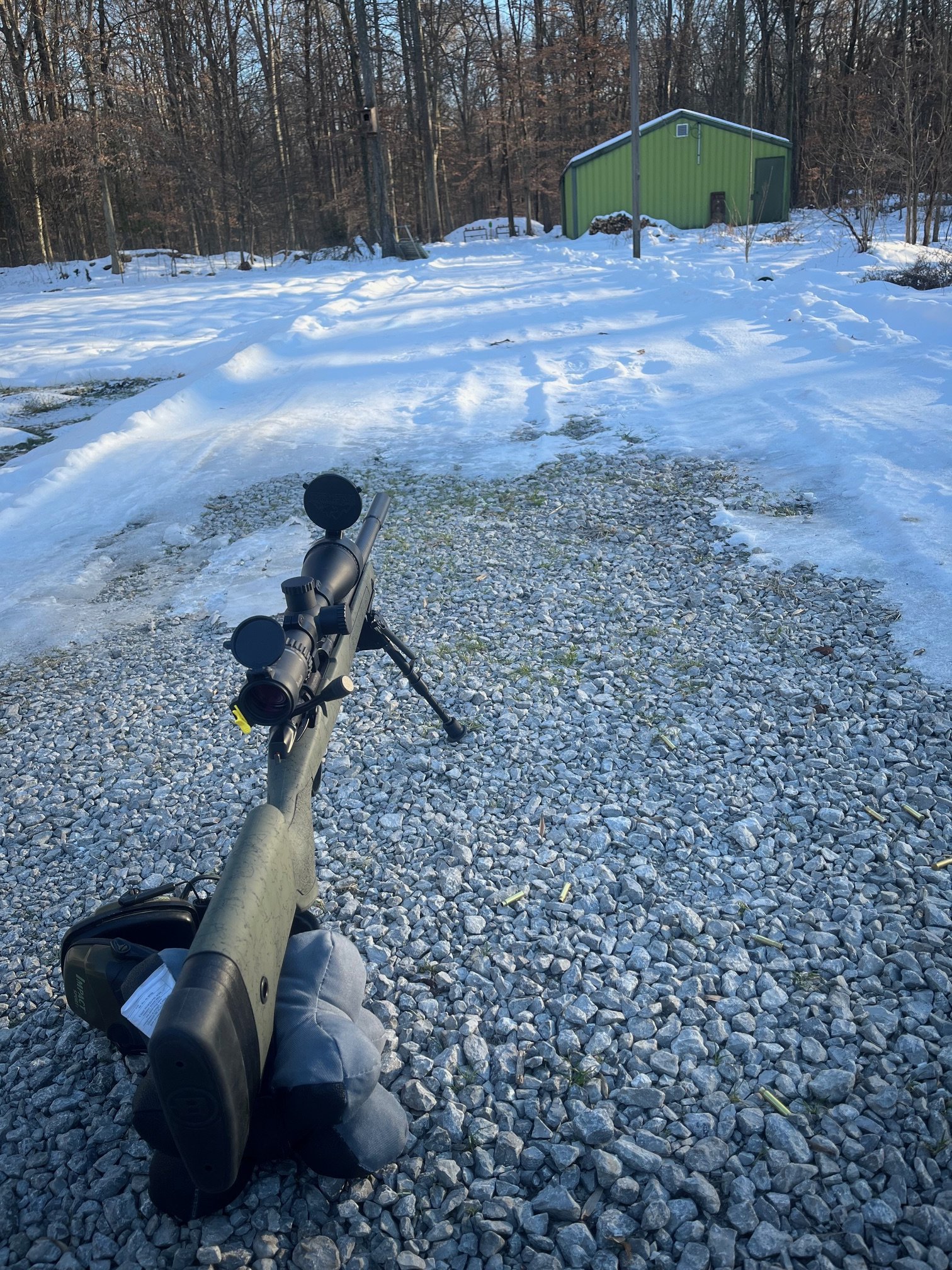

Picked my BMR-X carbon .17hmr today. So far I'm really happy with it. Fit and finish is excellent, trigger is very light, consistent and crisp, haven't measured pull yet, I'm guess under 3lbs or right around there right out of the box, I don't plan to adjust it right now. The stock is a really nice upgrade, it's very rigid and does not flex like the original BMR stock did. The flush cups are nice. I swapped out the 30moa base for a 0moa. Setup and older Burris MTAC 4.5-14 I had laying around on it. The bolt cycles smooth. The rifle overall handles well, I might mess around with the length of pull a little bit but its pretty comfortable for me with all the spacers. Waiting on some warmer weather to sight it in and shoot some groups, but I have high expectations.

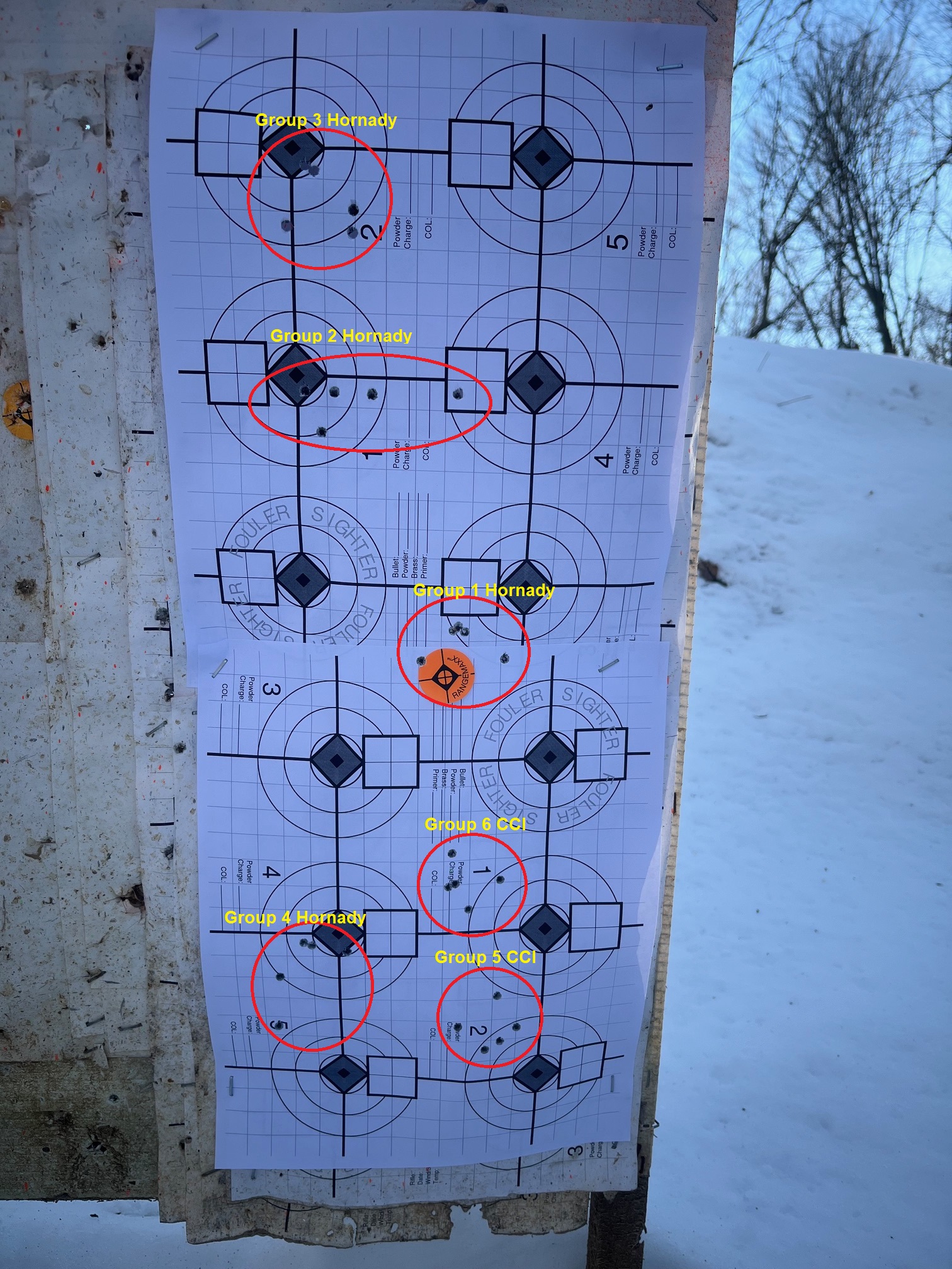

Had a chance to get out the other day to sight in and shoot some groups. Weather was...COLD, otherwise sunny and no wind. Was shooting prone with a bipod and rear bag. Target was setup at 100 yards.
The good: Overall function was flawless, bolt is easy and smooth to manipulate, trigger was consistent and breaks clean with no creep. The rifle "feels" great all around.
The bad: Pretty mediocre at best accuracy. I know it's a new barrel and shooting conditions were not ideal, but I definitely expected better results. It seems to like the CCI a little better, which is unfortunate for me because I have a boatload of Hornady .17hmr that my CZ's and Tikka prefer. I will obviously spend a little more time with this rifle and see if a little break in period is needed. Groups 1,2 and 3 were shot suppressed. I removed the suppressor on groups 4,5 and 6 to see if accuracy improved, didn't seem to matter but did change POI a bit. No called fliers here, every shot felt like it was well placed.

Probably just my luck to get the one bad one that doesn’t shoot well. If I can’t get any decent results I’ll send it back to Bergara. They replaced a brand new 243 barrel on a new rifle for me that wouldn’t shoot well, shot great after the re-barrel. My last BMR was an absolute tac driver. I might have a chance tomorrow to try again with this one. Will post more groups when I do.

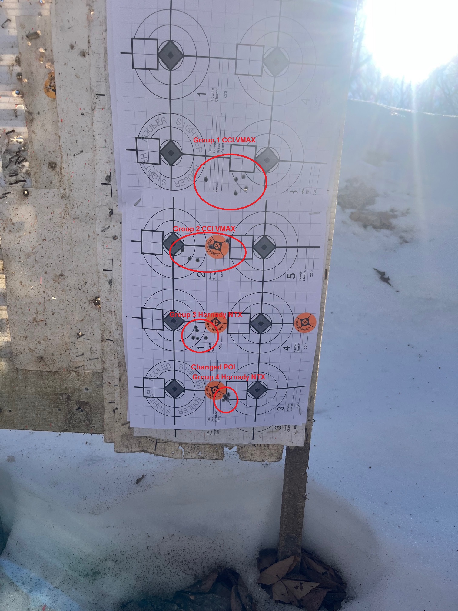

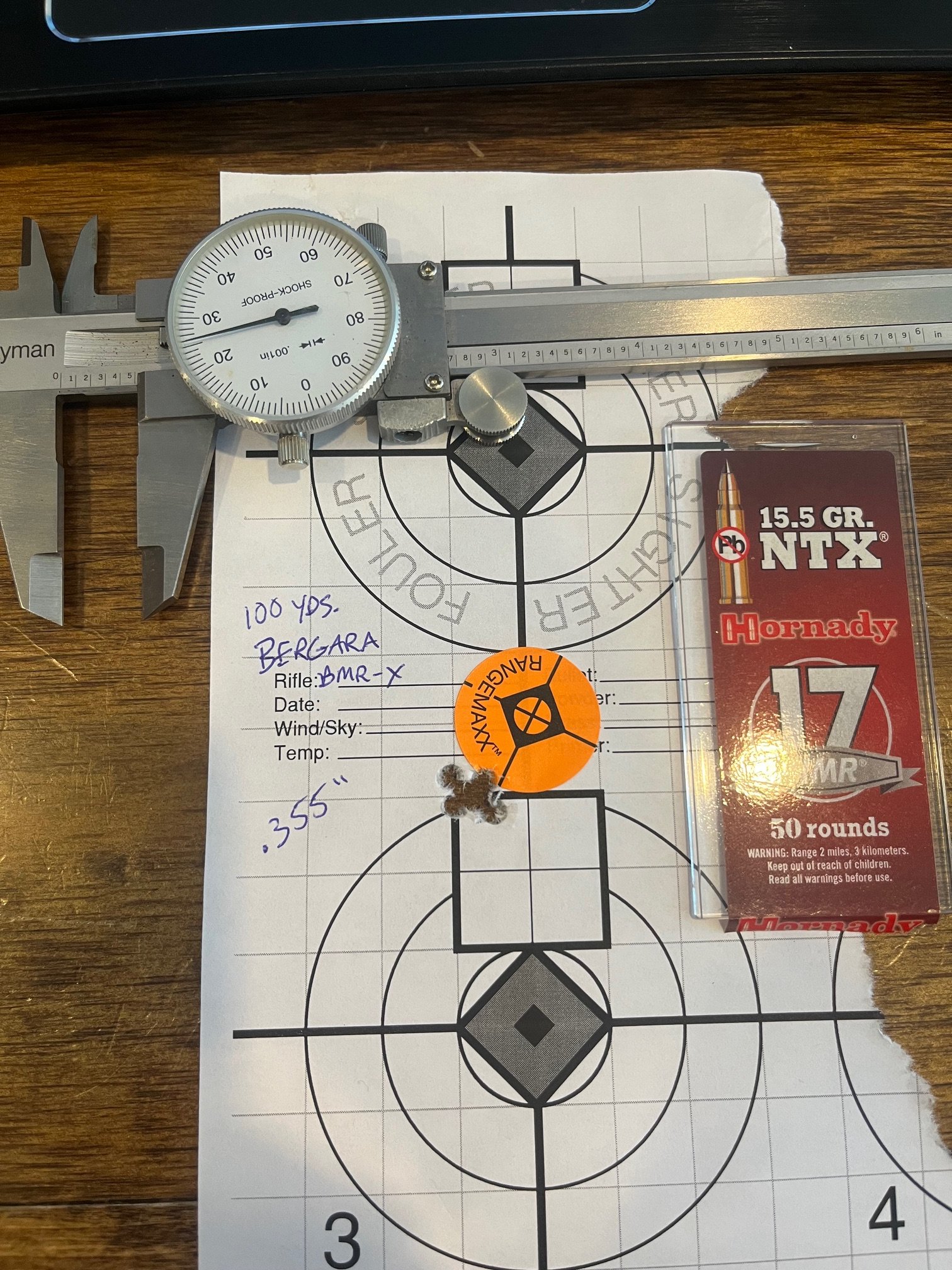

Well I have quite the update. I had a free hour today so I setup some fresh targets and grabbed the BMR-X. I had 2 new different types of ammo to try, CCI loaded with v-max (was shooting TNT before) and some Hornady 15.5 NTX. Not even sure where I got the NTX, but I had a partial box on hand and remember not having much luck with it in other rifles. Started out with the CCI since I had better luck with that brand the other day. Shot 2 groups and was already frustrated with 1.5"-2" groups. I didn't have high hopes but I decided I'd try to shoot one more group with the 15.5 NTX. Being aggravated with laying in the wet gravel I wanted to get it over with, so I was in a bit of a hurry not really taking my time. but then...WOW...that group tightened up a lot! Holy smokes...had to go down range and have a look. Alright not so bad now. Let's try one more and take our time. I could not believe the last group I shot at 100 yards with this rifle. 0.355" at 100 yards with a .17hmr is impressive to me. I was about to give up on this thing.
