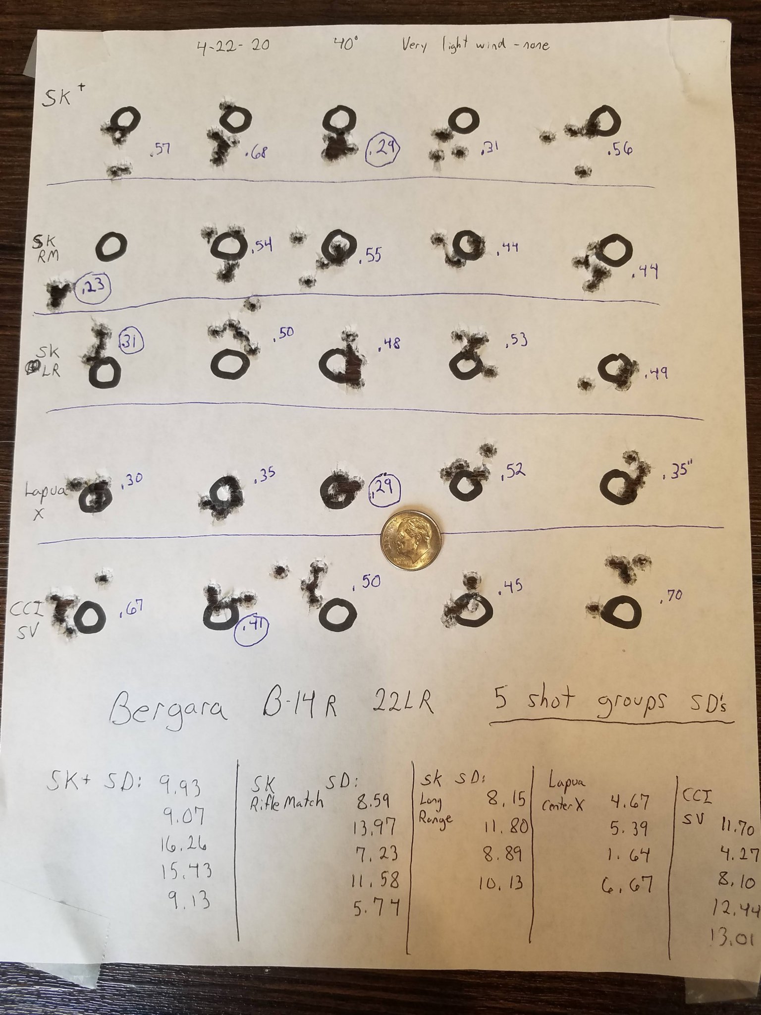

I'd vote Bergara. I have had the Tikka, CZ 455, 457. Man the Bergara just is super accurate. It seems more consistent than the others. The other rifles are great of course, but they were lacking in feel for me as well. The Bergara just feels like a center fire, and I see the appeal to 700 patterned 22lr rifles.
Here's a few types of match ammo I did with my Bergara.
Reactions: Kansas Hunter
