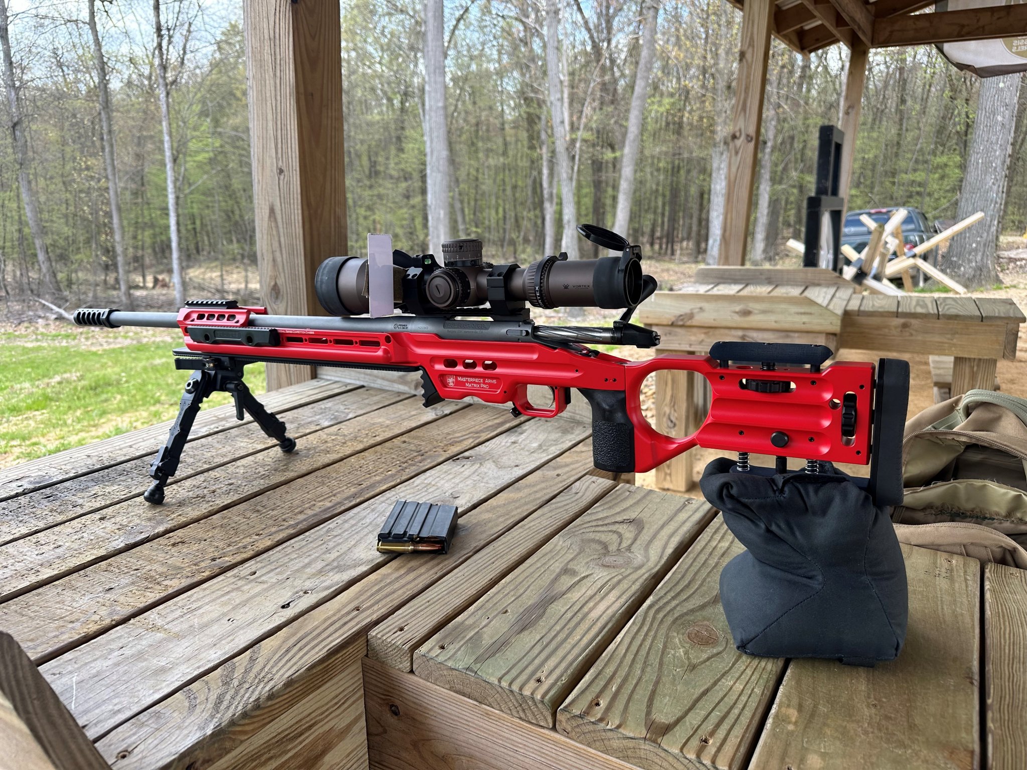

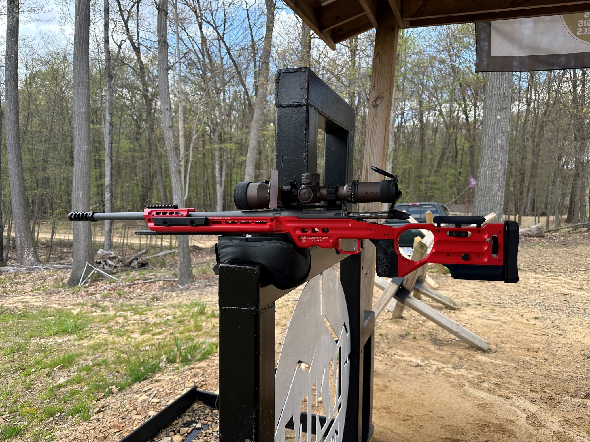

    A quick update on Rosann's Bergara HMR Pro. It has some new hardware since this last post and Rosann is going to try her first PRS match (one-day club) in June. She had a bunch of prior appointments yesterday, so I had the opportunity to get it out to the range to give it a quick zero check since it now has a APA Fat Bastard muzzle brake instead of the TBAC CB mount. Shooting from a modified prone position at 100 yds on a bipod and rear sand bag, I was able to put three into a small cluster, then adjusted 0.1 mil down and sent two more. The squares on the target are 0.5 inch. The point of aim was the upper right outside corner of the blue square. I'd say it's good to go. This Bergara doesn't suck.
