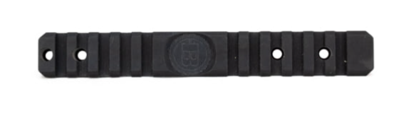

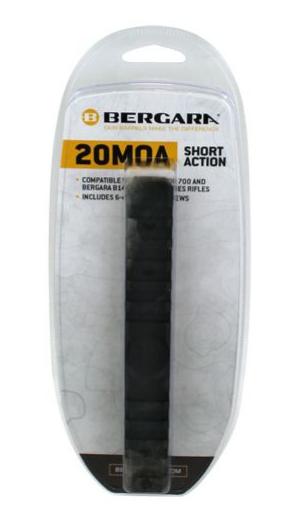

Hey guys. Frank mentioned an issue on the podcast with the Bergara rails coming loose. Anyone know specifics? Is it Bergara factory rails?
I am about to attend a two day class with my Bergara B14 HMR in 6.5 Creedmoor. It has an Area 419 rail. Wondering if I need to keep a close eye on it or if I should be good. And yes, I torqued it to specs and used blue locktite. :)
Thanks for any help.

Not speaking for Frank but I can share that we commonly have problems from Bergaras that are brought to our L.E. Basic and Advanced courses.
Two issues most consistent are scope base coming loose and extractors getting jammed up.
The scope base issue has included Bergaras that had them removed and reinstalled with LocTite. The issue is that they are putting a cheap ass Pic rail scope base on the guns that have no recoil lug to engage the receiver. So.....every shot results in the 4 mounting screws taking the shear load.
I can say that we also see this phenomenon with rifles other than Bergara rifles that use similar bases from EGW and others that have a slick bottom.
For comparison, look at the bottom of NightForce, Badger Ord, Seekins Precision and I think Area 419.
Those have a recoil lug or lip that is machined into the bottom which seats against the front edge of the ejection port on Rem 700 style receivers. They also have elongated/eliptical screw holes and countersinks that allow the base to be "seated" forward before tightening the 4 mounting screws. These bases cost more because they are more complicated to machine however they are properly designed to transfer the shear forces from recoil directly to the receiver.
Combination of heavy scopes (Ex. Gen II Razor ) + medium to light rifle + .308 Win or bigger chambering increases the likelihood of the cheap bases coming loose regardless of LocTite, etc.
ETA: MARS rails are notorious for this as well.
Green lock-tite on the base, blue on the screws, and send it.
I've yet to have a base come loose on any rifle, other than a 597 with the #6's into aluminum. That one got 8-40's and jb-weld after a sanding on the rail and receiver.... (it may be hack, but it hasn't broke again).

So, the issue with the bases has nothing to do with Bergara, so much as it does a non recoil lug base.

You should go back and read.... that's not what they said.
All I'm going on- the rails that I have seen on Bergara rifles (not many and have no idea if they are the ones coming lose) have a big "B" machined in them and are either made (or marketed) by Bergara. If those are the ones coming lose then it is on them.
To my knowledge, Bergara does not include a scope base on any rifle. Their website does not show any rifle with a base. Maybe they provided a shitty one at some point, but they definitely don’t now. I’ve never seen a factory-installed base on one.
Either way it was never an issue with the rifle itself, so it’s not accurate to make a blanket statement that “scope bases come loose on Bergaras”.
Safe to say, if you buy a Bergara or any other rifle:
1. Buy a quality base with a recoil lug.
2. Torque to spec with blue Loctite.
If you fail to do those two things, you don’t get to blame the rifle when the rail comes loose.

Thank you. That's what I originally asked. Was it the rail, or the action.
The Bergara branded bases are probably sourced from EGW or some Chinese supplier. They don’t have a recoil lug, so shame on them for that.
Fortunately any 700 base will work… just like any other 700 pattern rifle that doesn’t include a rail.
Every Bergara rifle that we have had show up on the line was delivered to the user entity with base installed.
Link to a 2019 Bergara Catalog: https://www.bergara.online/us/wp-content/uploads/sites/6/2019/01/LE_Catalog_2019.pdf
They also send out promotional SKUs that include scope base installed on some rifles that do not normally ship with bases.
Thanks for the reply, I respect your experience a lot. It looks to me like the problem is the smooth bottomed base, and Bergara made a big mistake using it.
But… am I missing something here? Is there a problem with the rifle itself that is not related to the base they used? I mean, first of all screw them for using a non-lugged base. But if those same rifles had all showed up with Badger rails would we be having this conversation?
Not only that, I believe Mr. Terry has diagnosed my issue. I thought that I had a carbon ring when the groups opened up to 1 moa after shooting half moa consistently. I never thought to check it because I LocTited it.
Not on, but with. One came with my HMR, I don't remember if one came with my hunter or not.
My BMP didn’t come with one, never saw one included with another rifle either but obviously it happened sometimes. They would have been better off not including one IMO. I use a Seekins base and have never had a problem.
When I bought mine it happened to be the last one they had, it didn't have anything on it, but when going through the box I found a bergara 20moa rail.

Other rifles out there besides the Bergara are outfitted with slick bottom bases. It certainly is not limited to Bergara. We have seen plenty of this type base come loose on other actions for sure.
The OP simply asked very specifically about Bergara and very specifically about their scope bases coming loose in when he started this thread.
EGW and others sell a metric shit ton of slick bottom bases that end up on many brands and models of rifles.
All have the potential for similar failures as described above.
However.....almost all will be mounted on recreational rifles that are shot very little with lighter weight, inexpensive scopes. Basically the opposite of most members of SH.
So....
Most will never have them come loose simply because they aren't using them to any degree.
Most would likely not even be shooting well enough to realize an issue much less diagnose it if the base came loose.
I'm not talking down my nose at those users at all. It's just a fact of the market and what can be considered perfectly good and serviceable until subjected to hard and prolonged use. Even then you are going to have some that will never come loose just because.
