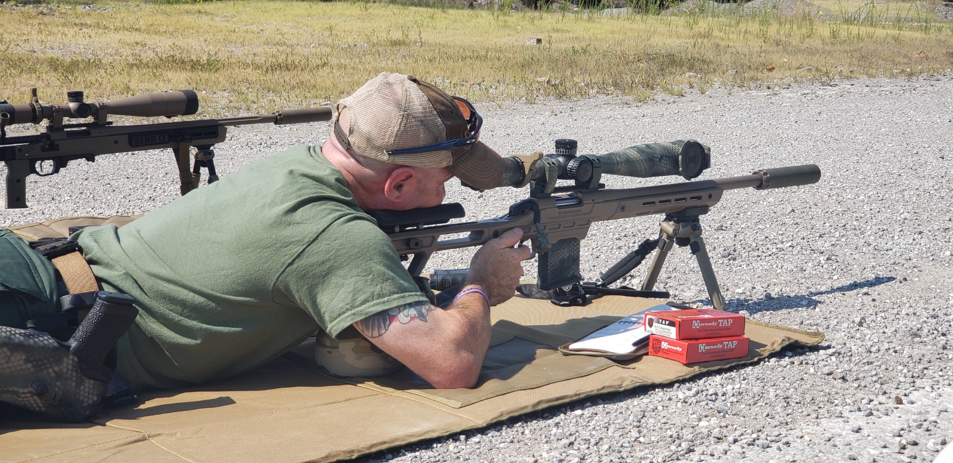

Where is this course and who puts it on?I haven’t had any issues with my bmp as of yet.. been through one advanced sniper course with it that over 70 hours in 5 days and it is holding strongView attachment 7690163
