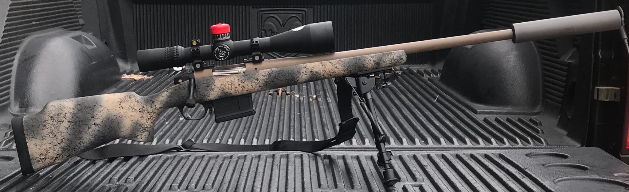

I’ve put 20 rounds through her and I like everything so far except the stock. I called Bergara and they offered to sell me one of their adjustable cheek piece stocks but I don’t like them... Looking for a McMillan HTG with adjustable cheek rest or the Manners equivalent. Does the Premier action have the same footprint as a Remington 700?
Accurate rifle, got this little corn thief last night but I want a better stock. Bump....

Still looking for confirmation on if it’s a true 700 footprint, but here is a pic of how she sets now.
