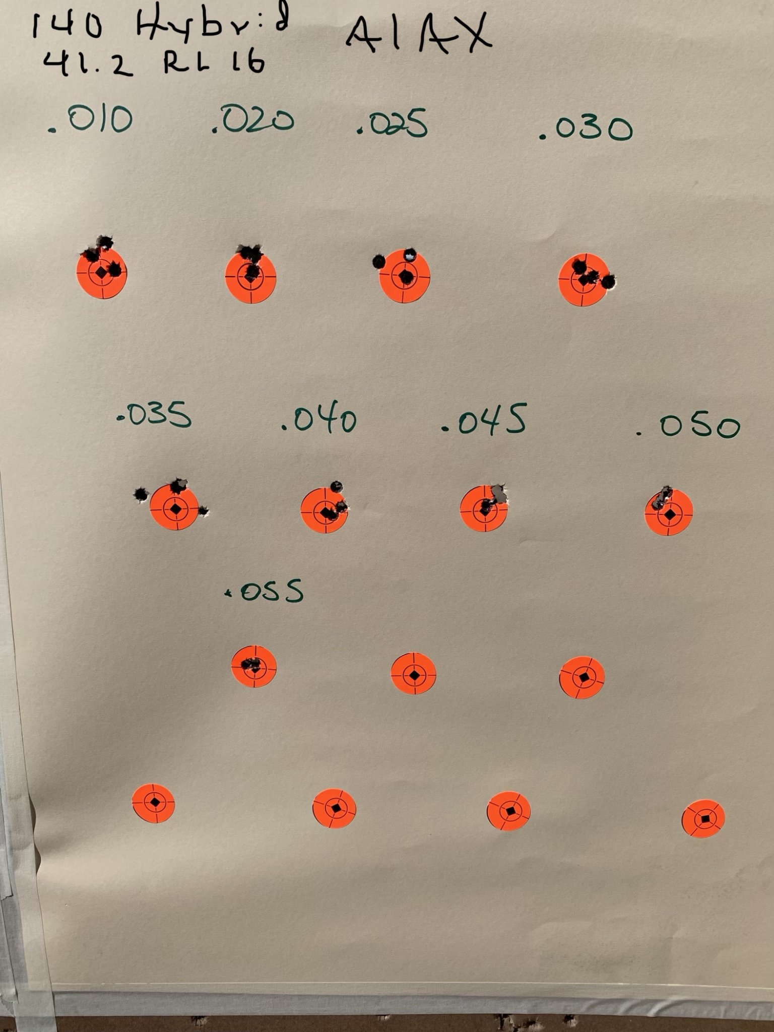

Correction. I’m jumping .055”. That’s the max I’ve tested. Here’s a pic of my seating depth test.

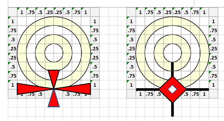

Made them in Excel. Here's a .pdf

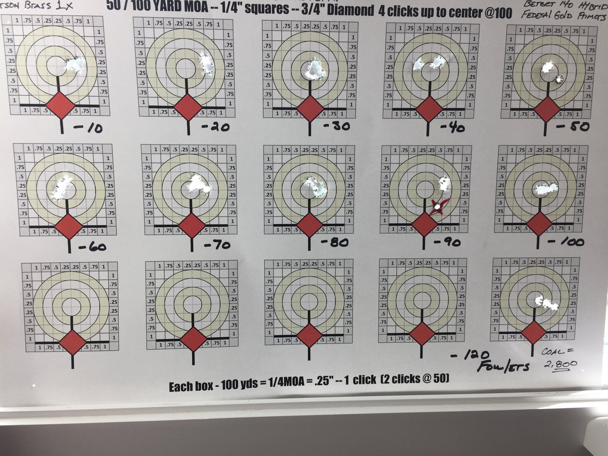

The excel file is designed to print at 11*17, so if you scale down, everything scales. If you want 8.5 by 11, you’ll have to edit the excel file, remove those individual targets that won’t fit on the new page size and save as pdf.
I’ll provide a link to the excel file to revise and save however you desire. I’ve also got a MIL (.36 squares) version as well.
They work great for load development.

It’s easy to do now that I have a template. I’m actually going to add a smaller diamond inside the diamond. It’s a bit big as is and allows for too much “float” around the inside. I’ve actually started using the tip of the diamond as the aim point - it’s more precise.

Here's a couple other design ideas. (Ignore the green triangles, they're an Excel artifact)
