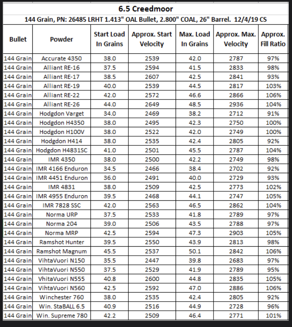

I was getting right at 2700. I don’t think you will see 2900 unless you have a 30 inch barrel and some reloader 26.
Thanks for the data point. I'm at 2830 with 41.9, but I wouldn't call it a node. There is a big fat velocity node at 2793 in my rifle. Planning to walk up the charge weight through another grain or so and see if I can find a higher one. If not, I'll be happy with that and load a bunch up.

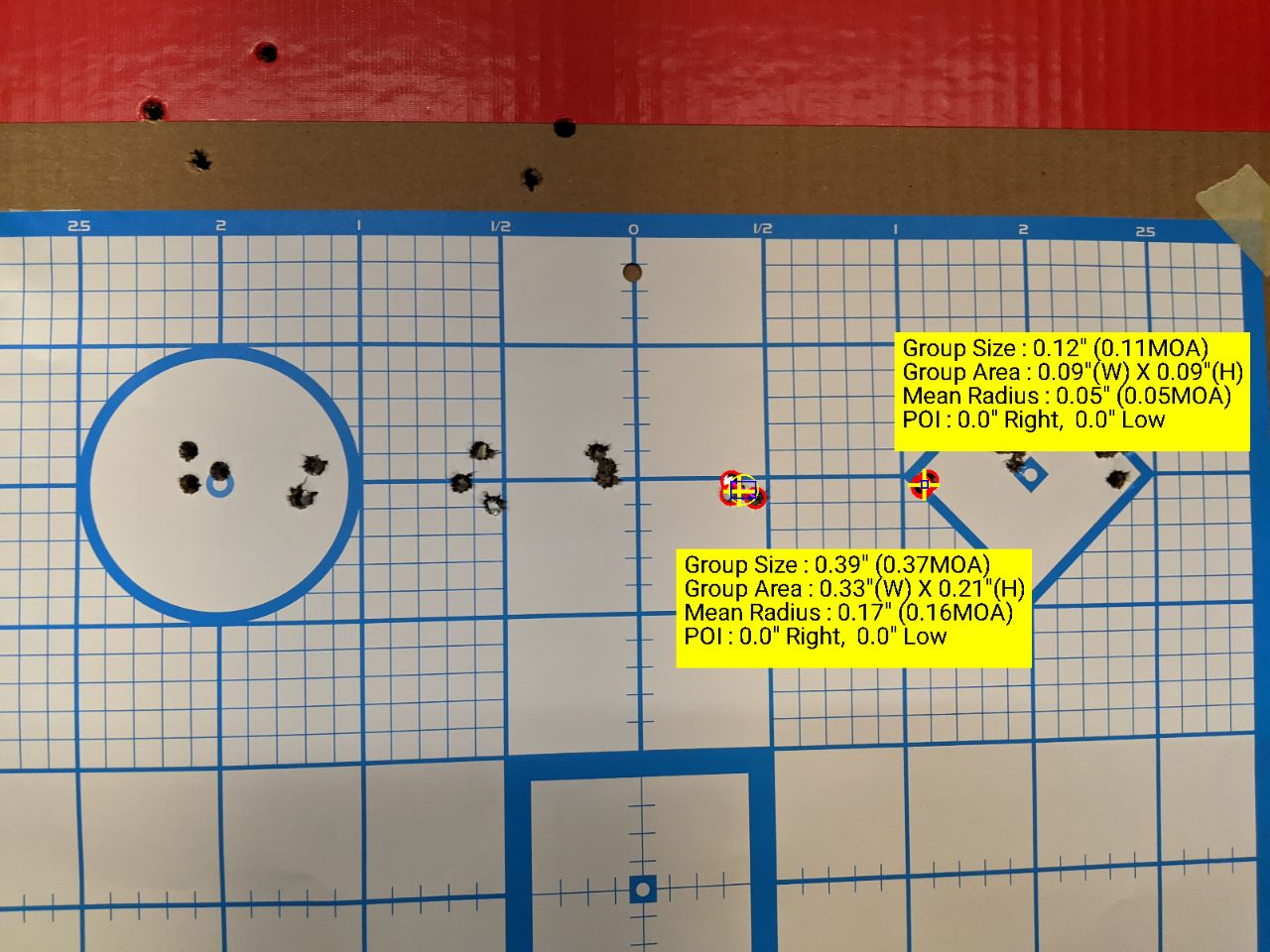

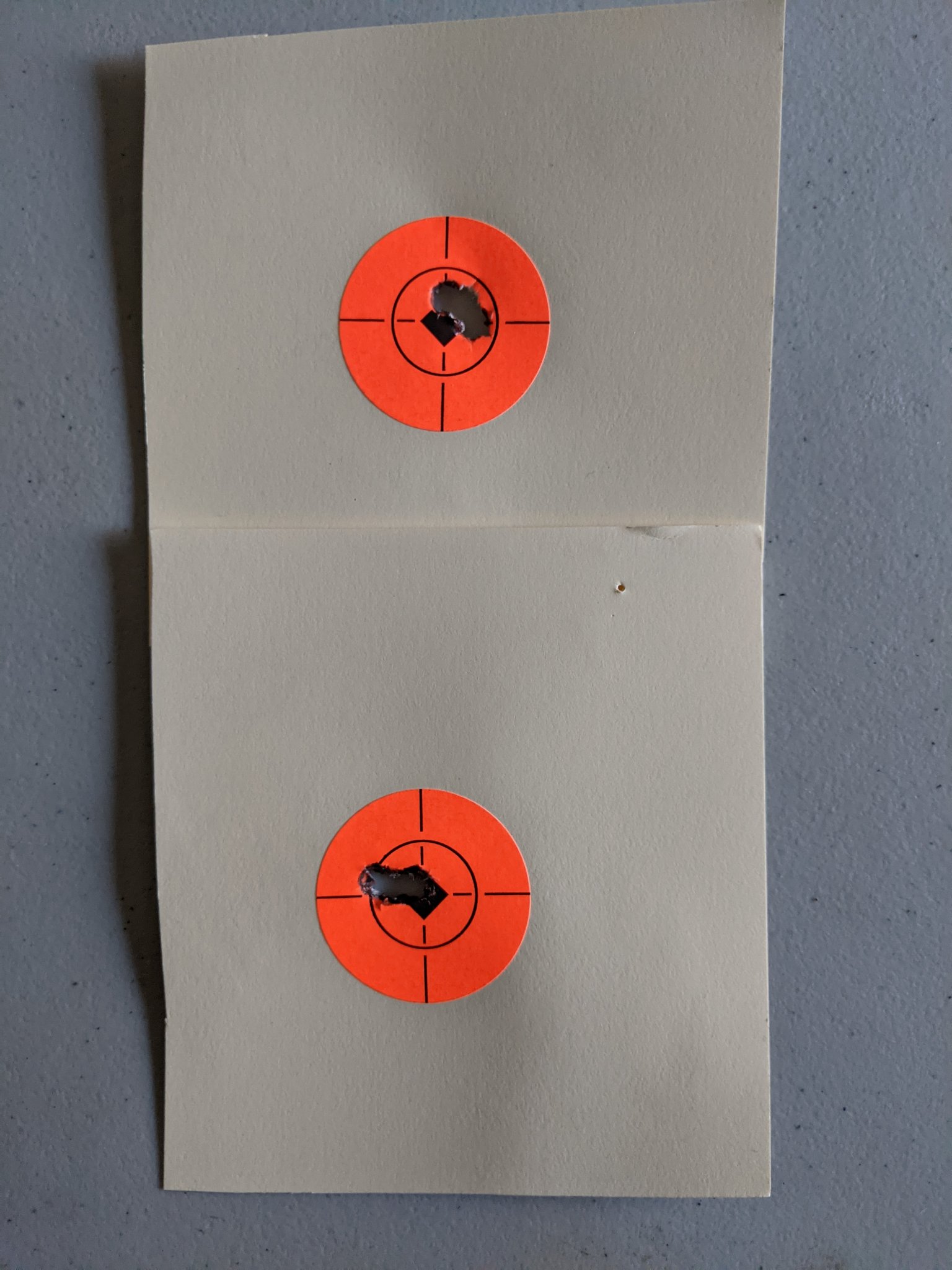

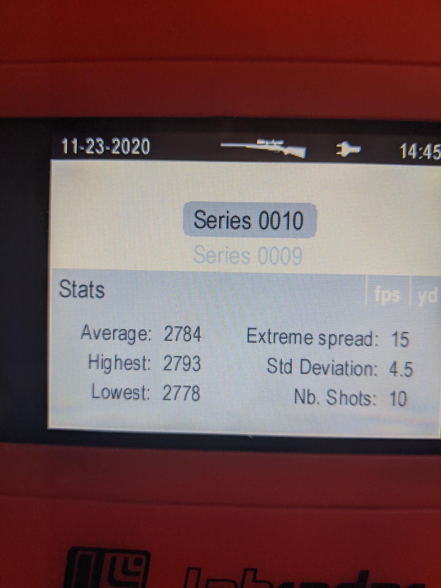

Preece Precision chambered a 26" Krieger M24 for my Tikka. I am not going to waste the barrel life by over testing. This is the 6th barrel I have started up. I just started with what worked for all the others:
144 Berger
41.5 gr H4350
Lapua case
CCI450

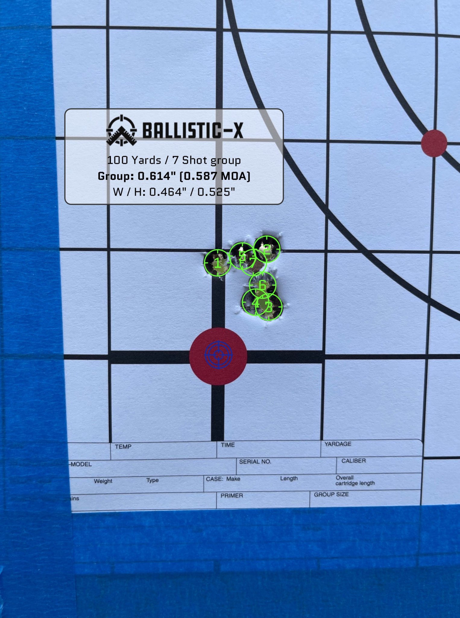

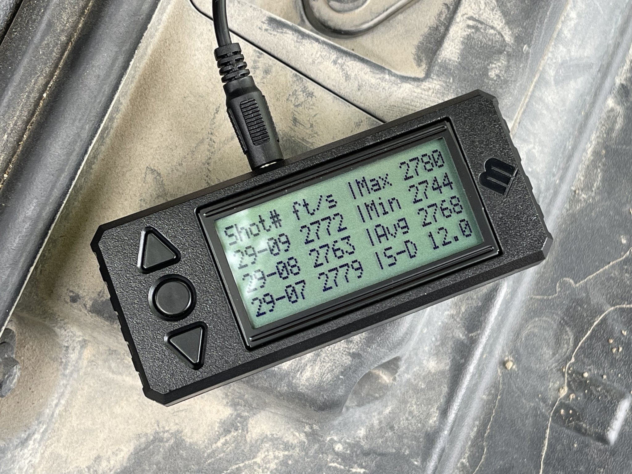

Reviving again for some chronograph and accuracy data
Rifle is an AI AT w/ 24” Proof SS barrel and Otter Creek Hydrogen L
Ammo is Berger factory 144gr LRHT
This is going to be the main load for this gun for a while, I’m sure of that.
