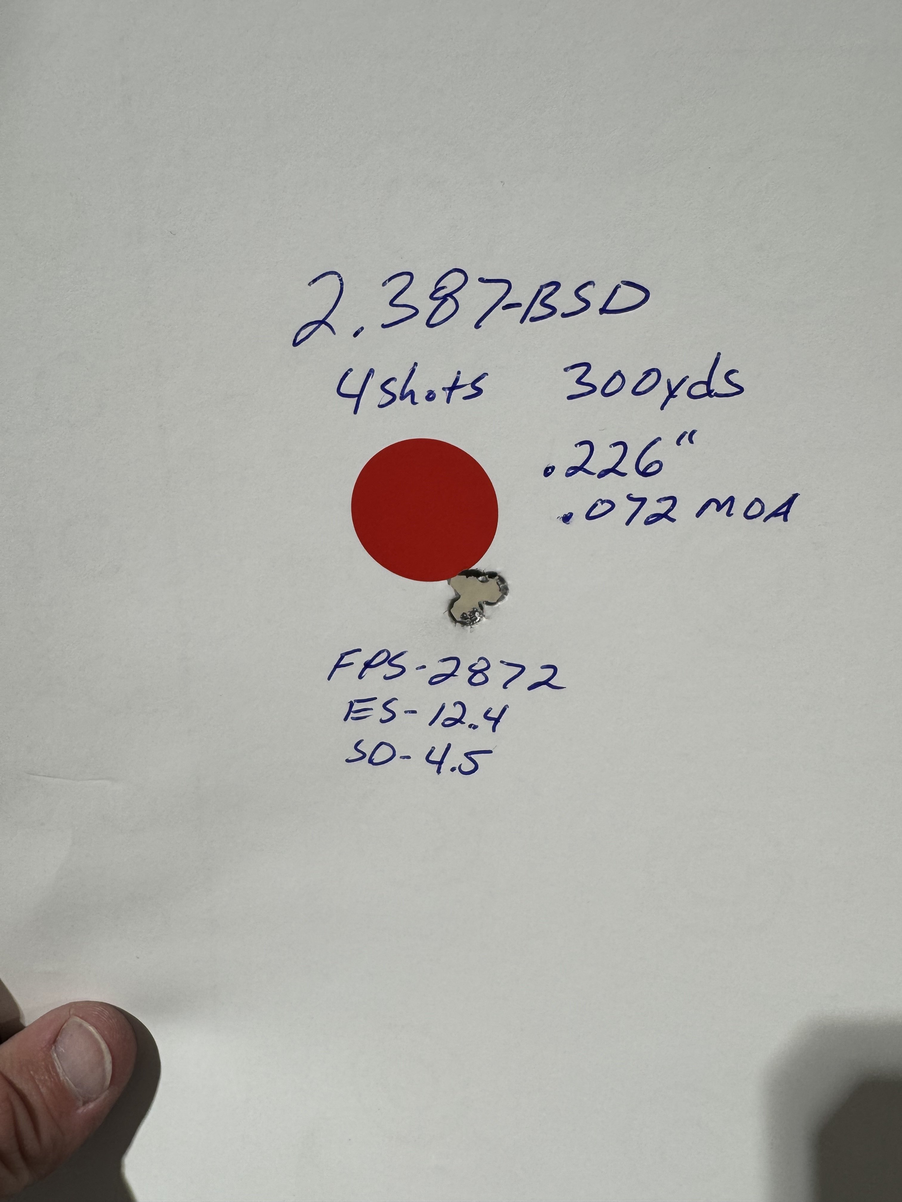

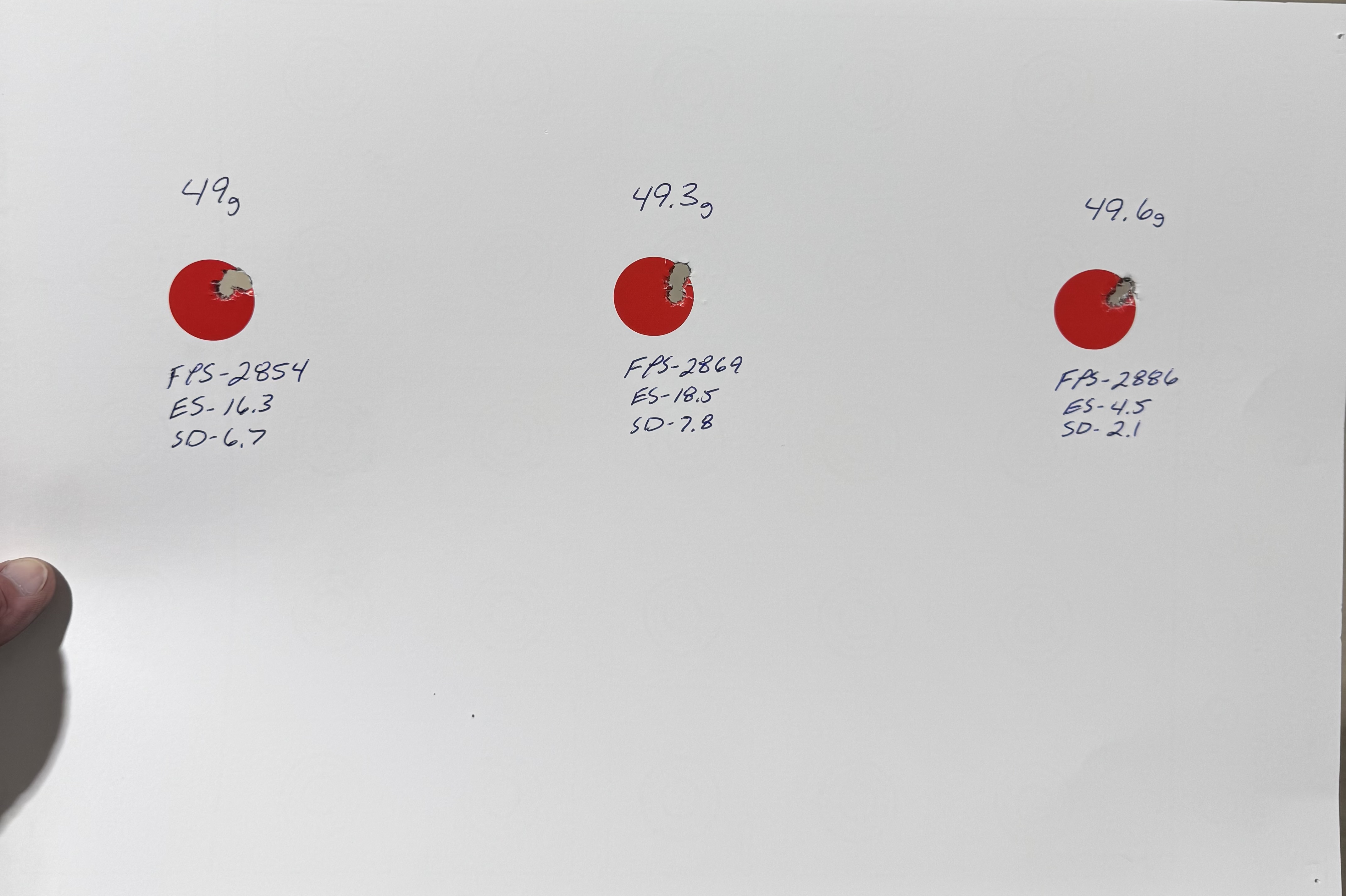

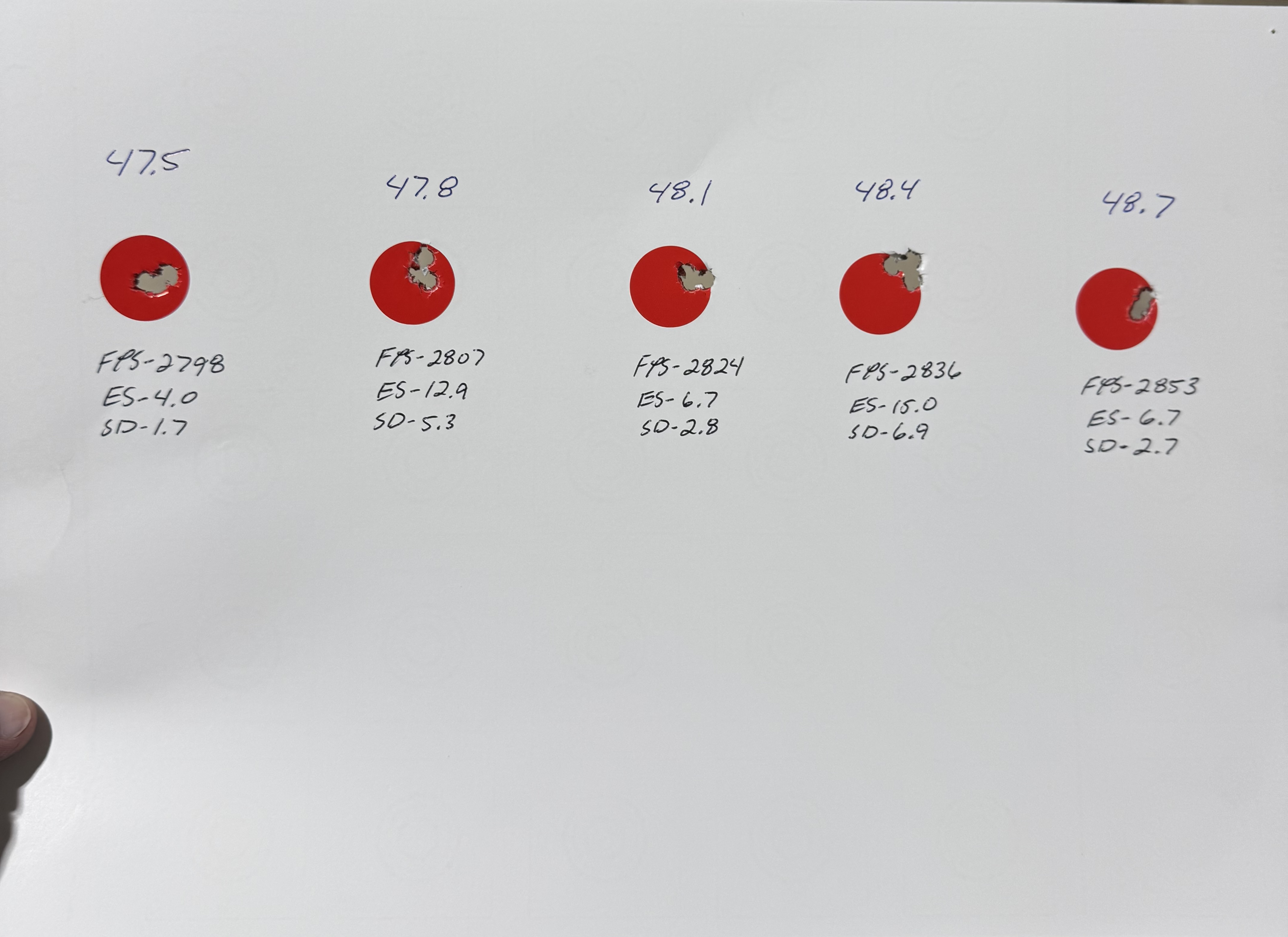

I got some Berger 153.5 in the other day to try out in my 6.5x284 shehane bench rifle. Figured it would be a good candidate with that BC behind that cartridge. Just did a ladder charge 3 shot groups at 100yds to check my speeds with V555. Seated it .010 off the lans and I was surprised. Next step is to check groups at 300-400yds but has anyone else experienced this bullet to be that forgiving? Didn’t matter what charge I had behind it. It just shot.

I've found that the 153.5 has worked really well in my 6.5 PRC with N565. My experience is YES, they're pretty forgiving. :giggle:
