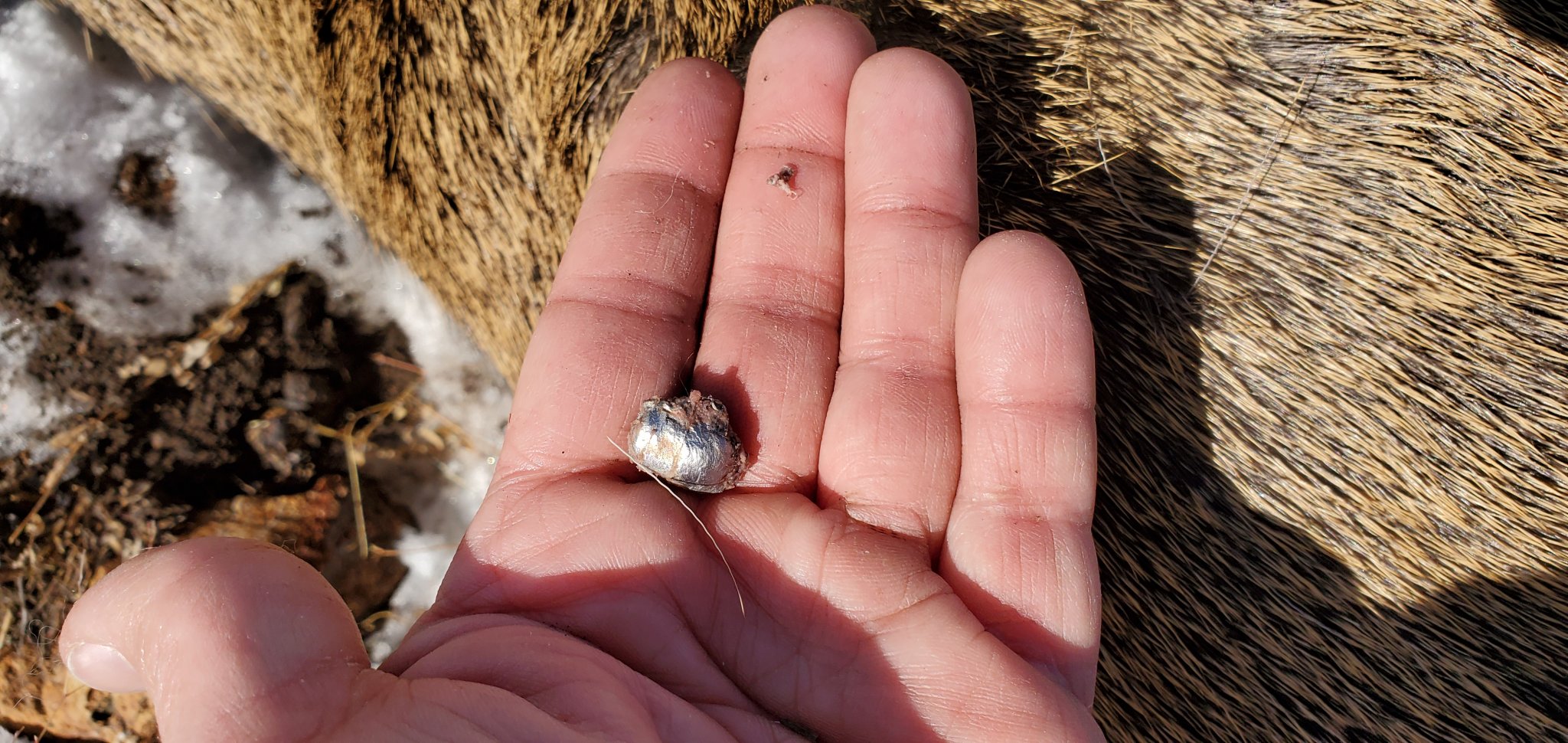

Ok I'll be the party spoiler and share my recent experiences with Bergers.
First I'll start by sharing that I've killed three bulls with 147 ELDM's from 300 to 940 yards, and I've been a big Berger fan for a decade.
Not anymore... I'm done with all thin jacketed LR bullets for elk.
I shot my bull this season at 680 with a 215 Berger, first shot was quartering away and the bullet blew apart on impact with the ribs.
The bull started moving off and I sent a quick shot through the center of his neck, which pencilled through.
Third shot was center lung and performed well.
Another guy I met shot a bull in the shoulder (while I was there) with a 300 Berger from his 338 LM improved at 775 yards.
It blew up on impact and he tracked him for two days before getting him.
A few weeks ago my buddy put a 225 eldm dead center on an elk shoulder at 700 yards, completely splattered.
These hits should have been lethal
Im not sharing this to bash Berger's or elds, I just want people to know what will happen when these bullets hit bone, or fail to expand from a closed tip.
Here's a few pics
225 eldm failure.
215 Berger exit wound non expansion
For the Record, the 215gr Berger Hybrid Target is not one of their hunting bullets, neither are the ELD-M from Hornady.
What was your impact velocity?
Reactions: Tokay444
Yes that's a really good point about them not being the hunting line, I used the 215 because pretty much everyone recommended it.
I was aware that the elds were explosive at high velocity but I figured for sure a 225 would blow through a shoulder at 700 yards (impact velocity was 2060).
I was even more disturbed to see a 300 Berger blow apart on a shoulder at 775 yards, I think the guys velocity was 2950 at the muzzle.
My 215's we're 2130 at impact
Here's a few pics
225 eldm failure.
