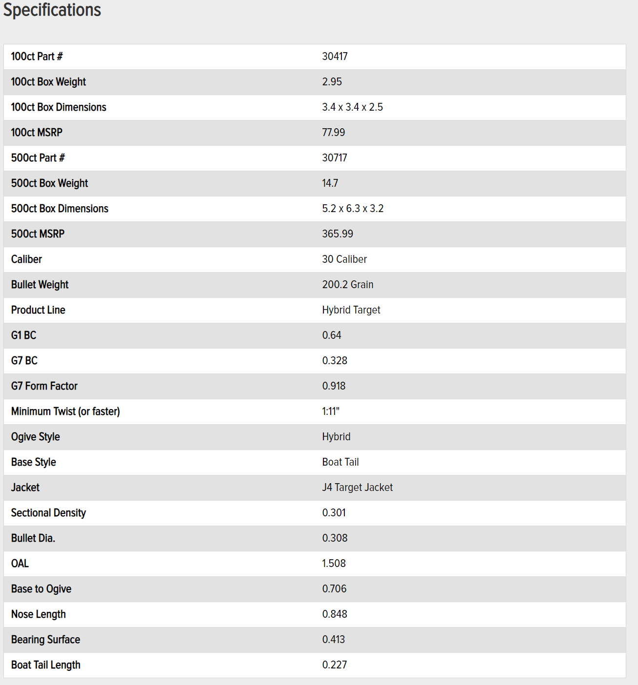

Roger, I've had a few people tell me to try those out as well, I was just concerned because I was sure if 1:10 Twist was fast enough to spin those suckers to maximize the (BC) at distance. Would want to take it out to 1 mile, & nothing beyond that.

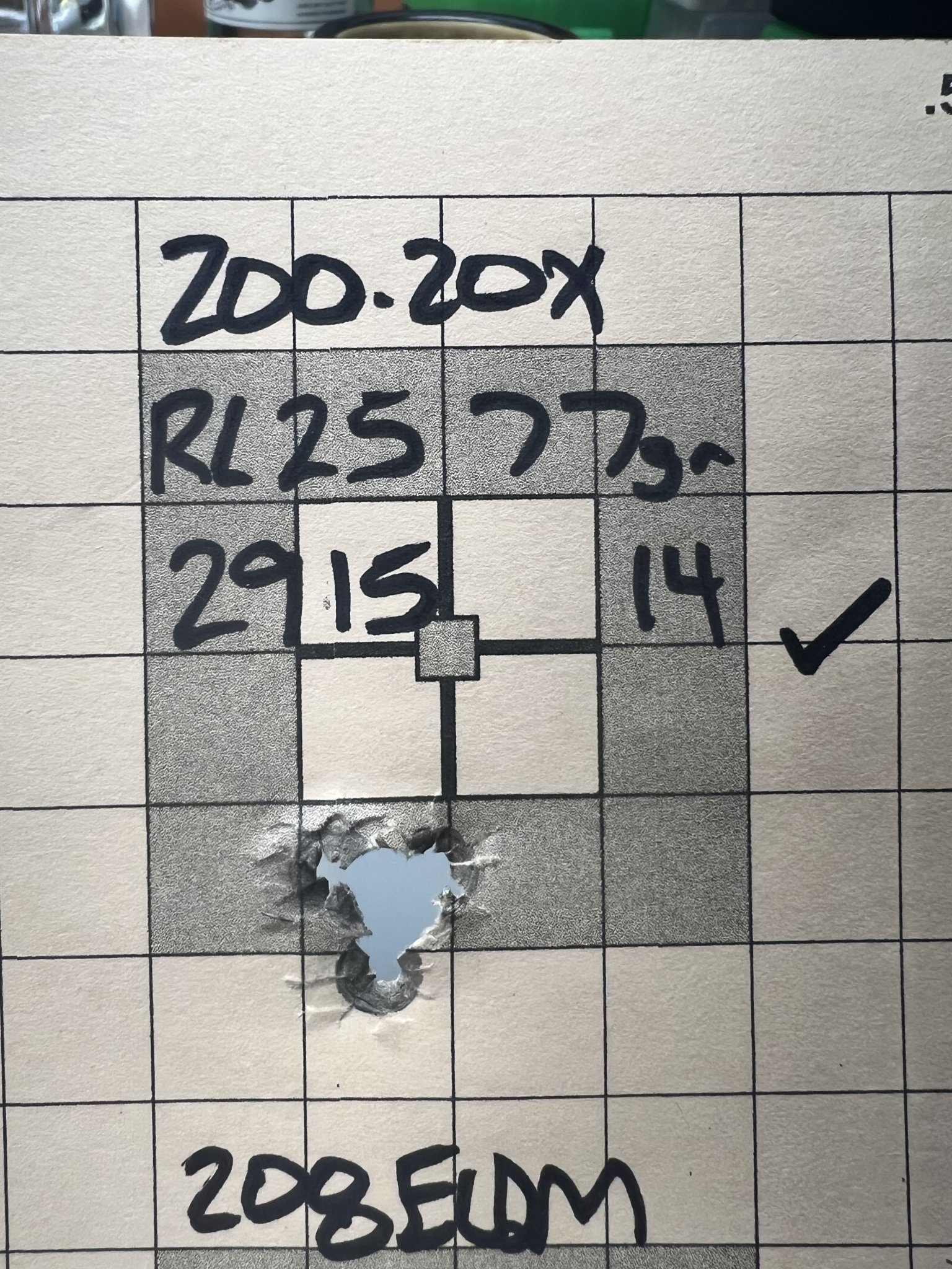

The 24" barrel I am shooting now used to be a 30" barrel. At 30" it shot a 208gr ELDM @3060fps. This was my 1 mile ELR load. I stopped ELR and had it cut to 24". Same 208 ELDM shot 2930fps in the 24" version. 130fps difference in 6" barrel loss, I didn't think terrible. The 200.20X Berger outshoots the the 208 ELDM in the 24" barrel with only 15fps difference.
Savage 110 Elite Precision 1/10T.
Yep! I believe it!
Speed, your appropriate twist, & when you do your part I bet it does!

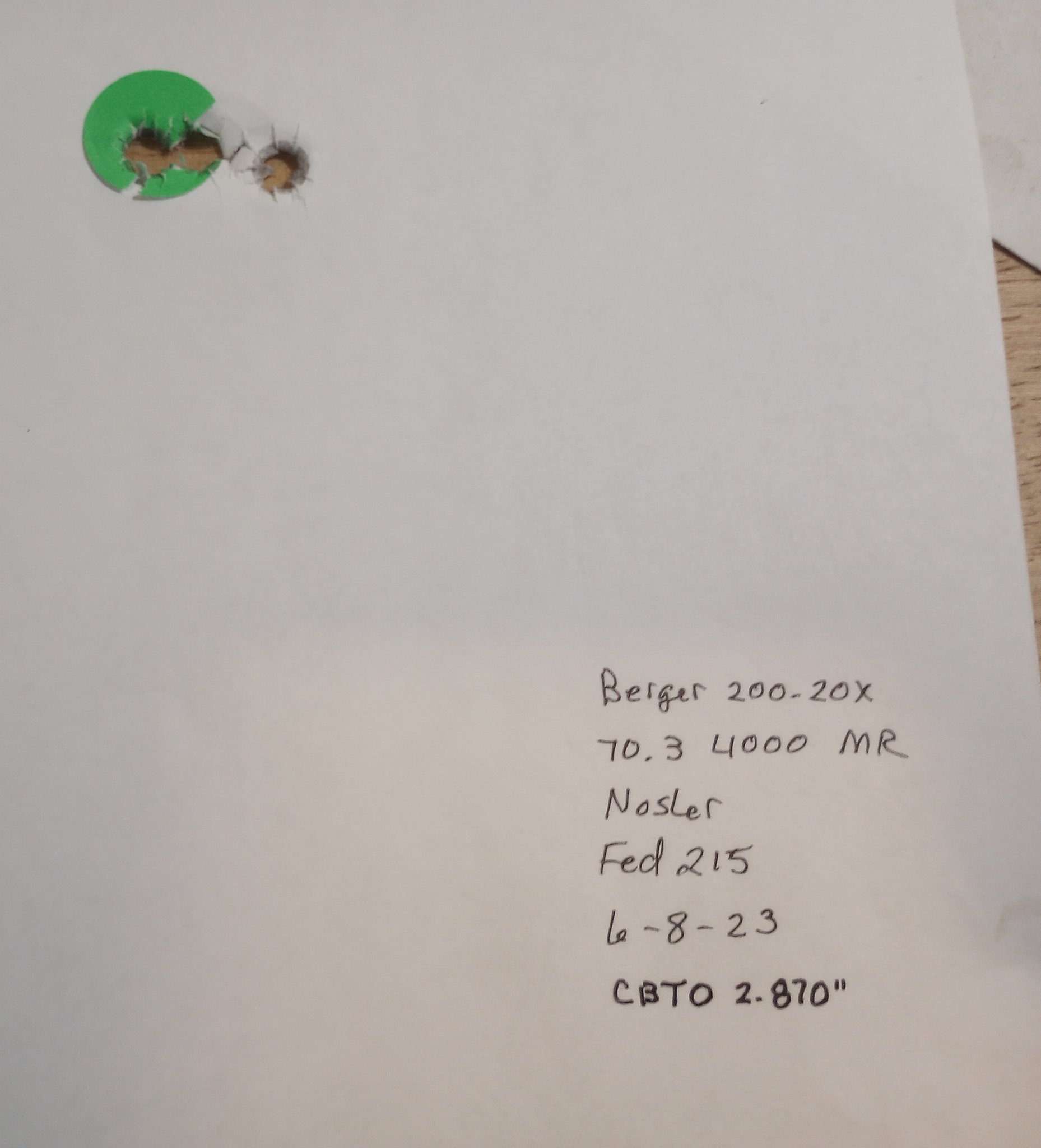

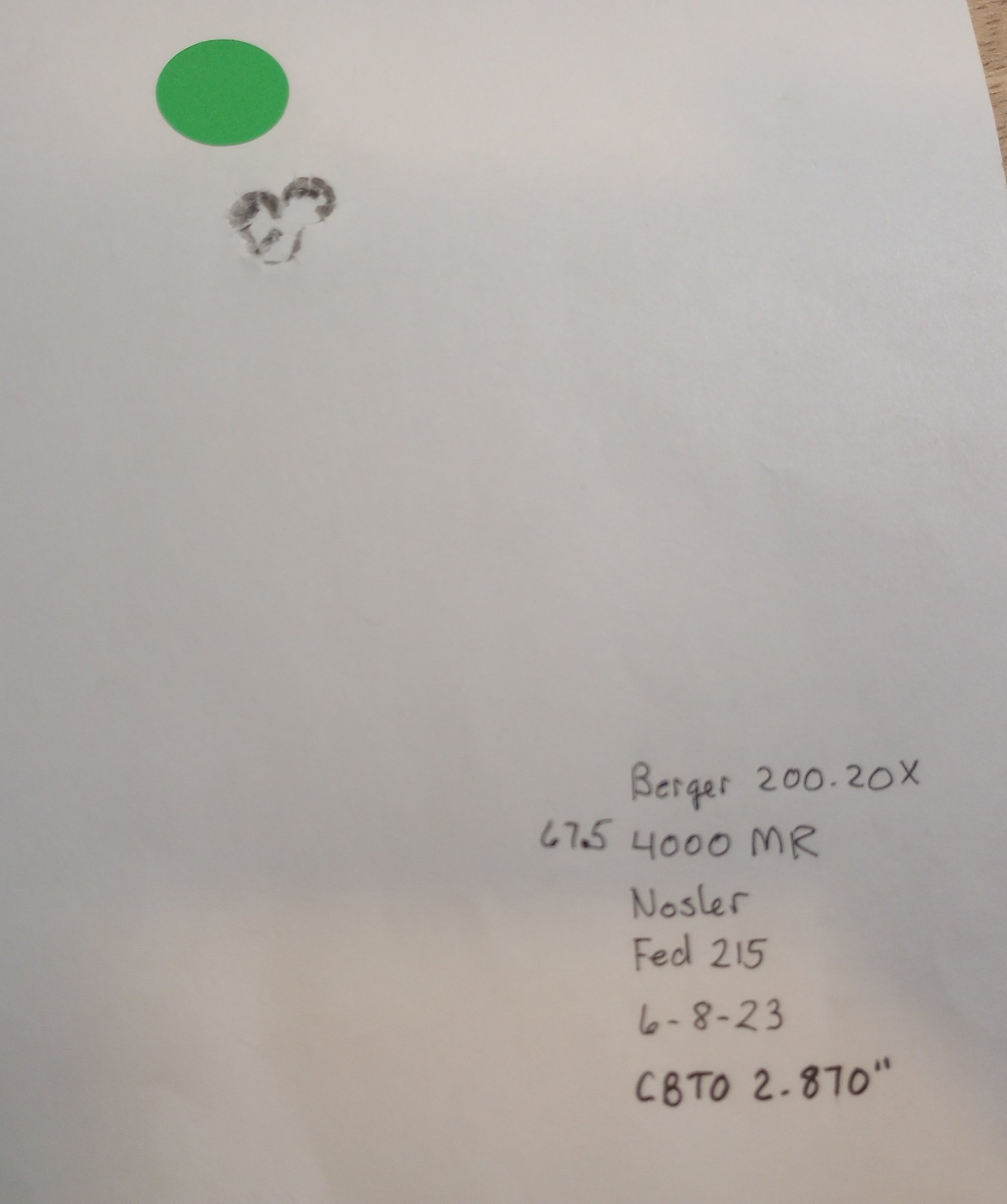

Those groups were from a lot of bullets a friend gave me... They had been sitting on his shelf for several years by the looks of them.
He had also pointed them. Not real sure why but the pointed bullets never shot quite as tight as the non-pointed ones.
There's also a better than average chance that the flier on the right of the 70.3 gr group was entirely my doing.
Mike
Mike
That definitely a possibility, you definitely have a good node for that rifle with this bullet!
