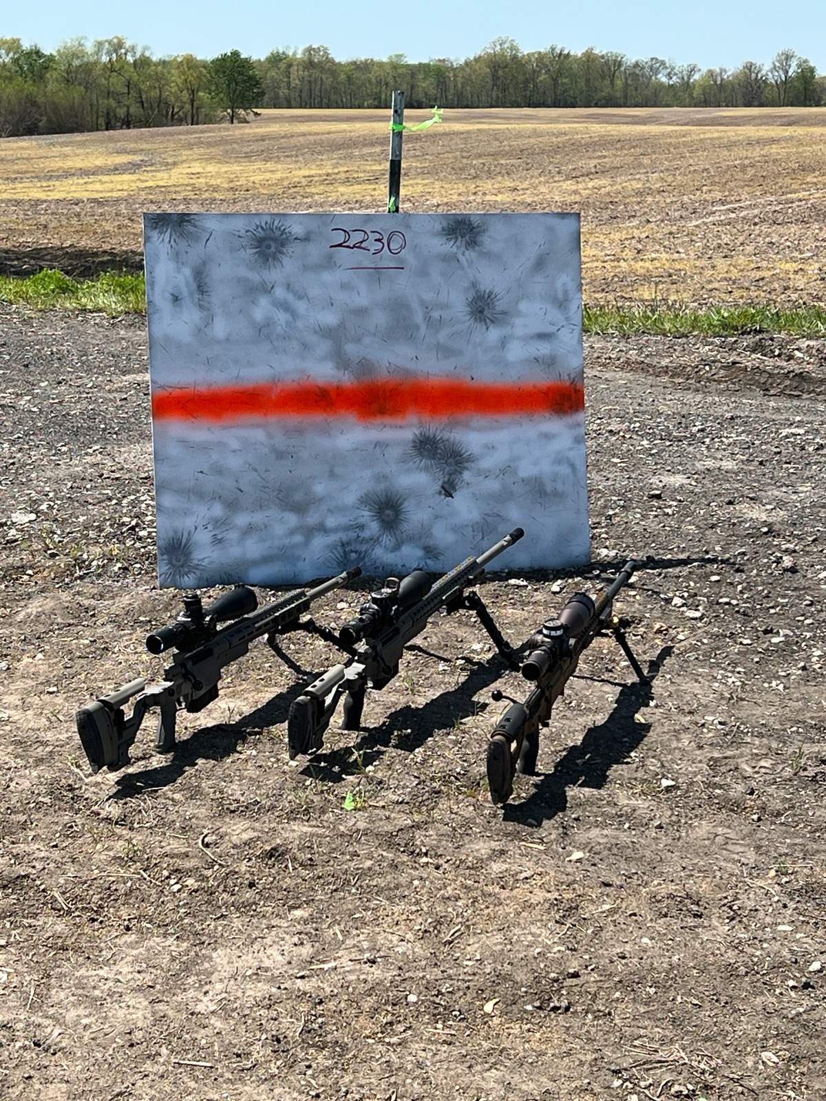

    This was 3 rifles and 4 shooters today in some stupid headwind that was switching and gusting, but the 245s did great out to 2230 yards. All 3 were shooting 86.7gr n570.
    The 245s were still denting the 3/16" AR400 plate at 1535 yards!!!
