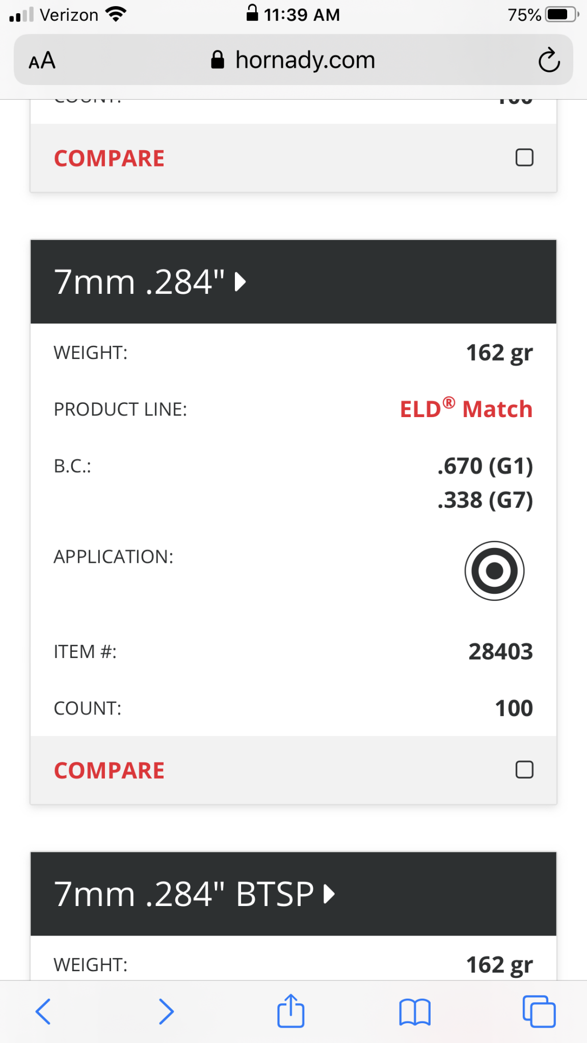

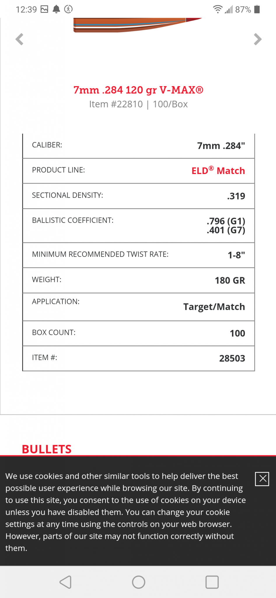

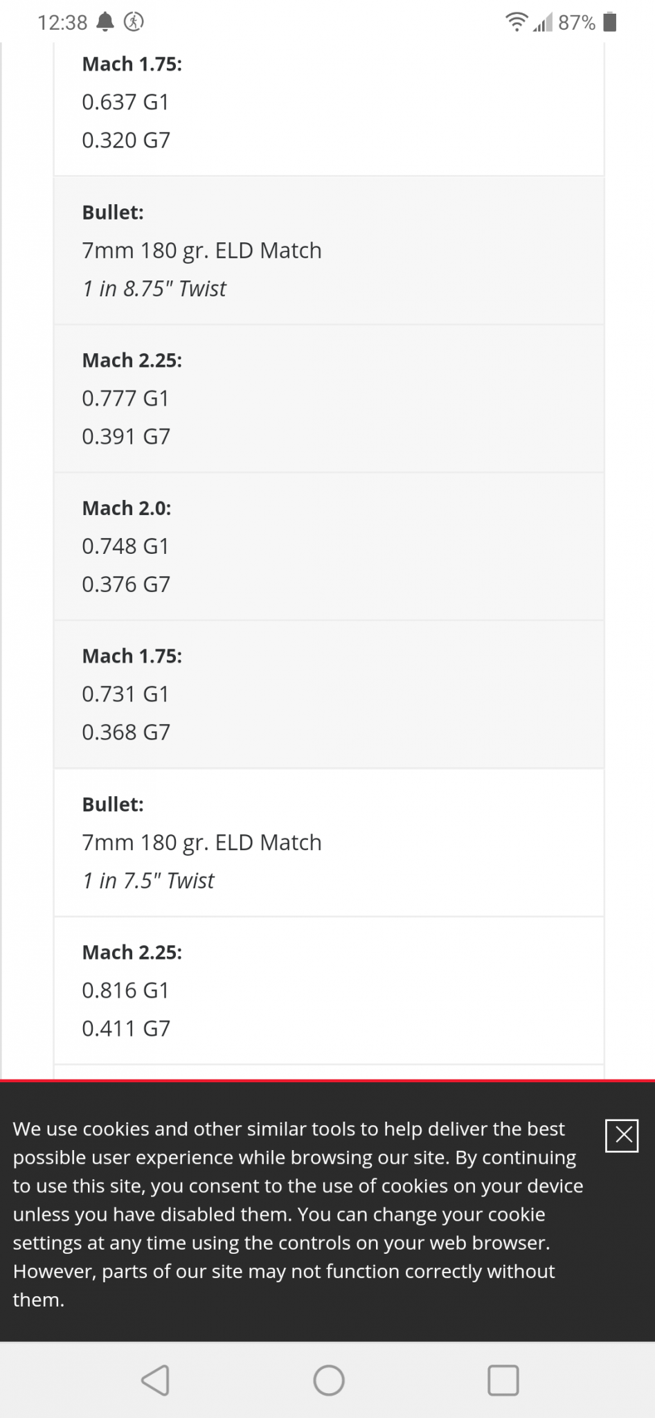

Do you guys think it is because of the 1 in 8 twist in the barrels
Certainly doesn’t help.
Hornandy lists BC data for a 7.75 twist so I thought I’d be GTG.

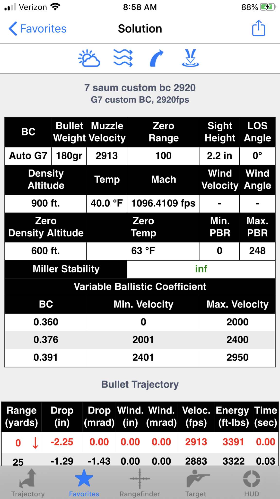

Do you have to adjust the bc on berger at the farther distances like the eldm?
Yes but I think a bit less.
.376 is close.
I think I’m gonna do a two stage BC to get it perfect.
This is what worked with my old lot of R26 with eldm’s at 2920.
It was a smidge off now that new powder is at 2955.
I’m going to back that load down to 2920
Reactions: jackdesert
.376 is close.

I shot the 180 eld m for 4 or 5 months from 100 to 1760 and found the bc on for me at 5400 elevation
So you're saying .401 g7 bc is what you were seeing?
Most other people I have seen are getting good results with a .360 bc or similar. And it's very unlikely it has a higher bc than the Berger 195 EOL
I have strelok pro put that bullet in and worked great but i didnt keep it long and that was over a year ago. But also shoot 225 eldm and 147 eldm and find them dead on when i put my info in app. But ive heard alot of people say there not as high not sure if im crazy or what lol but i did see even hornady lowered the bc on website
I'm still seeing .401 on their website
It shocks me that they still expect shooters to use that bc. Not sure how they expect us to believe the bc is higher than their 225 ELD-M, which is longer and heavier for caliber than the 180.
