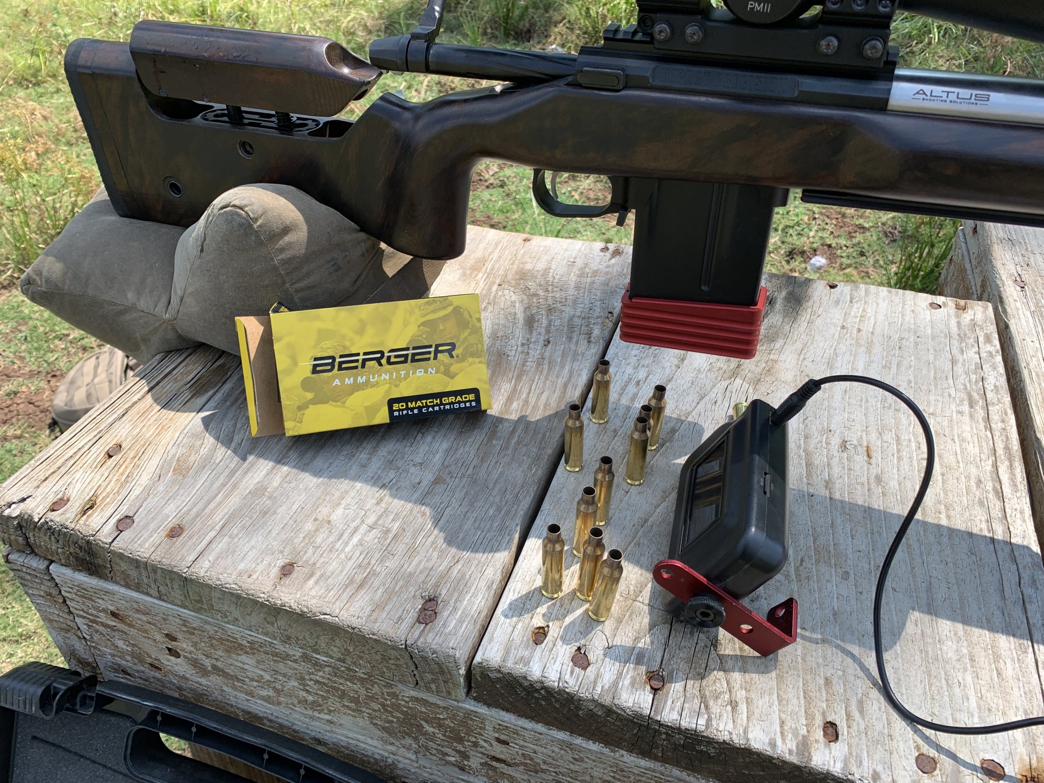

Has anybody started shooting with these. I've been using only hornady eld-m ammo for 2 years and somebody talked me into trying these. Hornady eld-m BC G7 was showing 0.326 on their website , there BC I thought was little high. I found G7 0.305 a little more accurate BC. I don't know if somebody has any data if Berger's BC of 0.311 on this ammo is close or correct?
I did a 7 shot chrono, 26" bartlein, Magnetospeed V3
1. 2821 fps Cold bore
2. 2817 fps
3. 2827 fps
4. 2796 fps
5. 2802 fps
6. 2798 fps
7. 2805 fps
I deleted the high and low and got 2808 Fps average with a SD 9.8

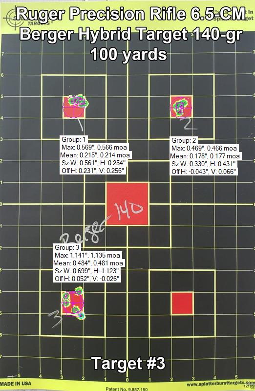

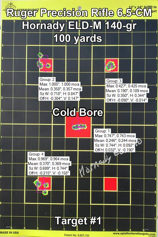

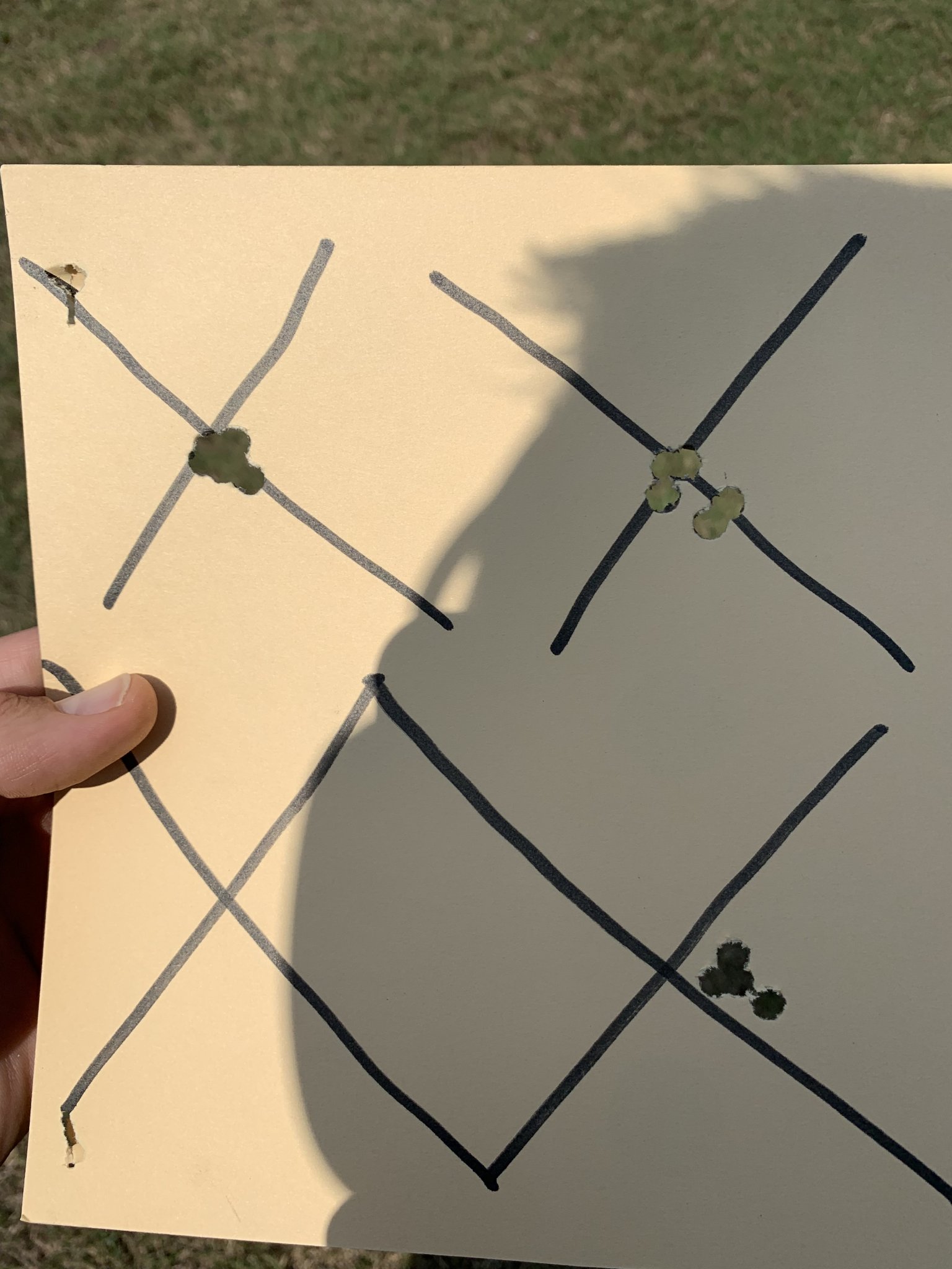

I shot some today for the first time. My RPR barrel has 2700 rounds through it, so I don't know how much that may be skewing my results.
I started out the morning with my RPR 6.5CM. I hadn't shot it since June!
I wanted to try some new ammo (as mentioned a few comments back). Last night I gave the barrel a good cleaning (long overdue). So, I started with some Hornady ELD-M 140-gr to foul the barrel and confirm zero. Check out Group 3 on the top right! Dayumm!! I've still got it, and apparently so does the barrel after 2700 rounds. All groups are 5-shot groups.

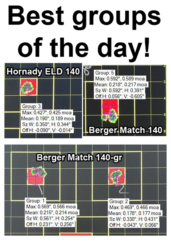

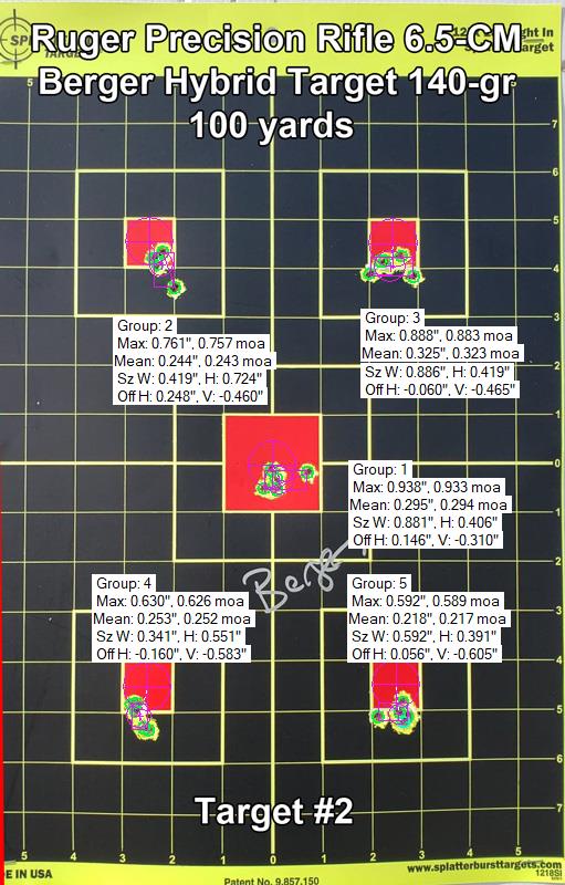

Then I switched to the new Berger Match Grade Hybrid 140-gr ammo. OK... pretty good! Some shots I knew I pulled. But, still pretty decent.
I adjusted the elevation up 1/2-MOA for the 2nd Berger target (Target #3 below). I fell apart on Group 3 at the bottom left. That was the last group. It was hot, and I was DONE. :)
But, is the Berger ammo BETTER? It's 16-cents a round more. Hornady is $1.18 / rd. Berger is $1.34 / rd.
But, the Berger also comes with Lapua brass.
OK... forgetting about the difference in cost, is the Berger a better performer?
Average group size (over four groups) for Hornady ELD-M was 0.783-MOA.
Average (over eight groups) for Berger was 0.744-MOA... if I include that last sucky group... I was hot and tired.
If I exclude that last sucky group (and use seven groups), the average group size for the Berger is 0.590-MOA 0.688-MOA. $hit... that's pretty damned good, I'd say. Plus I get the value of the Lapua brass, which I saved, of course. :)
I'll post up the chrono data momentarily. Still gotta download it.
