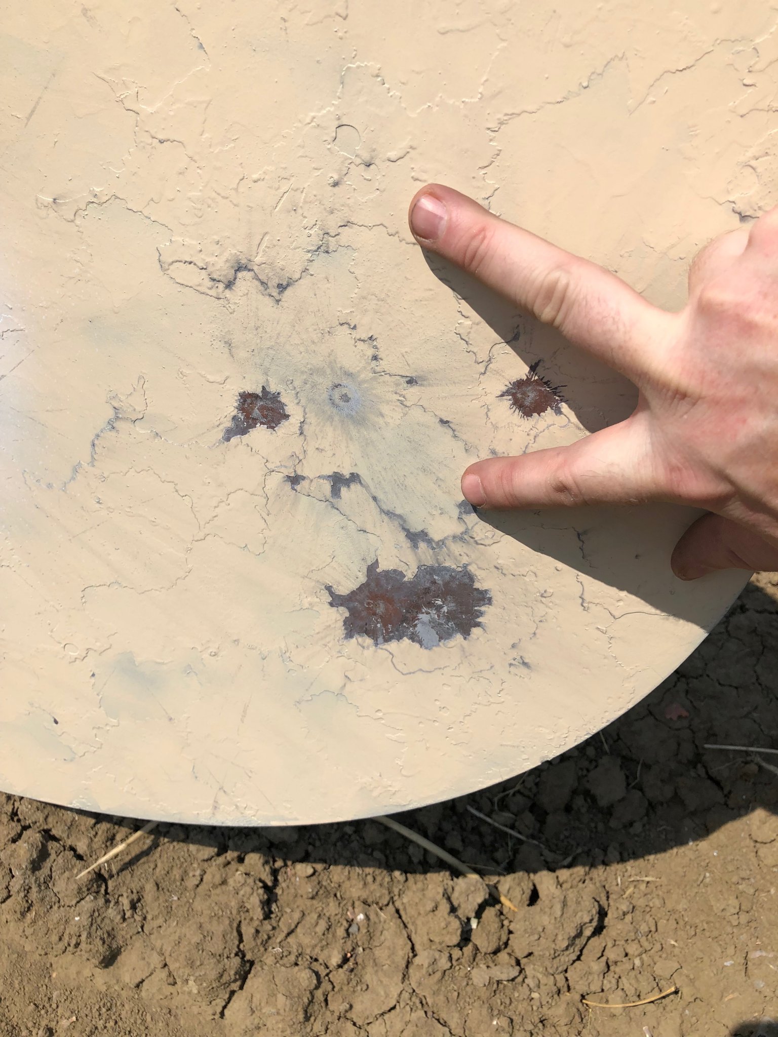

Look at these two flyers that I shot this weekend on an 8-shot string of Berger 105 Hybrids! They are easily 3" from the main group!
850 yards... during load development...
Horrible, just horrible ;)
