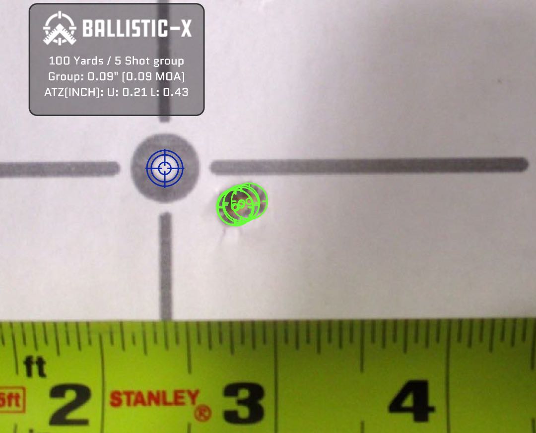

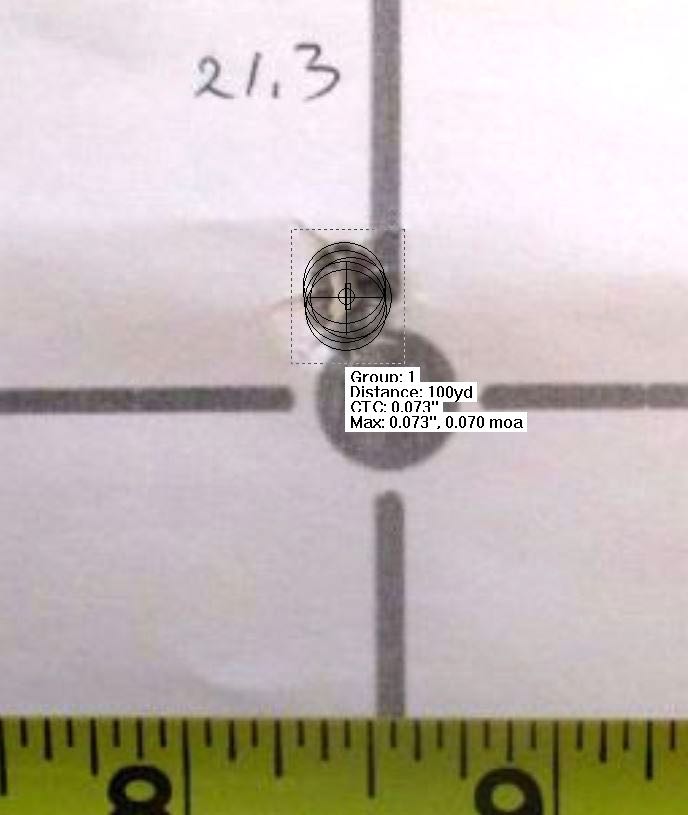

    I'm a novice at reloading since I just started last summer and I was just shooting .223 ARs. A month or so ago, I put a bolt action .223 together with a Savage target action and a Shilen 1 in 7 twist barrel together which the shop had in stock while waiting for a couple of slower twist barrels to be made. I was using LC brass at first since I had a bunch of it for my ARs but switched to Lapua to see what difference it would make. I really haven't noticed any significant difference.
    Here's my best 5 shot group at 100 yards so far with Berger 77 OTM and LC brass:
    And the best with Lapua brass and 77 OTMs:
    Any noticeable difference in standard deviation or extreme spread?
    Good Lord thats unbelievably good. Yeah I would say at that point what difference does it make?
